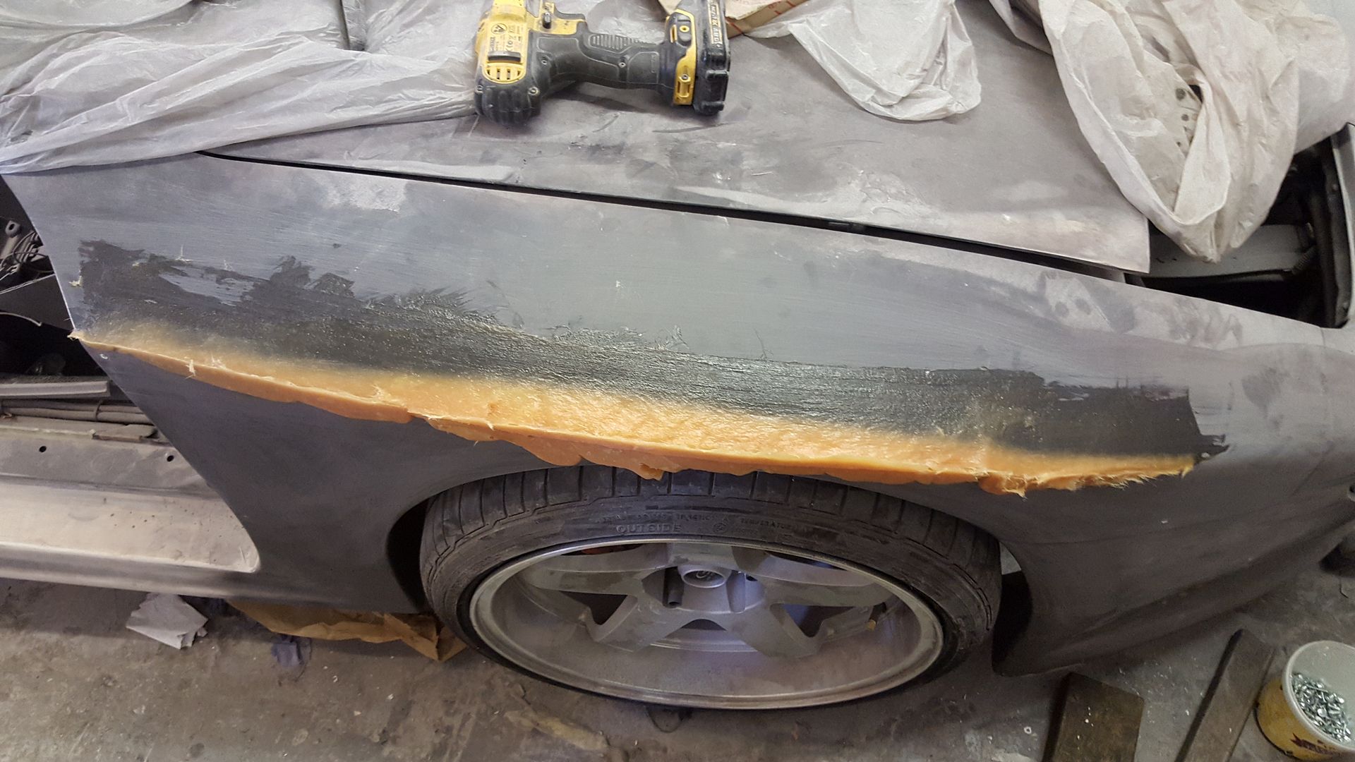

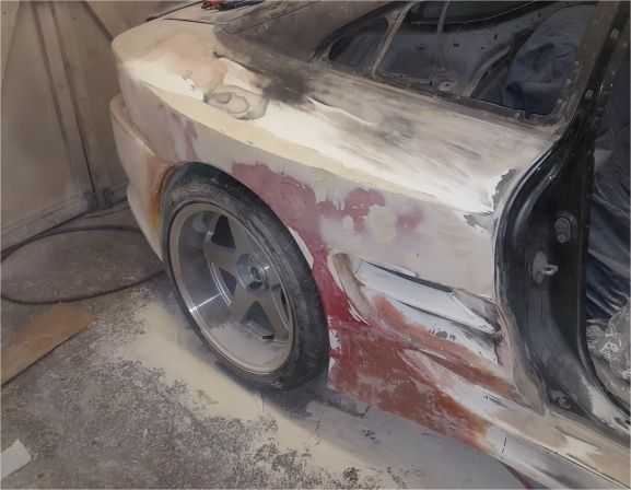

Ok so I grabbed a cheeky day on the car to make a start on extending the widebody to cover the 12j rims.
The initial plan was to cut and extend the entire quarter and blend it back in, however it had more chance of compromising the overall rigidity doing it that way, so I decided to leave the original structure in place.
I started by grafting the vent area from a Bomex sideskirt
(fibreglass rather than some plastic composite Toyota use) into the original TRD vent area, this gave me my starting lines and coverage on the front edge of the tyre.
From that I temporarily used some 3mm ply that curved really nicely from the vent over to the rear bumper, this was aligned 10mm from the planned finished surface.
10mm of P40 was then laid up over that area to give it structure and a basic shape.
After several hours of basic body profiling the new extended quarter shape has started to emerge and final shaping using Upol
"Fantastic" has started, which is 2-3mm thick at its deepest point.
It is going to take several weeks per corner to get the final shape right, but very happy with it so far.
As you can see the wing top edge is very sharp right now, that is just a result of the body file meeting at two faces and allows me to get the downslope and front face contours perfect.
The final wing edge will be rounded off like the original TRD is, although I do like the pin sharp edge I can't bring myself to leave it like that.
You can see in the pic below how the sideskirt now has a nice flick out which starts near the door post, and I've also decided not to extend the original vent centre bar, it looks better inboard and makes the vent look deeper
(which of course it is).

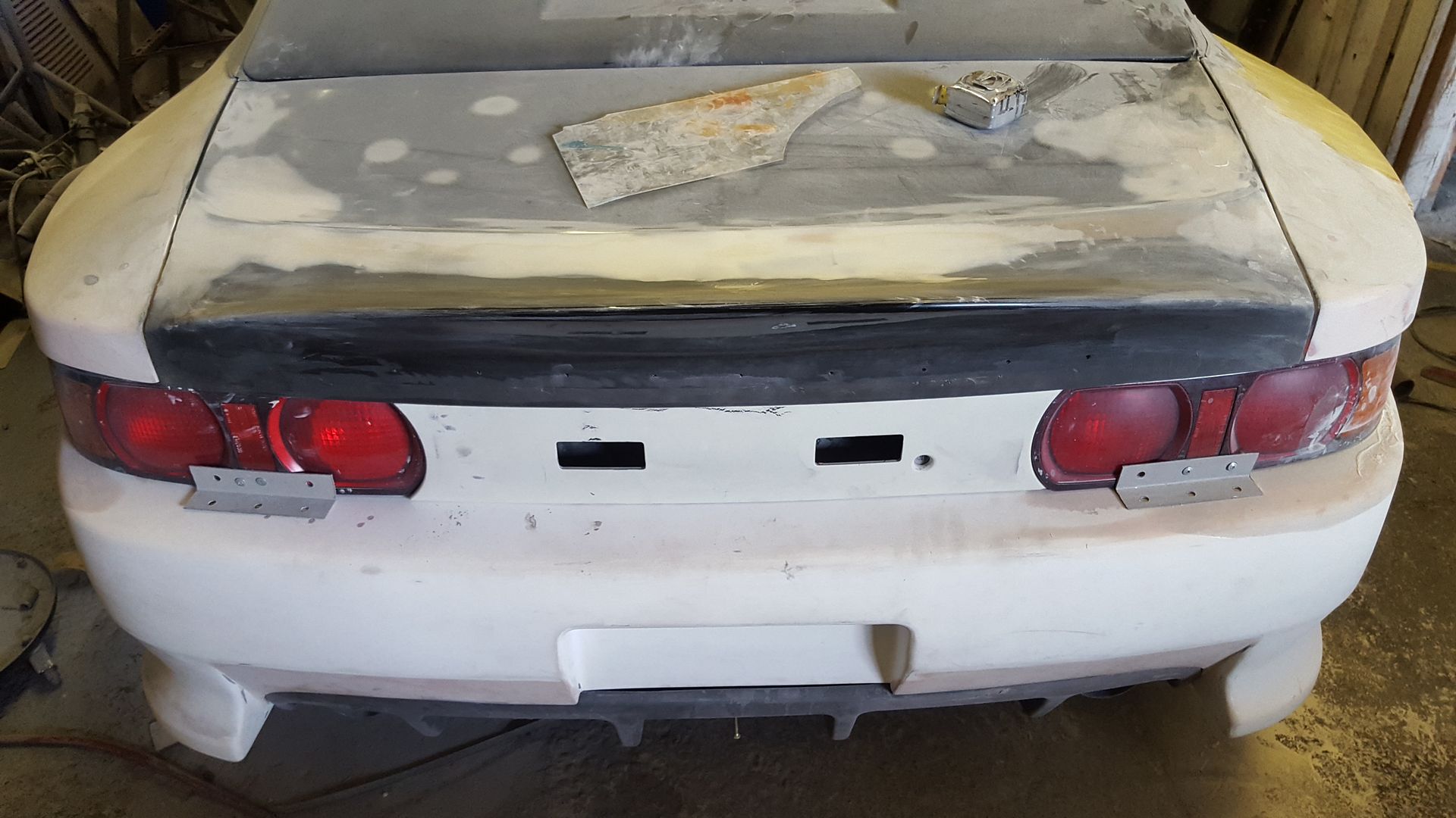

From the rear you can now see the added width on the right, you might remember from last year the lights have already been moved outboard and new wider centre panel made, the light recesses will not need to be redone as part of the widebody extending.
You can also see I have started to make the new ducktail design, my previous Autopista design was too over fussy in the end, I want a more exotic, cleaner look.
The ducktail has been bonded and temporarily screwed for now, but will be totally flush blended into the extended TRD boot, this also means I can change designs/spoiler in future without it affecting the rest of the car.
For me this new design works much better with the F40 lid and ties in nicely with the rear diffuser.
The F40 lid is going to get the lowest centre vent altered, that will incorporate a brake light unit but not as wide as it is now, the lid also needs a complete frame, rain channel and rain trays making for it along with being hinged and gas struts added.
The TRD rear bumper lower
"swages" have also bothered me, in fact I really don't like the design there
(the scalloped out bits either side of the diffuser)
, I think those areas would look much better blended out with maybe just a small swage left at the bottom, undecided on that one for now.

Some more time spent on the new duck tail design, this works perfectly for me from a styling point of view.
Still an awful lot to do of course.

So we got the final version of the extended quarter panel shape done and mocked up the top edge shape, it looks pretty good.
Exactly 25mm wider than a regular TRD.
The TRD duck tail is now finished.
Work has started on extending the front wings which will have a curved profile rather than the TRD slab sided styling, so yeah it's totally bespoke now.
Lots still to do, I've also down sized the tyres from 335 to 315 on the rear, which has sorted the profile out.
