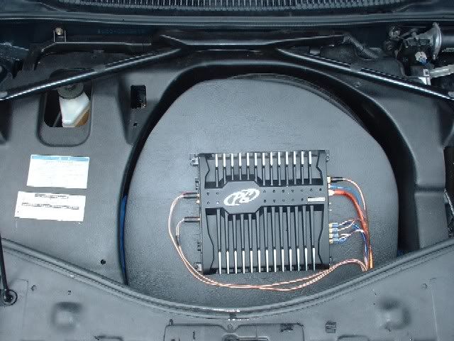

ok here goes:
2 pics of the amp under the front bonnet. I've mounted it to some MDF, but haven't finished off securing it in position yet - a case of function over form until I get some spare time.

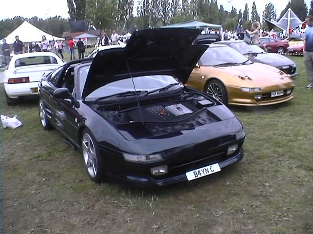

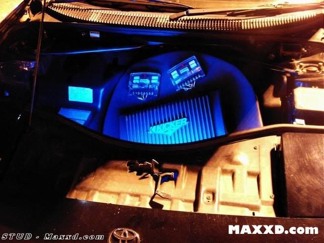

*pulls archived pictures from nowhere!*
Here she was two years ago ...
Two Amps on a Hinge Mechanism (Spare wheel accessible) .. not sure if she it still exists!!! :(
c

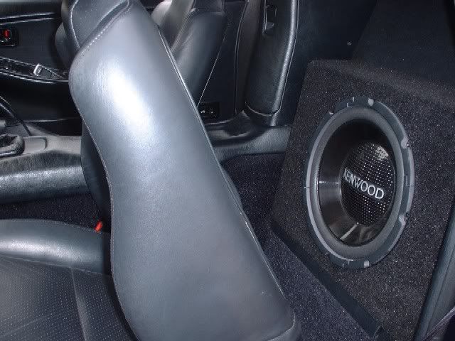

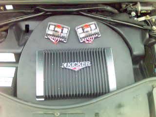

Mine is as follows:
Amp Rack
Sub
12" Kenwood sub which is neatly behind passenger seat allowing the seat to recline back ok. Sealed unit. nice sound. And the amp is 4 channel pheonix gold Tantrum series, 2 channels bridged to run the sub and the other 2 running my front components which have their own Xover in the doors, Mac Audios.
No wires showing, and the Headunit is a 60W 4V Alpine 3 outs.

how did you mount those amps so neatly under the bonnet. whats the secret lol

Post by cbaynes »
The MDF that the Amps are screwed to are resting on the top of the spare wheel, all the distribution boxes are screwed on the under side of it ..
The whole lot hinged forward so I could still get the spare wheel.
Thanks

cbaynes wrote:not one unmolestered MR2 left :shock:
Nah - there are one or two. They just never post any pictures! Give it another five years and we'll all forget about what a standard MR2 looks like...
Cbaynes - what did you stick your front number plate on with? Any problems from the law?

Post by cbaynes »
Nige wrote:what did you stick your front number plate on with? Any problems from the law?
Double sided Sticky pads, you can buy them off the service desk at halfords, about £1.99 if memory serves.
Never got pulled for them
