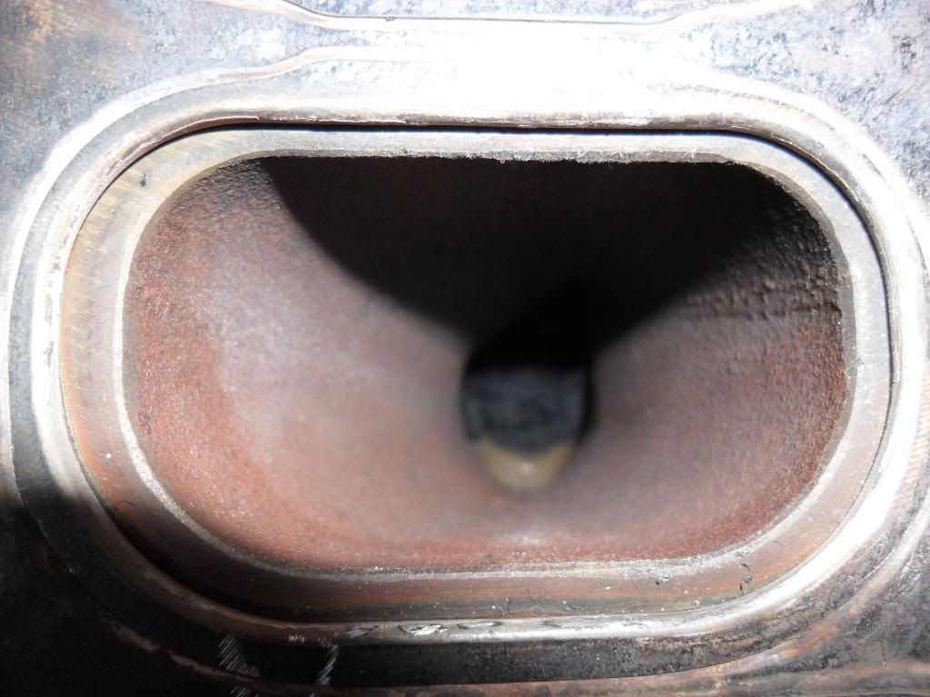

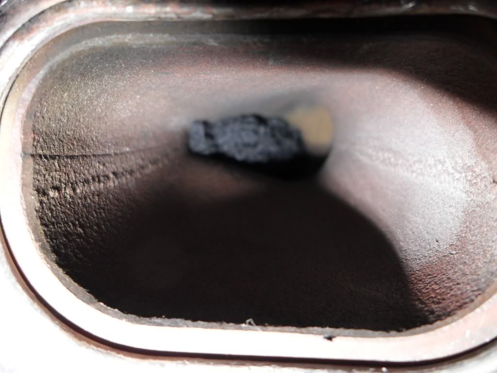

Absolutely, much better to port your turbos wastegate .. I did mine with no traning just some common sense worked great (perfect boost no creep) .. be happy to talk you through it .. I took lots of pics for reference ..
Tools needed .. dremel .. carbide cutters, sanding drums and a dremel flex shaft. (if you have a proper die grinder that would save a lot of work)
Dont kill your performance fitting a restrictor ring #-o

Few of pics ..
Did the entre ports , big as i could get them .. never had any creep low boost or high / summer or winter .. rock steady
Sold it for £300 ish .. gutted #-o
Original port sizes ...

Yeah your not wrong .. easy 14+ hours over 2 days ... after hour 2 i wished id bought a die grinder lol .. worth it though :D
I had put far to much time, effort and money in to my car to fit restrictor rings ... and or have unstable boost and poor performance ...... i was quite motivated :lol: .. did take me bl00dy ages though :cyclops:
