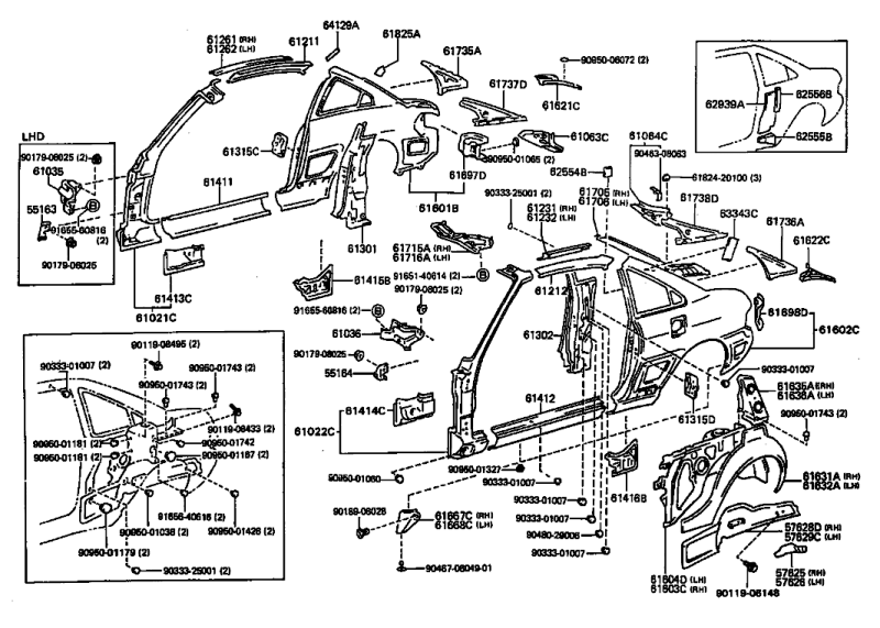

These may help you. The final pic is where i'm at now so any more pics you need just ask whilst it is still open
The bit behind the rear box is the inner arch. I was planning on putting the sill cover on first then build up the inner arch.

Thankyou that helps me out loads. Now i know what it should have looked before. Im just wondering why the centre section of the inner sill has no box section beyond the end one like most pictures of sill repair ive seen. Yours has a middle section. Is this due to different models? Or been taken out?

Not entirely sure what you mean but then I have only seen inside my sill and the couple of threads I have read with pics generally only shows the rear end. If others don't have the same reinforcement then this could be tintops or moonroof and need less bracing????
Any how this is an interesting picture
Oh and on mr2oc Olly Dent can supply sill covers of full length that he had a coach builder make. £80 plus post iirc

Just had another look at your photos (didn't realise I could see them all, previously looked at first one). I think I do have more box section than you.
I can see the inner arch apron has been botched up previously! Have you had a peek at the sides behind the rear bumper as quite a few 2's succumb to rot there to.
Having just checked the pic specs, the one I posted before was from a JDM turbo. The pics for my tbar jdm N/A is the same as that but........ below is a uk 91-93 n/a
As you can see the reinforcement box sections 61425/6 and 61423/4 are absent from this pic
Edit: ok I have looked further and jdm coupe n/a has the reinforcement so I think they are absent from uk tintop (and maybe moonroof).
