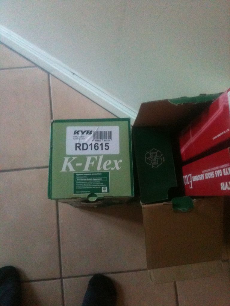

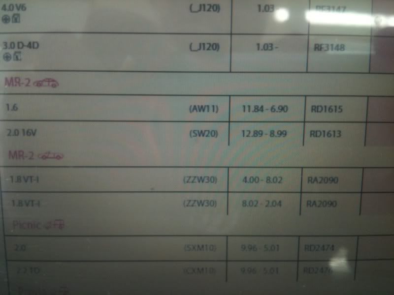

You sure the springs are for an AW11?

no theyre springs landrover discovery !

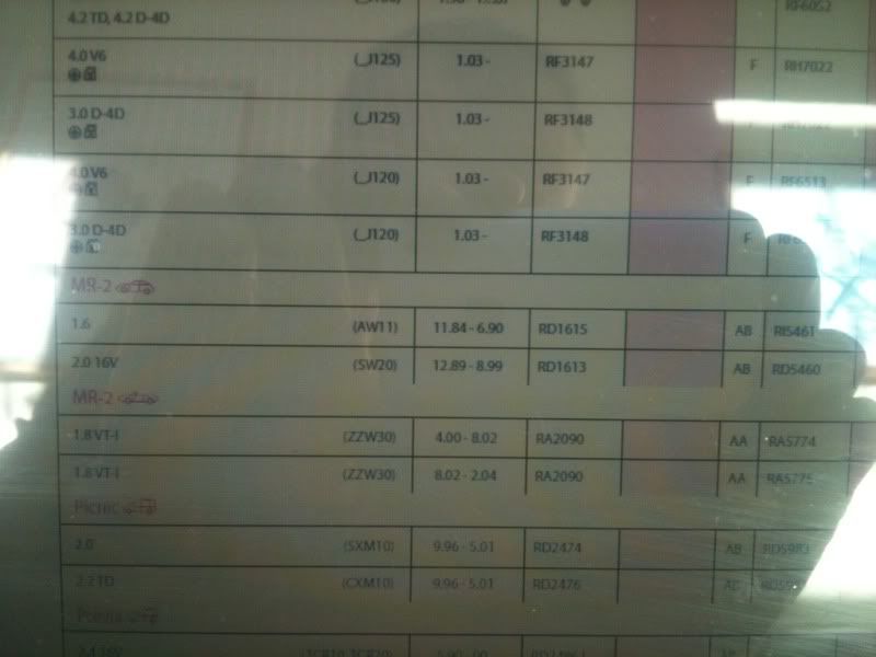

AdamP wrote:You sure the springs are for an AW11?
heres yer proof
of course theyre parts for an mr2 mk1

Adam was trying to be helpful Chris :shock:
OK the box seems to have the correct label
But it's not unknown for labels & box contents to be mismatched

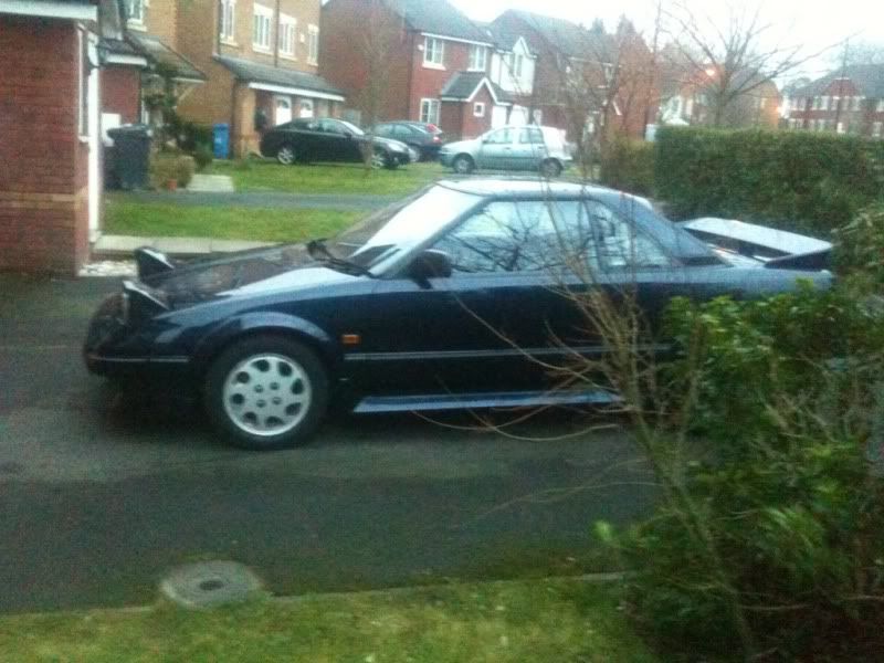

its exactly the right shape size as the old springs ,its probably just theyre heavier sprung which means of course it will take more weight to compress them ,they say there products are better quality than oem will pherhaps in some vehicles heavier sprung is better ,but on this with no engine at the front it means the ride height is on parr with a boeing 747

ive put some weight training weights on the rear springs and the springs dont move at all yet the old front springs do drop a few mm ,theyre just much heavier sprung ,Ive got KYB's uk office number which convieniatly is in warrington ,I will be ringing them on monday to bend then twist there ear
as for adam I did state as I did with you I have the right springs and shocks but untill I put up pictures you didnt believe me !!!!

Springs with a 30mm drop improve how it looks and also do no harm to the handling. There is also no problem with ground clearance, so no reason not to fit shorter springs.
I'm impressed with the height, I thought you had set it up for going off-roading at first! :tongue:
I'm not impressed with the height lol

If you're adamant that they are the correct springs then they simply haven't been fitted properly, all of this settling down and new v old spring talk is not what is going on there, you look to have about 3" of tyre to arch clearance which is not right at all, new springs or not.
I'd take them apart and try to see what you did wrong...... or as has been said, the springs are wrong, it's one or the other.

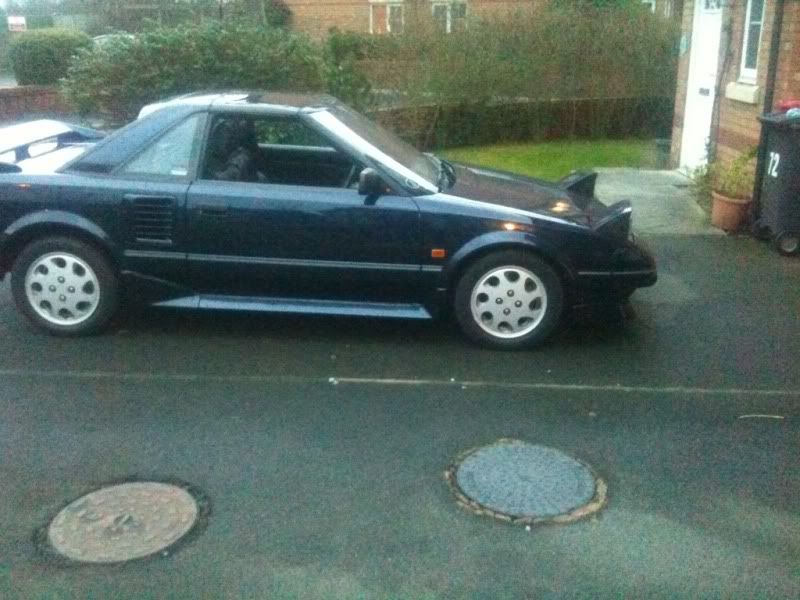

better or too low these are apex springs from cabbydave rear is still stock

I think you've answered your own question there, that now looks perfect, just what you'd expect.... the springs must be the problem.

took it all apart all was built up correct !!! compared old springs to kyb to apex lol and jesus the kyb's are SO ########HARD !!! you cant push them down yet you can with the others ,put the apex springs on as above and now its very low lol

****update*****
old springs are now back on lol if i wanted to keep my front spoiler and front boot floor the apex springs had to come off ,back to the bleeding start hahahahha
at least I can now say I can strip both sides struts off and change the springs and reinstall in about 30-40 mins lol

Any chance the spring manufacturer made stiff springs and just 'forgot' to cut them? Were the springs supposed to be std or shorter in length?

I'd stick with the apex spings, never had a problem with how low the Mr2 is.
