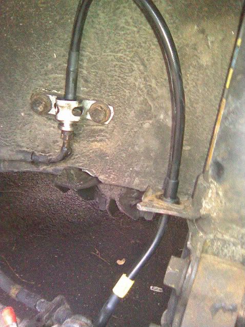

aj.extreme wrote:Well a quick update
Just got to figure out how to secure the lines to the wheel arch, may have to make a bracket from something, any suggestions? Pictures?
This is what i used

Re: Brake Line removal/rounded nuts - Refurbed Calipers
Post by aj.extreme »
Hmm looks good, was along the lines of what i was thinking off, just need to dig through the spare bits box, cheers
