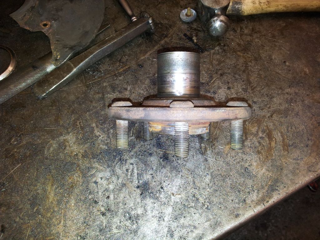

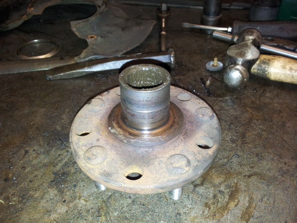

Ok, I've had to replace the p/s rear wheel bearing in my car 2 times already, this is the third. so I'm trying to figure out what might be causing this to happen.
We came across this,

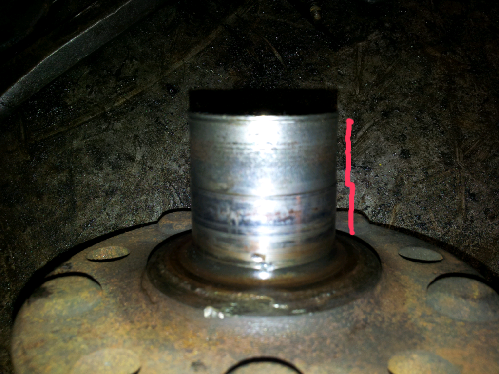

It might be hard to tell from the pictures but where the hub flange would go into the bearing seems to be slightly tapered. A small step down from the side which had the studs on it.
If anybody Could tell me if this is supposed to be like this, that would be great.
Cheers, Sean.

Doesn't look right.

Ok its getting replaced then. All I need to do is find another now!
