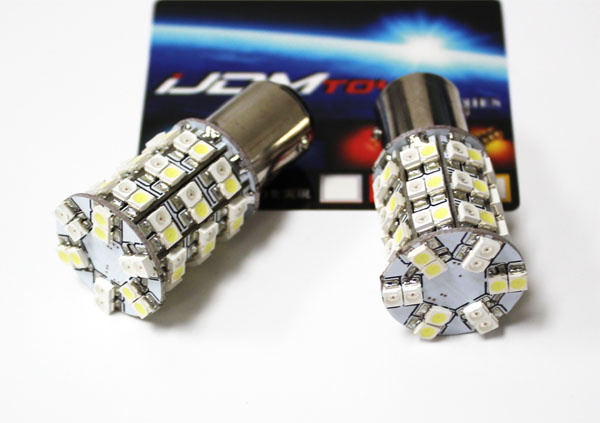

or you could wire in these duel colour bulbs
http://www.ebay.co.uk/itm/1157-2357-752 ... 588dacffed

Looked at these earlier on (different ones), but i seen these;
http://www.ebay.com/itm/2-Xenon-White-2 ... 20c2a32cf4
With a resistor in place they wont flash quickly, which is the reason i had dismissed them in the first place.
See the little spades on these are at different hights, is that different to standard UK bulbs, always thought those two spades were at the same hight?
Anyone else think these would be worth a try, would save me a lot of hassle if they did?

Ill have a look at the offset on the pins later today ,
those bulbs are just white though ?
what front lights do you have fitted ,the all orange import ones ?
if so it wont matter what bulb you fit, the sidelights will still be orange and a failure
