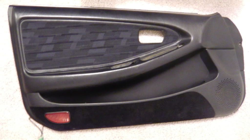

While I'm waiting for couriers to sort their lives out and find the huge building I work in ](*,) I thought it sensible to get a few more details on what the best method is to remove the stock cloth inserts and replace them with some aftermarket (LSC) versions?
From what I've read the stock leather doorcards come with removable inserts, however the cloth inserts are bonded in. So at a guess I'd imagine you have to take a scalpel to the cloth panels, leaving you with the space to add the new ones in?
Anyone done this and care to share some wisdom please? :thumleft:

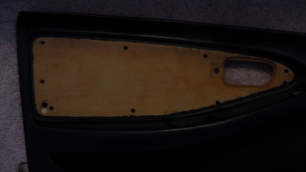

cut the cloth off with a knife, they are not inserts then just cut slits to fit the tabs of the leather inserts, really is that easy :)

Up to and including the vinyl edging?

up to the edging :)
dont cut the edging :)
