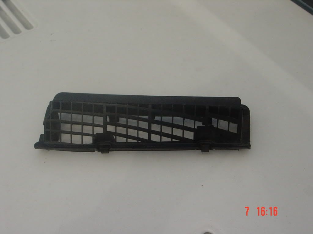

Pic shows one of the grilles that cover the vent openings
Holes as big as those let in grit, bits of trees, etc, which can then blow out in your face
No thought of allergy problems when that was designed ! :cry:
