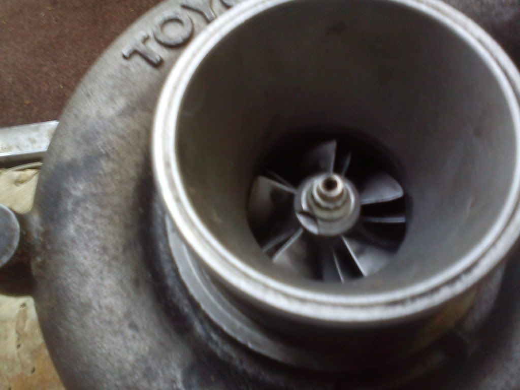

Now...I know what your going to say...CT20 is more powerfull and torquey...and I would agree that lower rev range, the ct20 pulls better...but I've just changed from CT26 to CT20 and am struggling to make full boost.
On my old turbo, AVCR set to 1.2bar at 69% duty cycle would cream 1.2bar and on a crisp eve would spike at 1.4ish @6k rpm...the CT20 is making, at most so far, 1.07bar @6k rpm and in no way is it as quick as the old CT26...in fact the car seems lumpy at anything over 67% duty cycle now
I inherited the CT26 with the car so I don't know what,if any, work has been done to it...it has a pen mark on the shaft and has visable signs of tool marks on the nut...has A3-10 marked on the top???
The new CT20 had chipped blades, but not hanging off, surely this wouldn't affect boost so much?

Chipped blades on which side, hot or cold? The CT20 on my car (standard bar a steel shaft) has no problems whatsoever hitting over 1.1 bar, infact while having problems it managed to spike to 1.4 :shock:

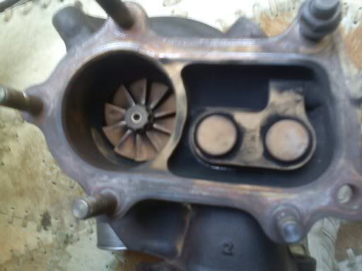

chipped on the cold side...but not much...biggest bit would be about 2sq mm...thanks for the reply guys...if it has to come off, so be it, although it came from a very safe source and was all good on it's last car...wouldn't I smell the leak if there was a crack?It's a ceramic job I assume, there was no hole in the centre of the exhaust wheel like in the pic of the 26 ...lol..this 20 was supposed to tide me over untill I can get something bigger...and truth be told, I rarely go above a ton, just into banging it around the lanes, thought the CT20 might even do the job completely...my mates rev3 seemed bonkers quick pulling 295 with a 20b on it...this blower was the first in a long list of bits that I plan to replace to bring it back to form, the leads are suspect and need to be replaced...and I have the bits to make a copper tabbed dizzy cap...my plugs were coked up to hell when I checked earlier on and there is a defianate misfire now I've pulled the leads about...where do we go for leads? oem is the way forward isn't it?

A CT20 is not the same turbo that is fitted to a Rev3.
The Rev 3 and ST205 have what is called a CT26 Small, but everyone calls them a CT20B.
If you have damage to the comp wheel the turbo is scrap. It will not boost well, will be out of balance and will not last long. No one makes replacment comp wheels for that turbo

I'm with Bob put it in the bin.
out of balance turbo, potential engine write off.
