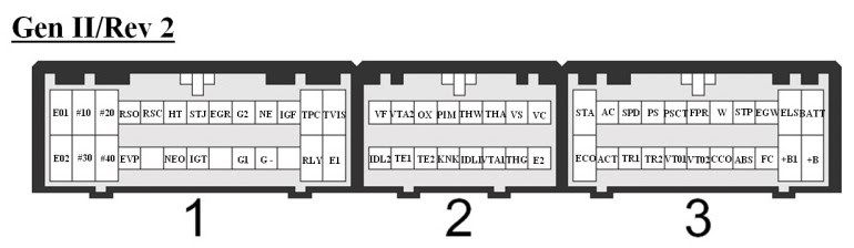

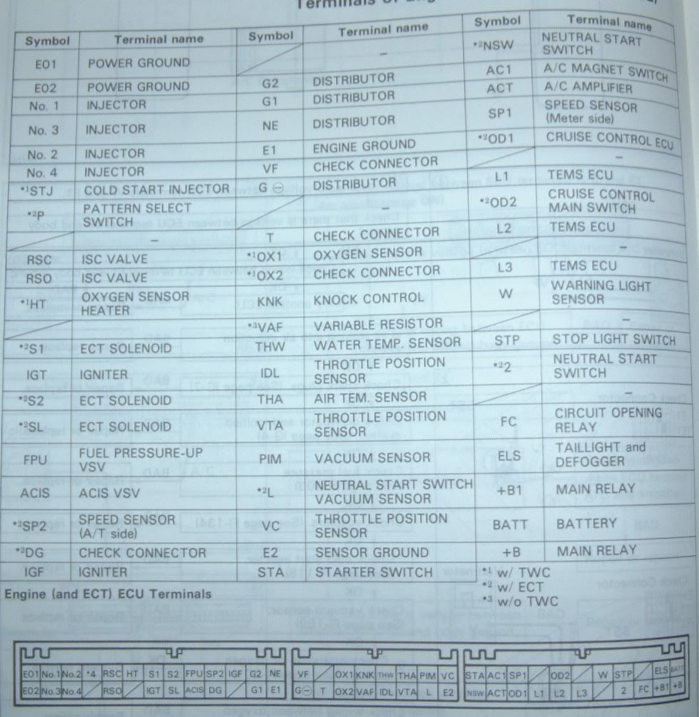

fk yeah man...if it's split or over white on the resin part...it stands avery good chance of being a bad friend....the bottom pic is the pinout guide that I've used for my rev 2...the top pic,I have been told, is from a celica auto or something...but it gives you a run down of the abbreviasions.
