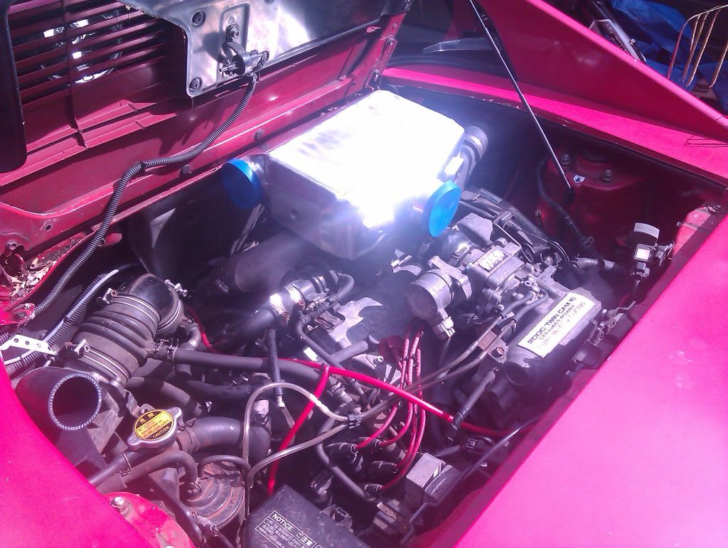

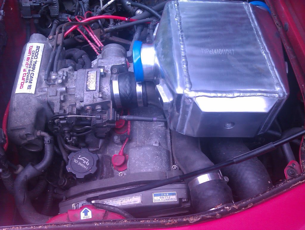

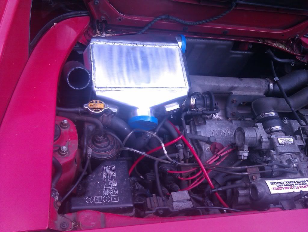

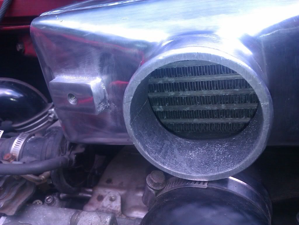

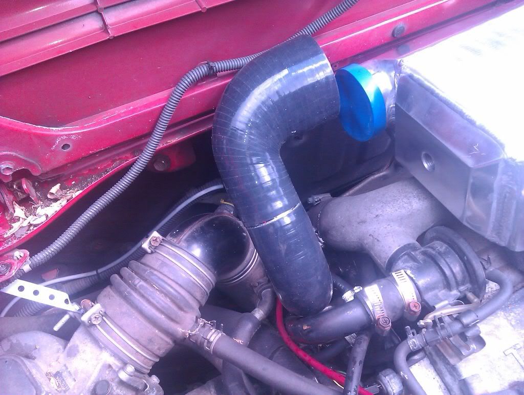

Pictures of mine. Not going to be a bad fit I dont think, the option is there to move it over to where the AFM is once I have that removed or relocated (with my celica N/A side feed).

That looks to be a great size/proportions to mount there.
What make core is it? One of the ebay cores?

Its from Frozen Boost in the US but I would imagine it has come from China to them, no one on ebay right now is listing this core size with these inlets/outlets so its ended up costing me £235. Bet they will be up there next week for £99!

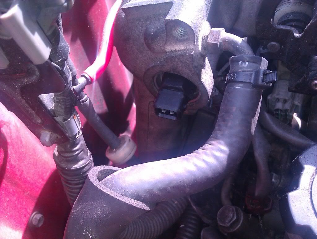

Last job of today, got an inlet temp sensor fitted. I have a Megasquirt in the boot, going to run it as a parralell setup with fuel and boost on the squirt and ignition and idle air control on the stock ECU. Its only connected to monitor at the moment so I can datalog the inlet temps with the stock i/c before fitting the chargecooler in a few months.

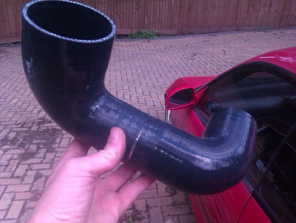

The core fits well but the pipes from the turbo look better in the pictures than in reality. Its one 2 inch 90 degree bend coupled to a 2-3 inch converter which is also a 90 degree bend. They will both need to be much shorter which means the coupler might not fit but somehow it has to!
I was thinking along the lines of one day getting a Garret in there which can be clocked so only 1 90 degree bend would be needed.

Is that pretty much where you are mounting it- directly above the exhaust mani?
