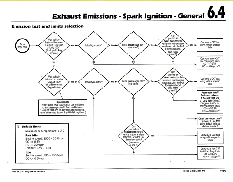

cvega666 wrote:don't you need a cat for MOT if it's post-1993?
Japspeed is also exceptionally loud- way too loud for me
bri0905 wrote:I was under the impression cars built after a certain year need a cat to be fitted.Not just to pass the emissions test with or without one.
Marf wrote:bri0905 wrote:I was under the impression cars built after a certain year need a cat to be fitted.Not just to pass the emissions test with or without one.
Nope, so long as you can pass the emissions test for your given car it matters not whether you have a cat or not.
