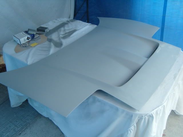

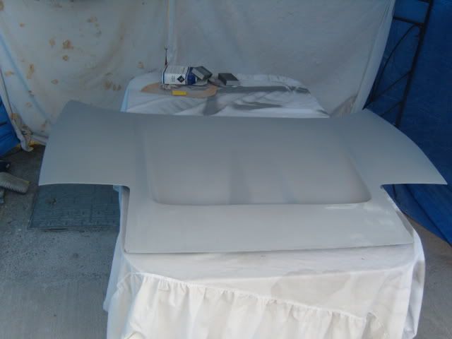

had a better day today lowered gun preassure added a bit of thinners not to much and away i went,
this time i left it i sprayed an old bit of metal i had and rubbed it down with 400 some 7 hours later and its now smooth, i also think i never gave it enough time to dry before sanding and it was still tacky hence why it wouldnt go smooth.

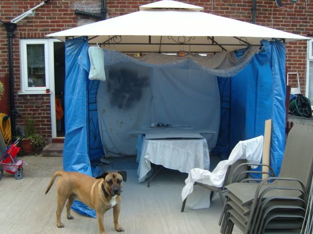

heres bonnet in high build primer ready to flat sand tomorrow and then the dreaded colour which im not looking forward to, in saying that you learn by your mistakes.
and heres my makeshift spray booth oh and diesel my dog he cant resist a picture poser.Image

Wow, that looks great :thumleft: What pressure did you use in the end? Give it a black guide coat and it will look even more professional :D Did you get the washer jet holes done?
