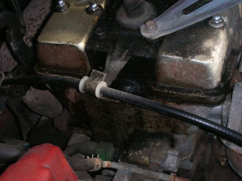

opened up the bonnet lid,and there was steam coming from the side of the engine,looked like it was coming from the head
im fearing the worst right now

just added this to show where the steam was coming from

That's the coolant outlet from the head - you may be lucky and have just blown the gasket for the outlet - unlikely though :(

i did notice that the black stuff was bubbling a little,i topped up all the water tonight and left the car running with no overheating at all....might i have been lucky im not sure
