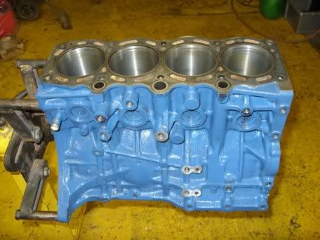

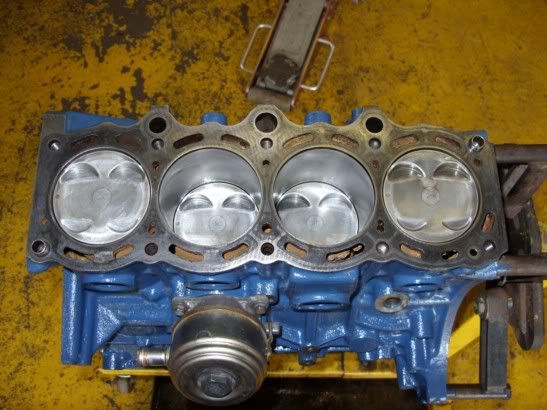

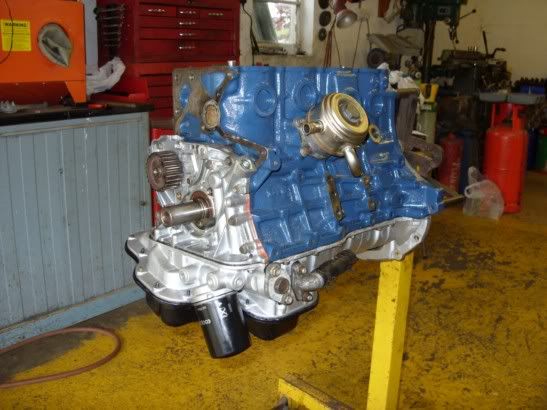

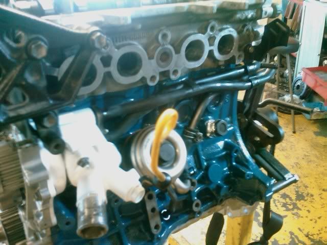

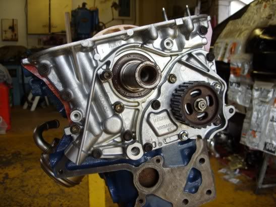

i started to rebuild the engine before i started racing so it was just going to be a rev 2/3 mutant
but as you'll see it evolved :twisted:

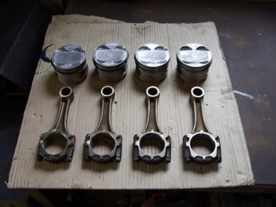

i started with a rev 2 block and an st205 engine that i had with a cracked block
so cleaned and painted the rev2 block
used the st205 crank
cleaned off the st205 pistons and rods removed all the sharp edges on the pistons and sanded the shine out.
ballanced the rods and pistons
then fitted total seal rings, clevite bearings and dropped them in.

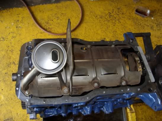

nice new rev3 oil pump
Drilled all the holes needed to fit a rev3 sump to a rev2 block and on it went
so that was the bottom end done

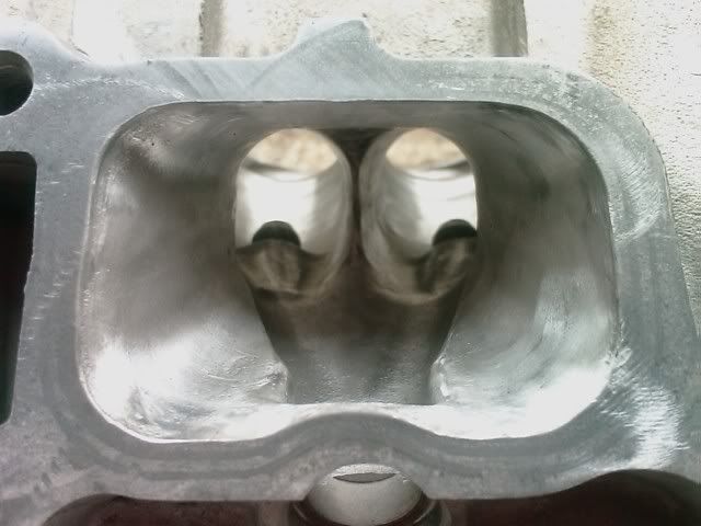

now the head

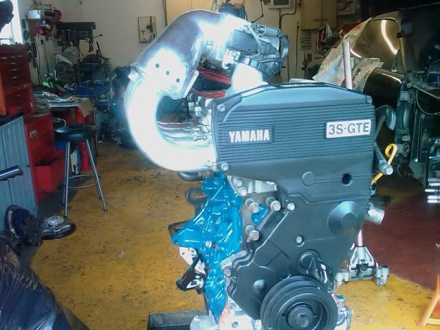

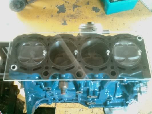

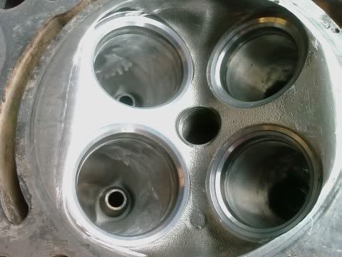

i ported and polished the head and smoothed the sharp edges in the combustion chamber
re-cut the valves and seats and cc'd the head
fitted rev3 cams but used rev2 buckets and shims
then i cc'd the block
used a rev3 gasket and arp studs
had to make up the odd pipe to go from the block to the rev3 oil cooler then used a mixture of rev2 and 3 bits
head and block all sorted i fitted the jun inlet manifold this was later removed as im saving it for my 5s build

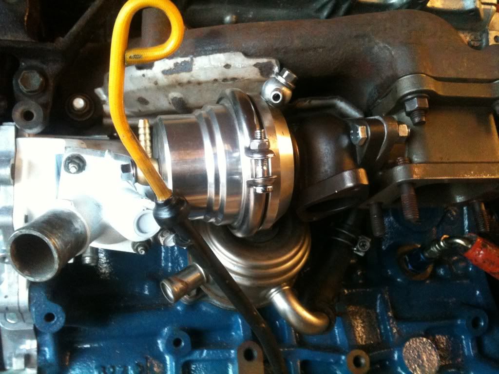

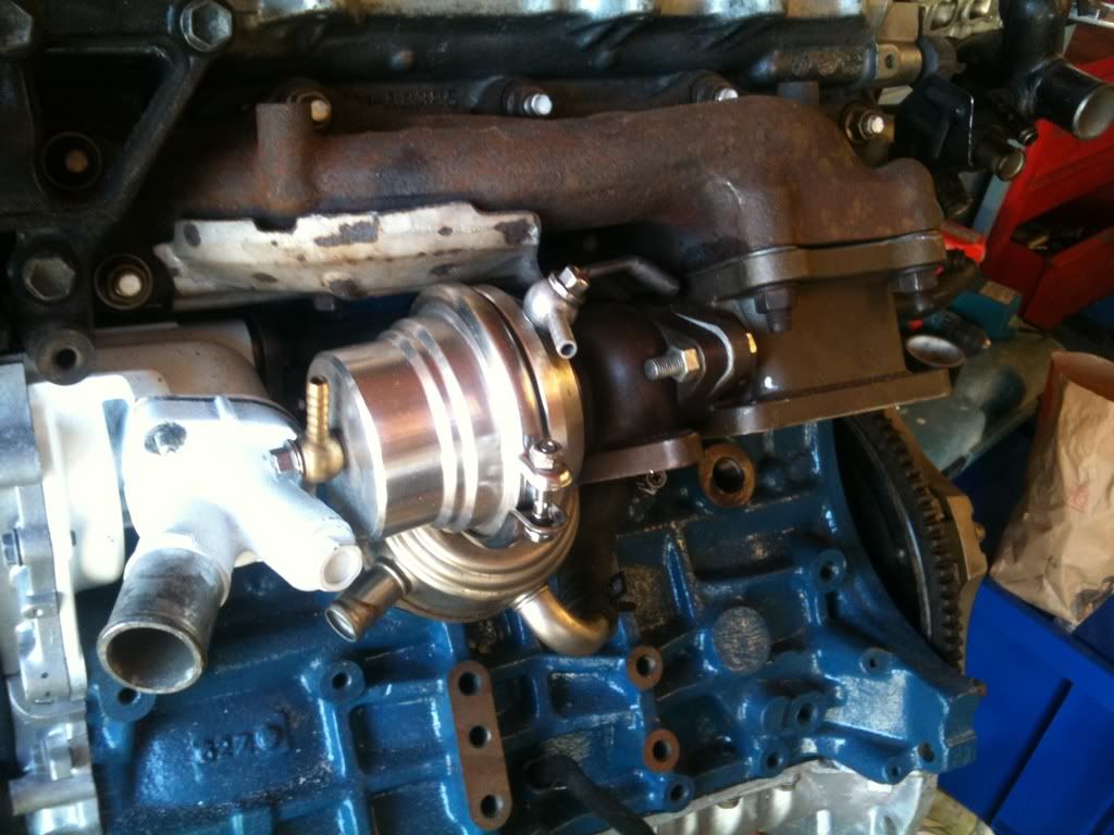

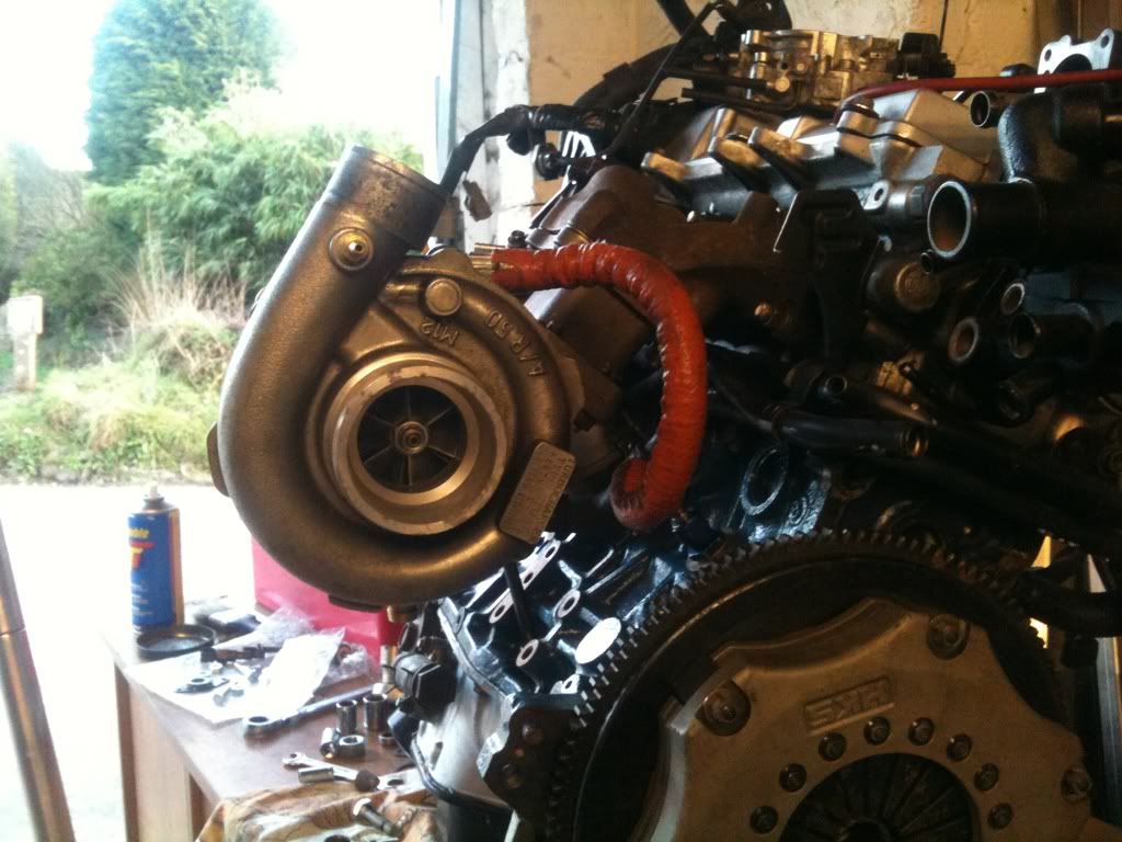

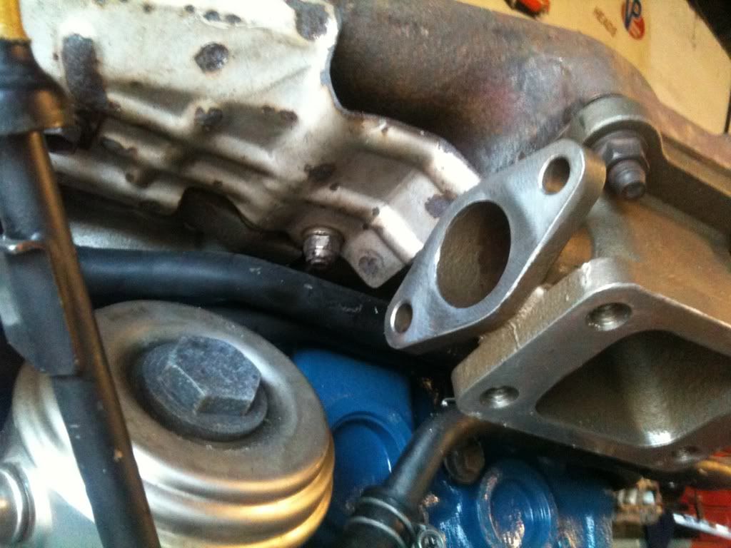

.......the turbo setup :oops:
well all i can say is this all came up free and as it would give me more power than the ct20 i used it!
The story goes i sold the red mr2t to a friend and after about a month the head gasket blew so i changed it for/with him and in exchange he gave me this.
it was a t3/4e with external waste gate and a few bits and bobs
imo not a good way to do it but by now there was about 16 days left to get the car running for my first race of 2011 so sod it.
thought id do the best of a bad job so ported a stock exhaust manifold on the milling machine
on with the adapter
on with the waste gate
bit of work to get it to fit
chinese turbo! on the plus side when my antilag blows it to bits its only cheap.
at least i can fit the stock heat shield
Image.

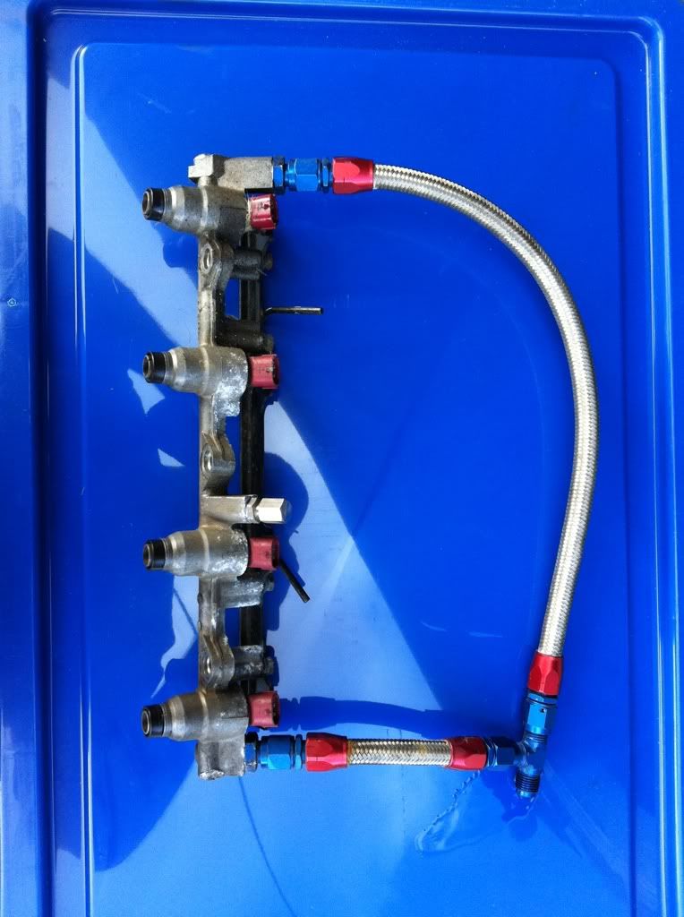

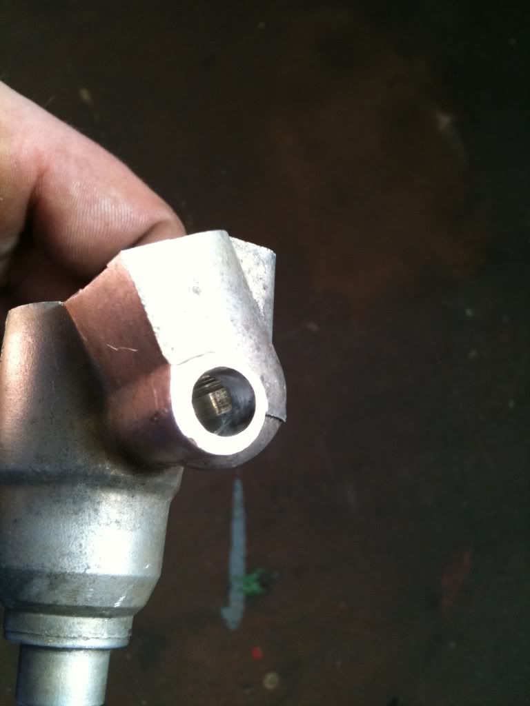

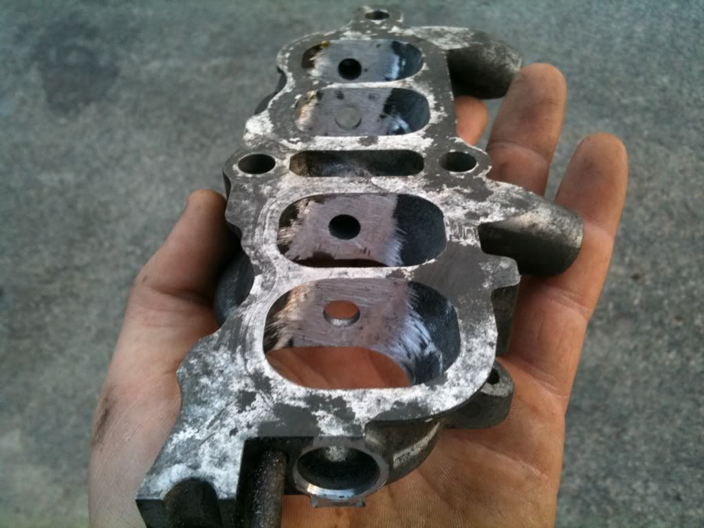

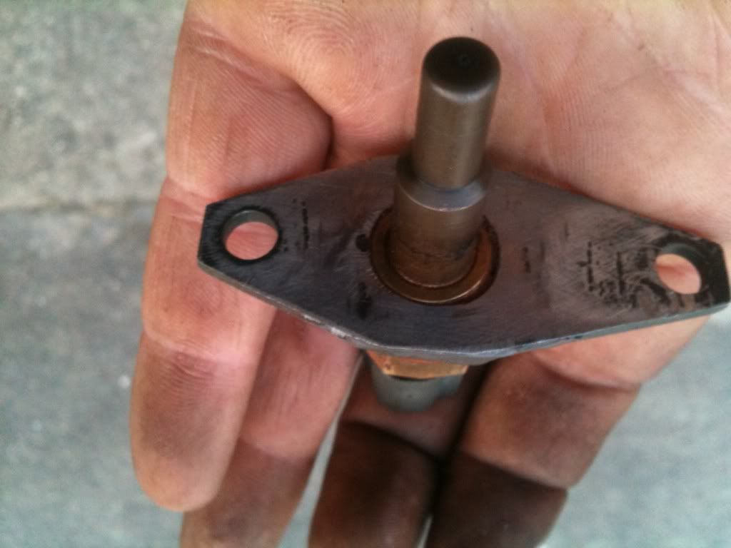

so running the bigger turbo i needed to convert to rev3 and as i had the rev2 head on the velocity flaps had to come out
cut out the cold start and fitted the mat
modified a stock fuel rail and opened it up to 9mm

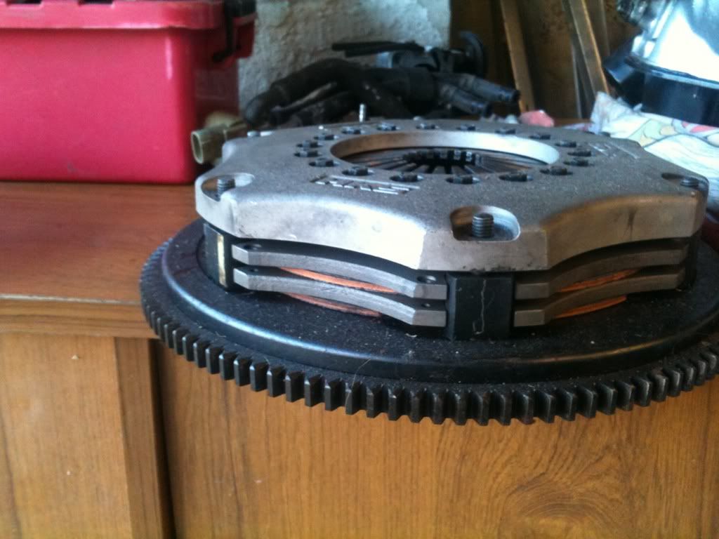

clutch
fuel rail fed at both ends in -6 with rev3 injectors
also fitted a bosch 044 pump in tank
got the engine ready to drop in ( prob missed loads out ) so moved on to the car........

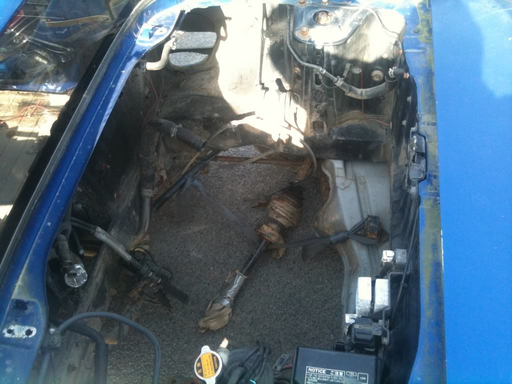

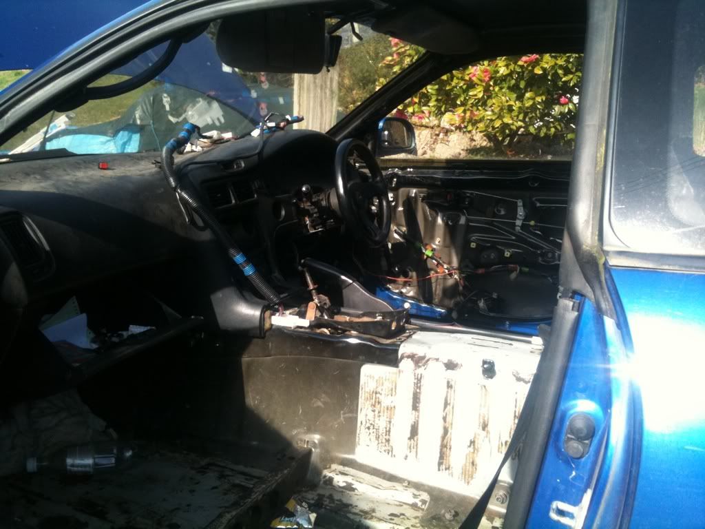

The car had stood up for well over a year now so there was quite a lot of bits to sort out
while i was at it ill make some room for the bigger tyres
treated it to a new set of disks and pads
didnt go for anything special on the discs as i dont think they need it so oem it was

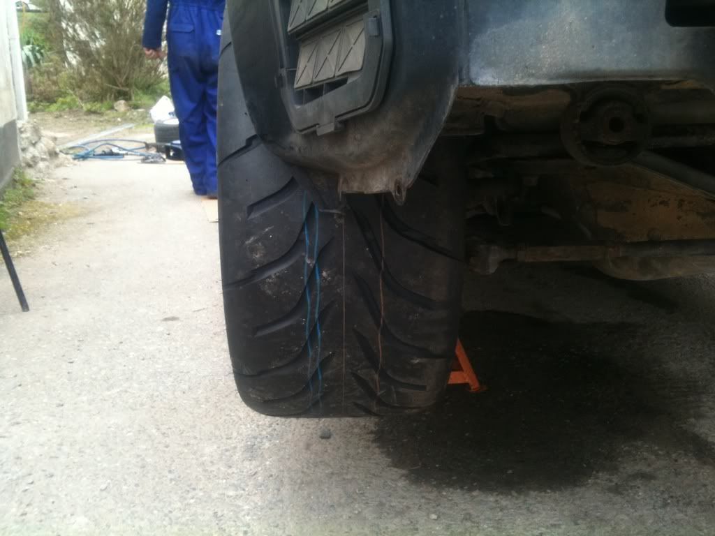

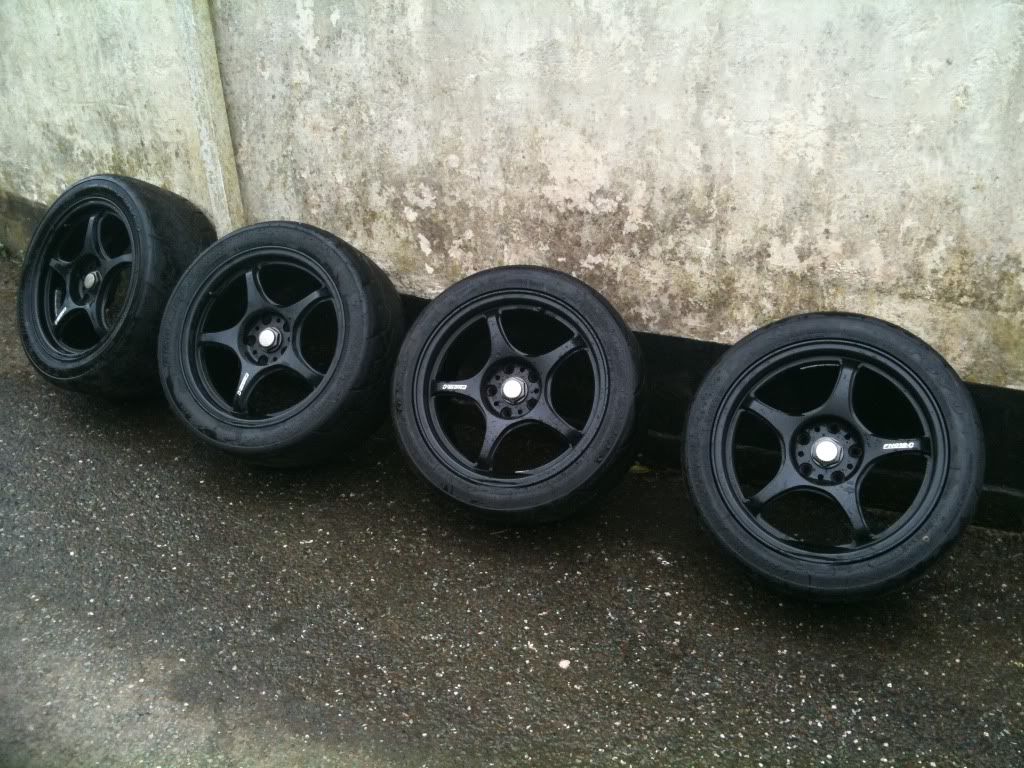

bigger rubber than last year 275/40/17
same wheels tho 5zigen fno1rc's
front 8x17
rears 9x17
cant remember the offset's

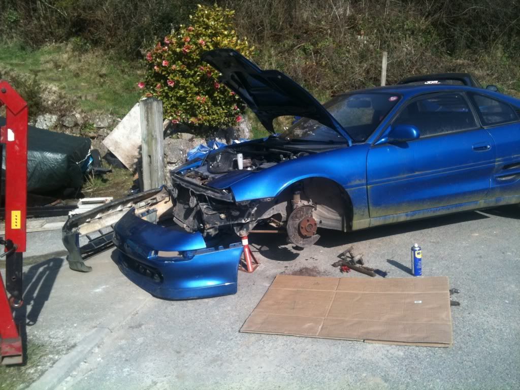

...........................It tryed to kill me! :shock:

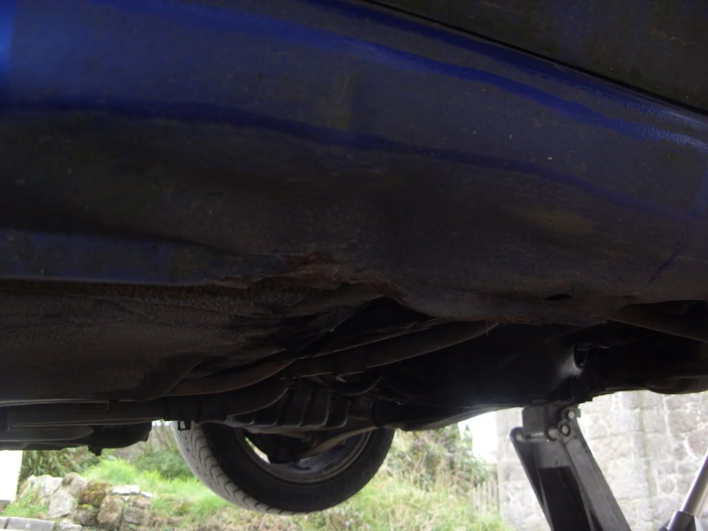

i was borrowing the ramp next door when (screw type) it decided to strip the thread
i didnt know this and had to use a jack and block of wood under the one pilar where it had jammed
well i pulled the jack out turned around and when i turned back it was at my feet!
the sill took the brunt of the damage

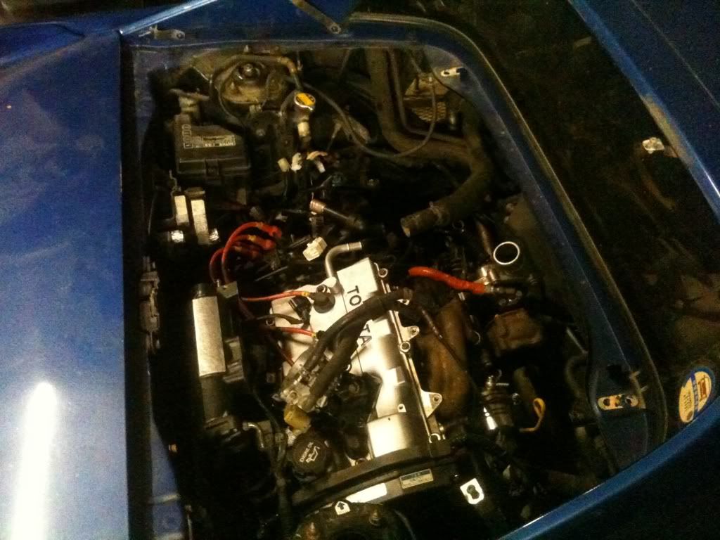

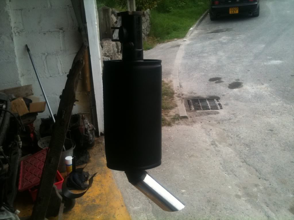

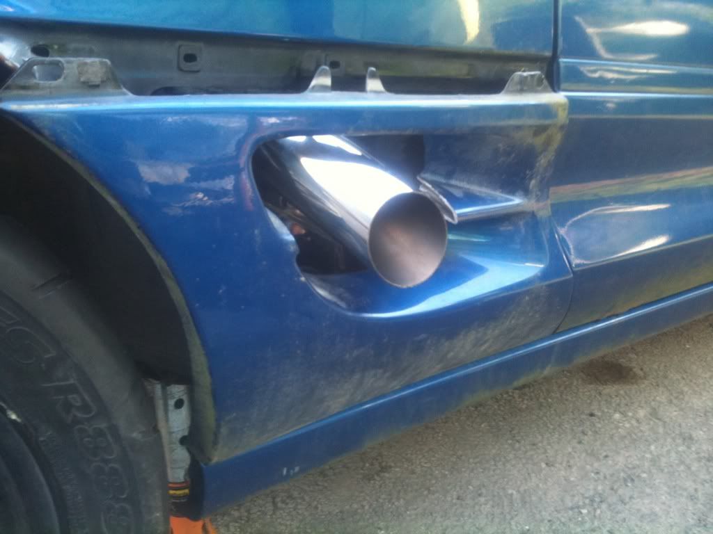

Well after getting the engine in it needed an exhaust and ive always fancied a side exit so this was my chance
i ordered an oval silencer from jetex along with a length of 3" stainless and a flange.
for some reason i didnt take pics while making it so only a few of it in

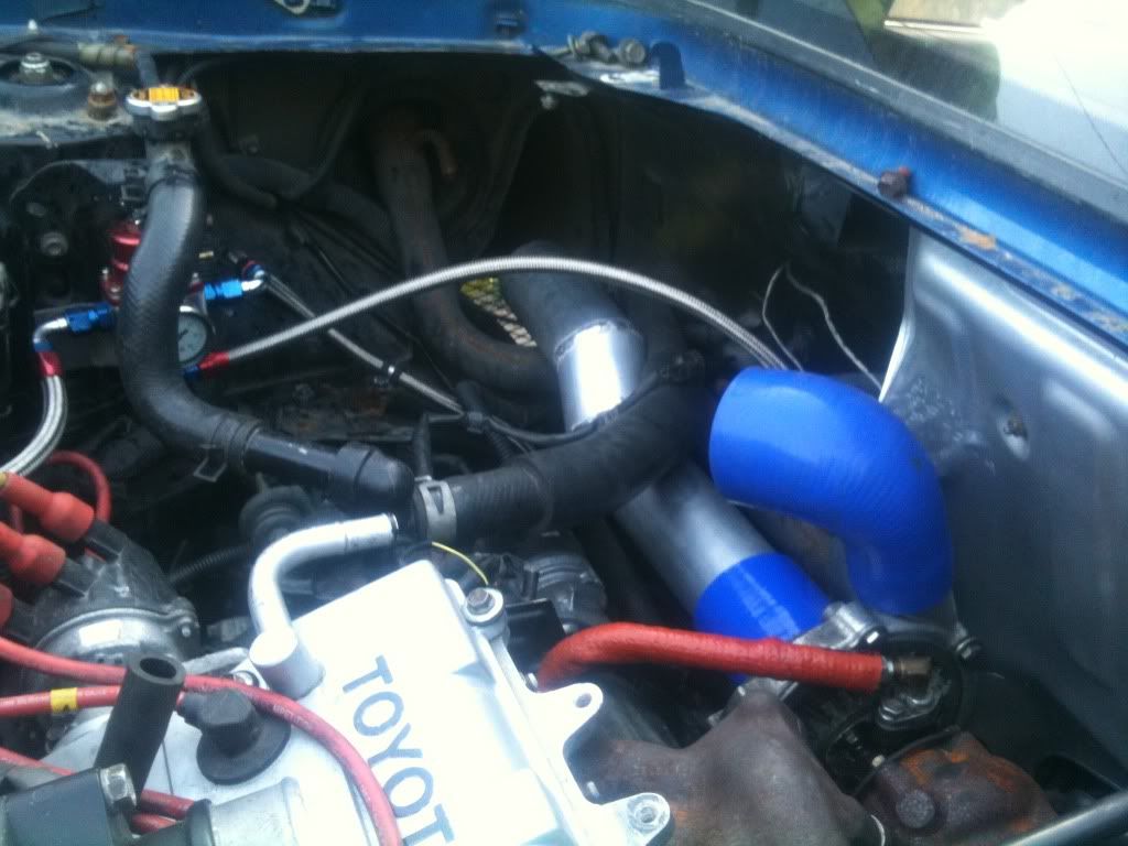

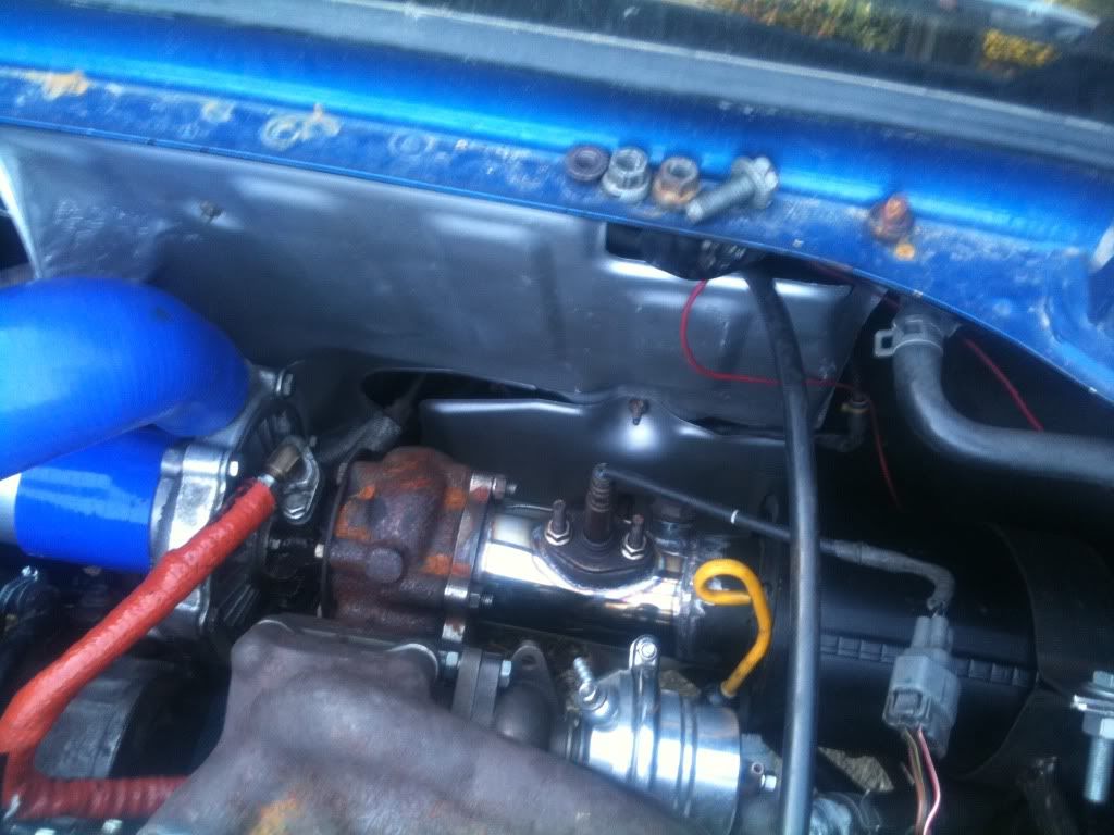

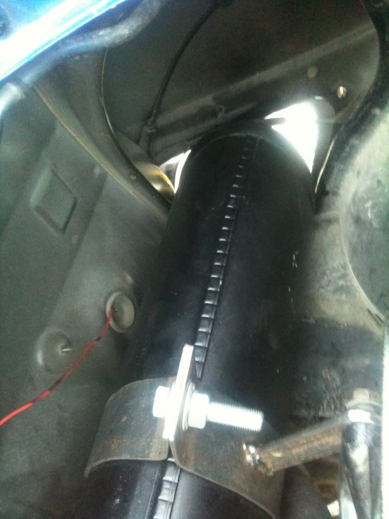

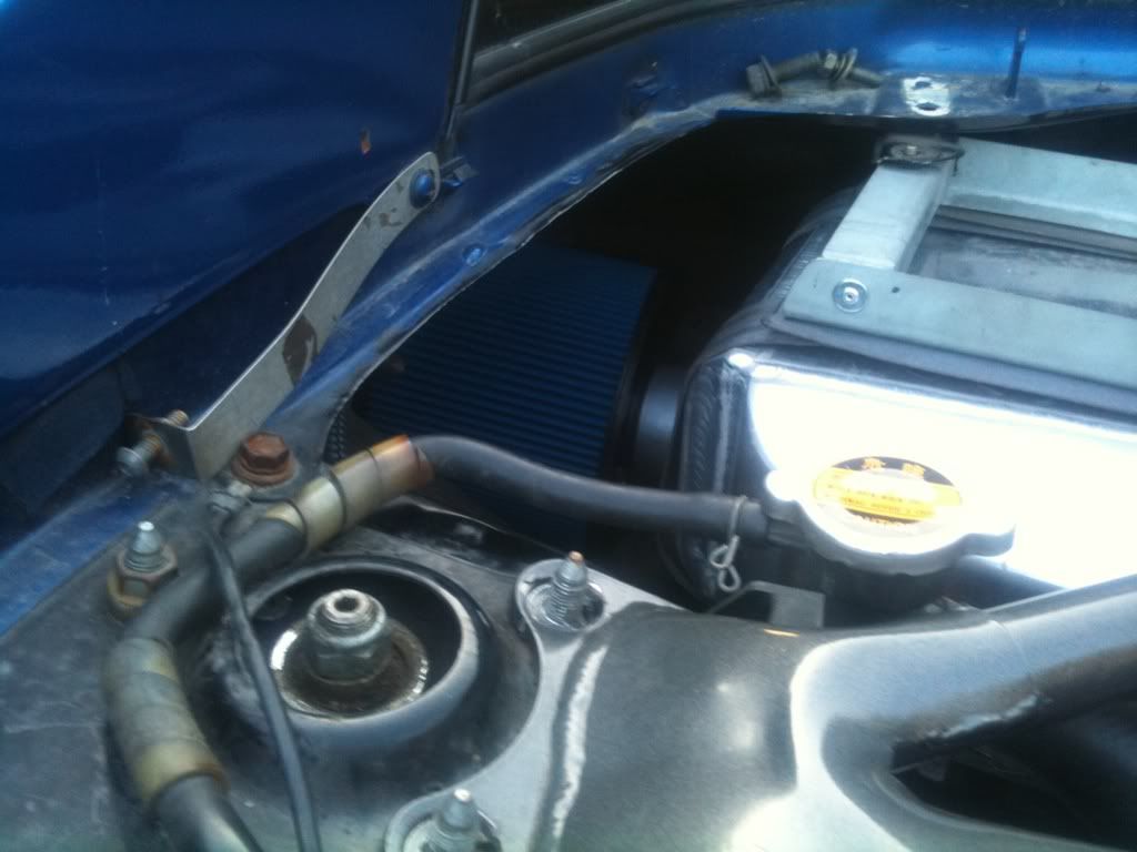

so the zorst done i started the inlet
that was a jetex filter and 3" aluminum tube
had to cut the little fuel pipe and join in hose to get it back far enough to fit the charge cooler.
i fitted my charge cooler rad and pipe work about 2 years ago as i had a full carlos sainz system just didnt get it finished.
the rad
i made the front to rear pipes from 22mm copper tube and bent it with a spring along the same route as the ac pipes. This was not easy and will never be doing it again!

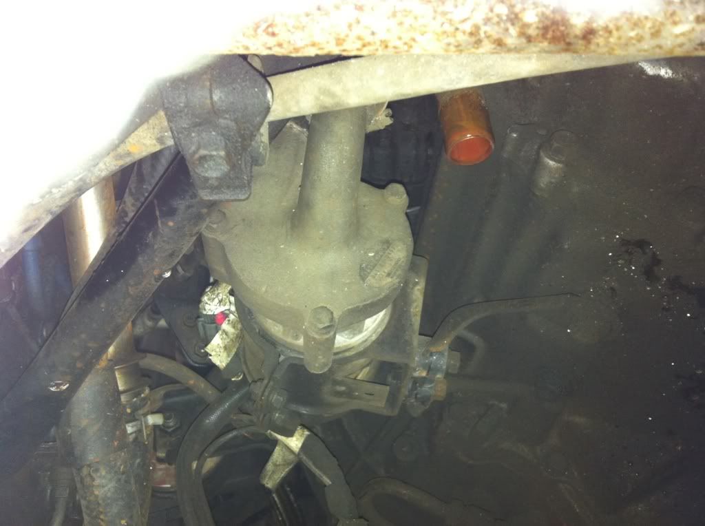

fitted the pump on the gearbox

Re: Mr2 Turbo Sprint Car (Banshee)
How loud is the exhaust? I like the idea :thumleft:
stephano
Posts: 409
Joined: Sun Apr 15, 2007 9:50 pm
Location: Cornwall Uk
Post by stephano »
its 102db at 3/4 full rpm
on full load at low rpm its not a nice noise once up over 2k its quite nice
and on full boost with the wategate open i love it!
