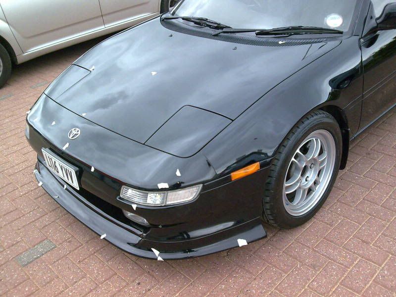

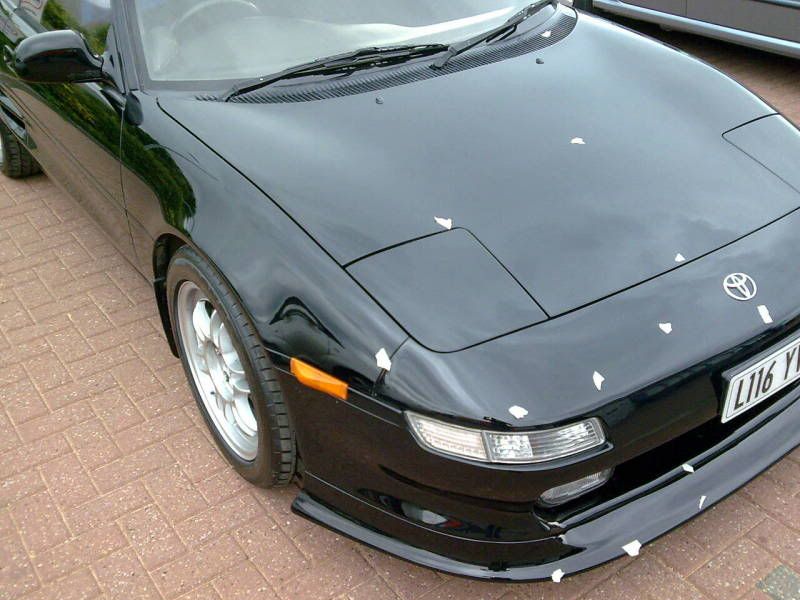

just had my Mr2 in the paint shop to orepaint the bonnet bumper and splitter and rear spoiler
wasn't too impressed with the end result, paint finish was pretty good but the imperfections(dimple marks etc) were not good, so its stayed there to get refinished.
here are some pics
check out the bits of masking tape to show were the marks are
they jokingly offered me a job as inspection guy, and i told them they paid him to much!!!

yes the car does look fine from a distance, but like i said to the bloke there i don't drive the car from a distance!
the marks are smal, little bubble marks (like dirty under the paint)
little pin craters ( the guy said thats probably a stone chip, i said don't you prep it flat)
light sanding marks in a few places, and what looked like a deep scratch mark by the side light.
and a run on the rear spoiler
not what you would expect for nearly £700
so its going to be in there a few days longer and probably getting repainted.

i wouldnt dare turn out work to my customers like this :shock: i get my work by reputation , and it only takes 1 poor job and your rep is mud so to speak. your problem could be a number of things but without being able to see a close up i cant say just what :-k but your well within your rights to dispute anything but a perfect finish for the money you are proposed to pay. now i assume your car has been painted in base over clear ? (base coat black , then laquer'ed) now if this is the case , and if the laquer hasnt flowed evenly over the basecoat you will get the effect that there is a small pit , fish eye , dent by appearence. if this is the case it sounds like contamination to me on the basecoat. now i dont think for 1 minute they will re paint your panels ! i think they will simply get a touch up brush and spot a bit of laquer into the dimple marks , pits , chips etc . they will wait until the laquer hardens and simply flat the touch ups and polish them back in. you will be able to see if they have done this by simply looking into the light where one of these dimples was , and you should be able to see a ring . they will use a polish called "hand glaze" to hide these . if the job looks ok at the end and your happy i suggest you re negotiate the final price as the work is sub standard . dont let them know your happy with the final job. just let on you can see imperfections :whistle: :whistle:

Get yourself one of them LED torches
you know the ones they sell at petrol stations for £5 about 10-15 leds
This is overkill but you get the idea
http://www.sourcing4u.co.uk/shop/produc ... ucts_id=46
that will show up every imperfection on the paint surface and will show up any handglaze applied over the pits etc.
