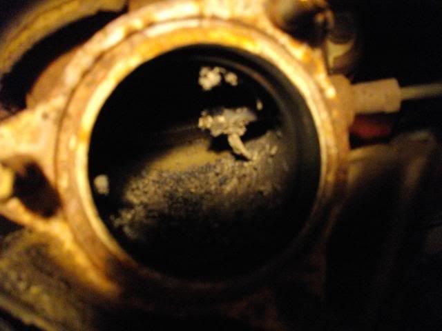

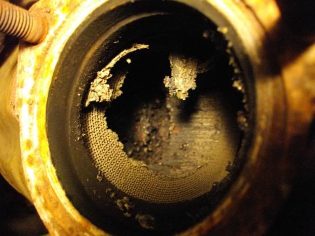

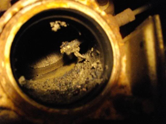

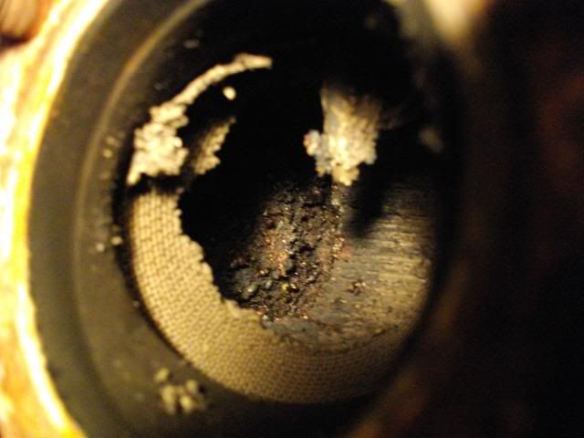

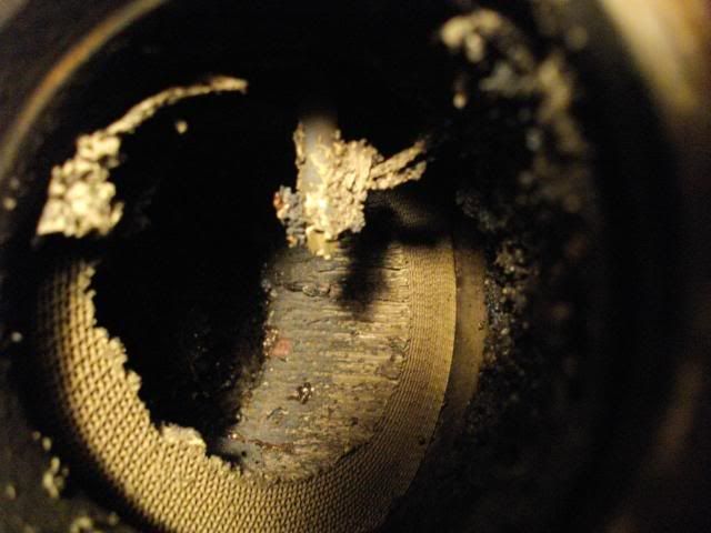

I could see the sparks from the seat there was loads of them the cat temp sensior light came on at fiirst aswell do you think it was the cat breaking up got it in the car park at qork and it seemed find again so could the exhaust be blocked ?
That's what I was thinking I am guessing some has come out but I'm guess it wouldn't be a good idea driving it as if it blocks it just causes the car to no stall but it won't run abit like if you have covered the exhaust pipe but will run for a few miles then stop again

Well i think this is the problem i think the cat spat its dummy out here is the pics
