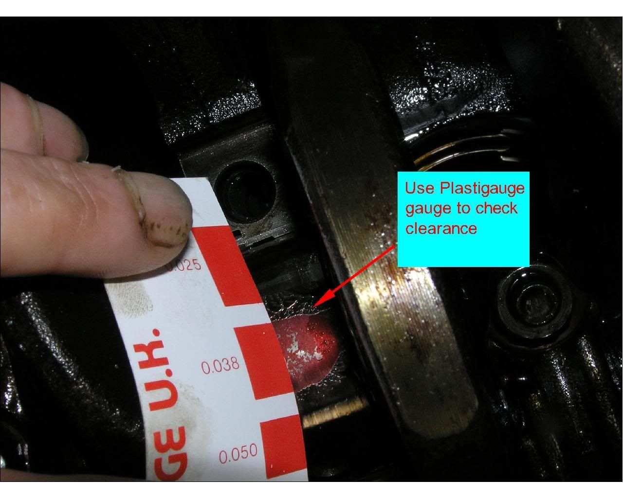

16) To check the big end clearances accurately you need to purchase some Plastigauge.
With the engine
(or rather the pistons and con rods) in situ there simply isn't any other way of accurately measuring this.
17) Clean each crank journal thoroughly.
Cut a piece of Plastigauge to the length of the journal.
Coat the plastigauge slug with some grease.
Stick the Plastigauge slug to the journal, the grease being used to hold the gauge onto the crank.
Clean the big end lower bearing and spray on some Silicone release spray
(oil will probably do)
18
) Refit the the lower big end cap and tighten to the recommended torque.
Then remove the lower cap.
19) Inspect the results by using the Plastigauge calibrated ruler.
