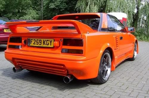

basically i have raised the height of the spoiler, took out the middle support, added a rear brake light, and moved it back, plus extending the sides so it sits in the same space on the car - just longer sticking out to be in line with the rear bumper and raised to approx twice the normal height off the car. :mrgreen:
Added metal plates for support, and smoothed in with fiberglass and resprayed etc.

Jo, Do you have any pics?
mr2mk1chick
Posts: 4079
Location: Leicester
Re: Original spoiler modification
Post by mr2mk1chick »
MarcsMR2 wrote:Jo, Do you have any pics?
here you go 8)

wow thats a big one!

Thats spoiler is massive Jo! Looks great on tango 8)
