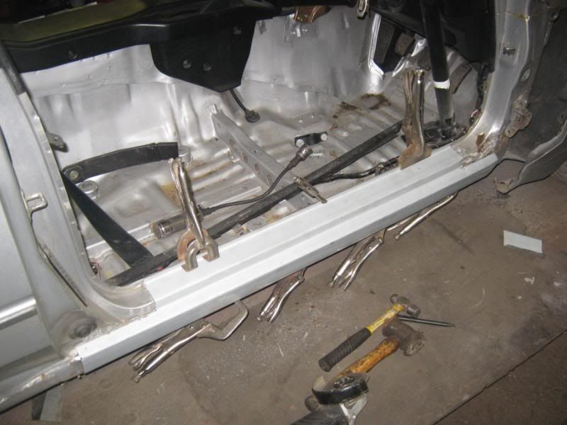

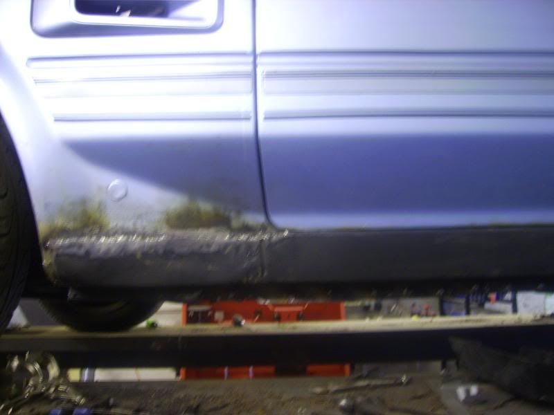

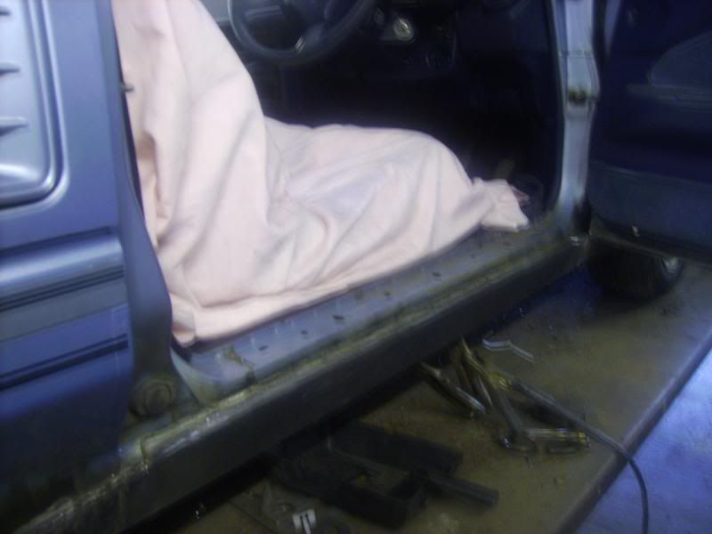

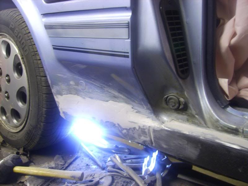

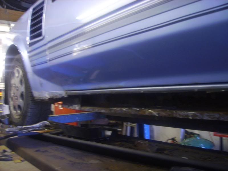

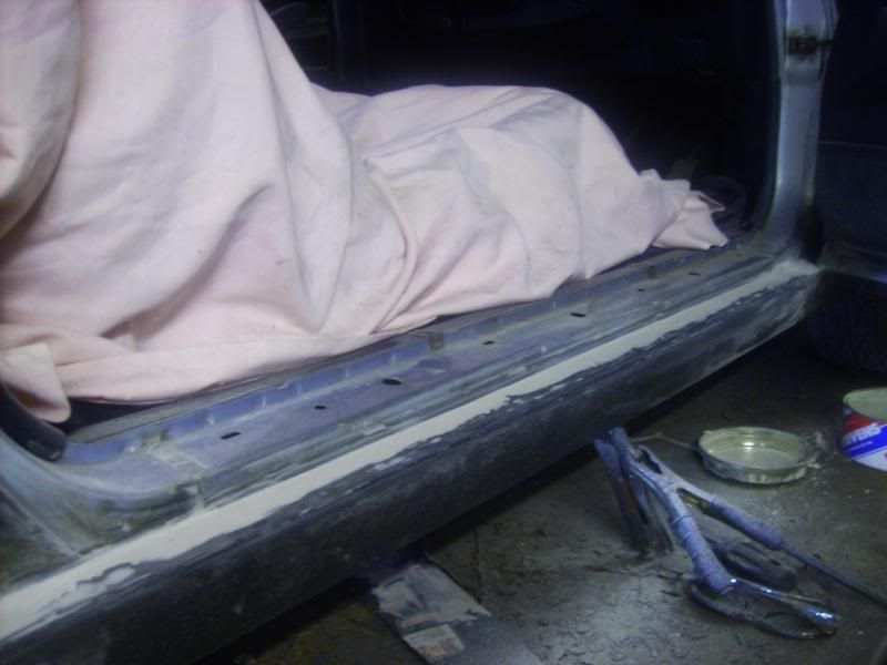

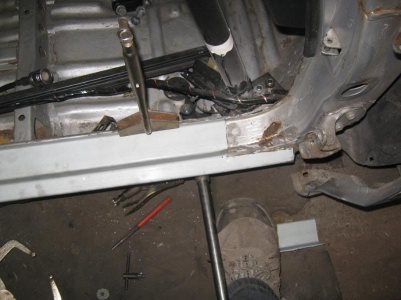

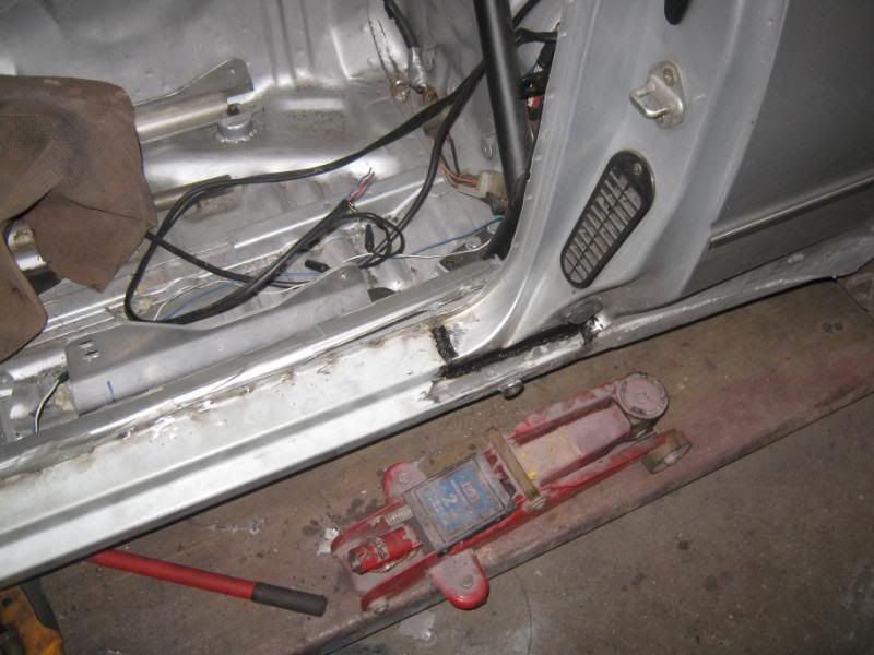

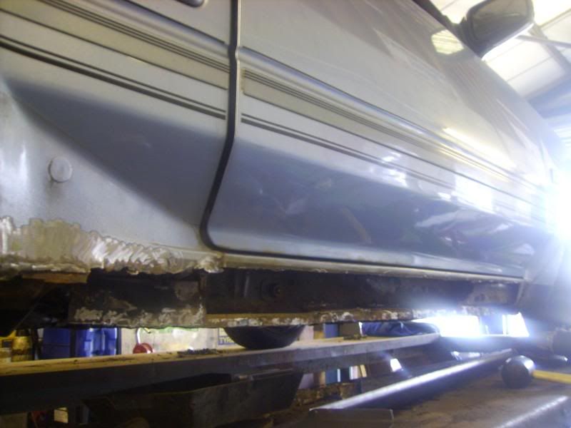

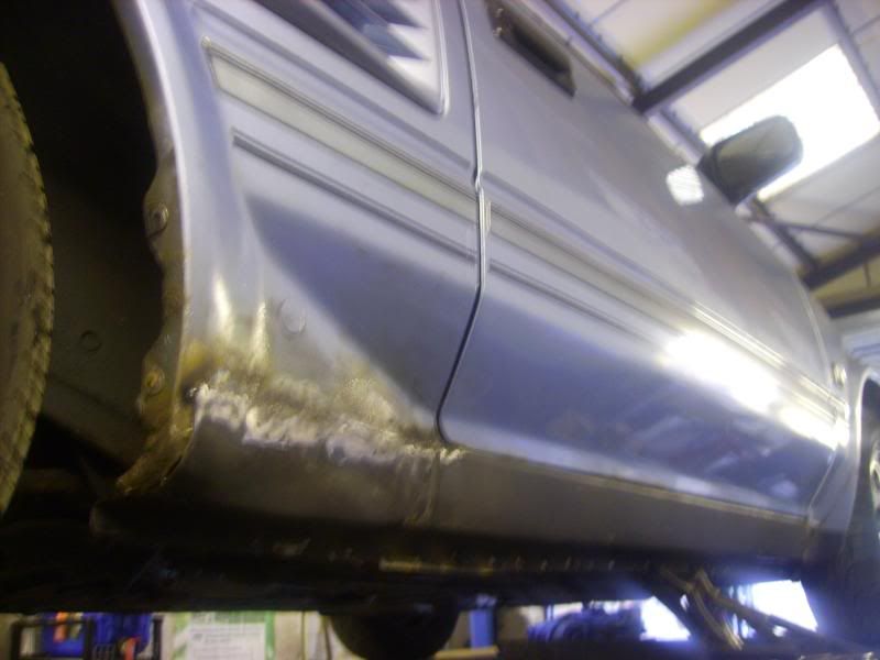

hi peter , this is one of my cars i did about 4 years ago using Mr woods mod and it worked a treat but you will have to put another 10 degree bend in a long the full length to get it to fit right .
a few pics off fitting little birds sills .
hope this helps
gary :thumleft:

i do pretty much as Gary has shown you except i leave more panel on the section just ahead of the rear wheel arch, the Escort sill has a large panel there that you can fold to replace most of that.
Once done it makes a perfect repair and you cannot tell the difference.
