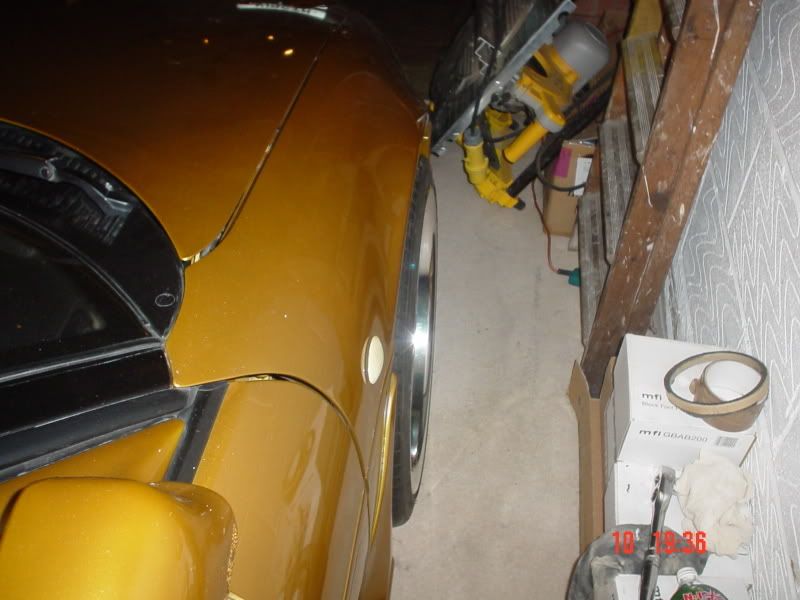

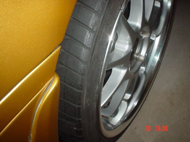

these are my new wheels 8 x 18 +32 front with 225 35s no rubbing :)
rear is 9x 18 + 32 fits perfect

there not on the car yet, just tried the fronts to make sure they fit!
