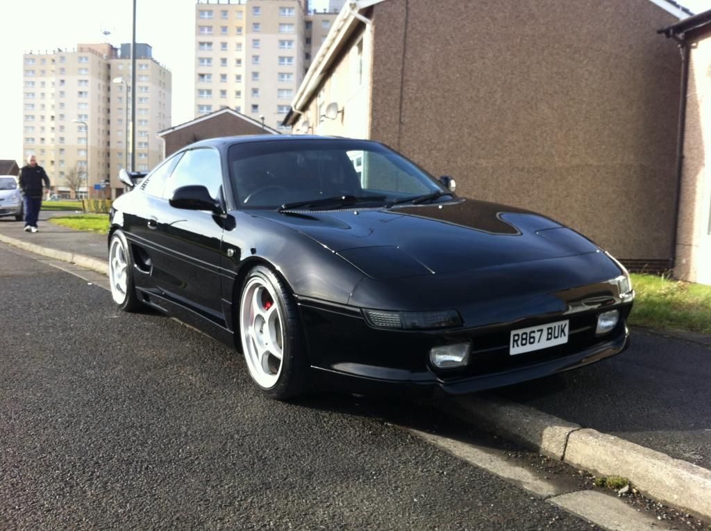

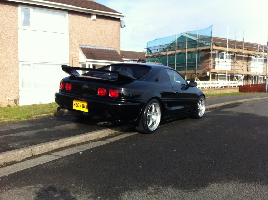

If your just going for springs eibach pro lines are considered the ones to have
Thats my current one on eibachs with 16" advans

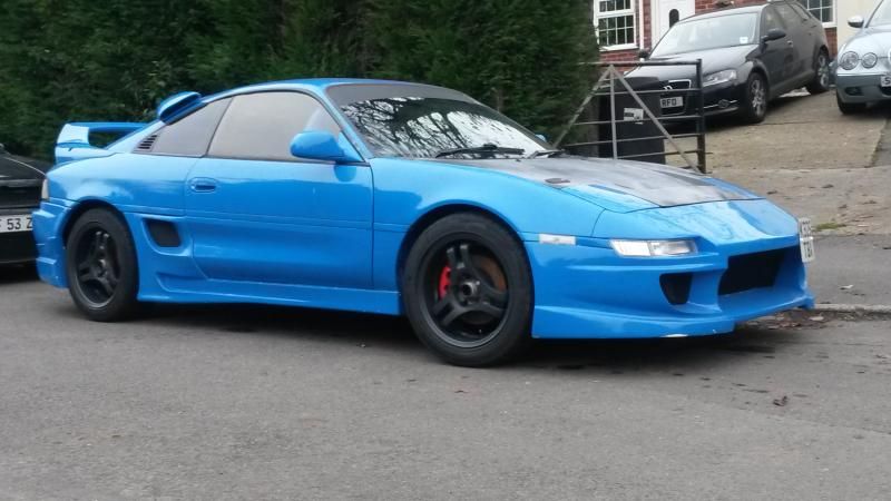

And that's my old one with same springs on 17" is200 wheels

yea it looks ok but not as low as i had hoped and if im going to have issues i think i will just go for the coilovers as i am wanting it to sit similar to my old rev5
