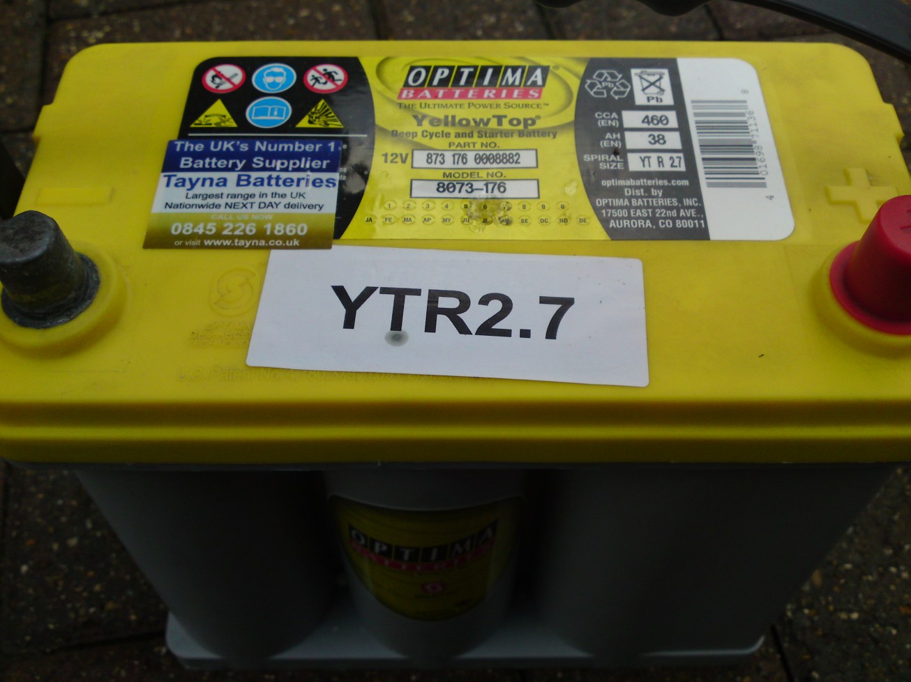

I've actually gone for an Optima battery - the Yellow Top D51R with reversed terminals, which is the same physical size as the standard battery.
see http://www.tayna.co.uk/Optima-Yellow-Top-P3802.html
Googling, you'll find lots of material about Optima batteries - they're made by a Swedish company, with their original application being motorsport. The only one that fits the MR2 Roadster is a 'deep cycle' Yellow top battery. Deep cycle batteries normally aren't used for road cars as they don't provide the starting current needed- but the Optima's construction and the use of glass matting and spiral wound cells means it has exceptionally low internal resistance and is able to provide the high current needed to crank a cold engine - its capacity is a massive 460CCA.
I noted top end Bosch batteries are also offering batteries on this technology for applications other than MR2s - their price is around £130-150.
Cost of the Optima is £175 delivered - not cheap - but I'm looking forwards to getting it fitted into the '2 this weekend and with the big improvement in the cold cranking capacity hopefully should sort the problems I've been seeing with the Profec controller's screen.

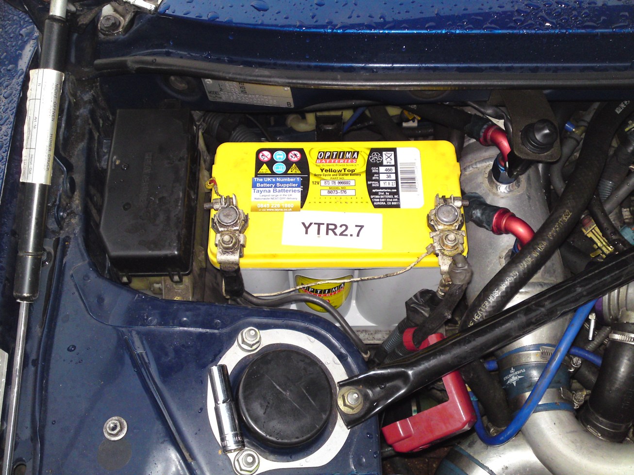

I've fitted the Optima battery earlier - and I am well chuffed, the car starts easily from cold and even better it has sorted out the screen corruption on the boost controller - something I was hoping for, but I was expecting to have to do work in other areas too.
But, as I suspected, it turns out the old battery wasn't able to crank the engine and keep the voltage up for the boost controller, which was causing the corruption. Doing a quick unscientific test, with the interior light on, starting the engine the light doesn't dim or flicker at all.
Swapping the battery was a straightforward swap and refit - one thing to note :
- the Optifit battery had slightly recessed terminals - the Optima's are 'proud' on top, so there's a little extra stretch required from the cables to get there, but no problems with that. There's also no problem with problem with clearance with the engine lid above.

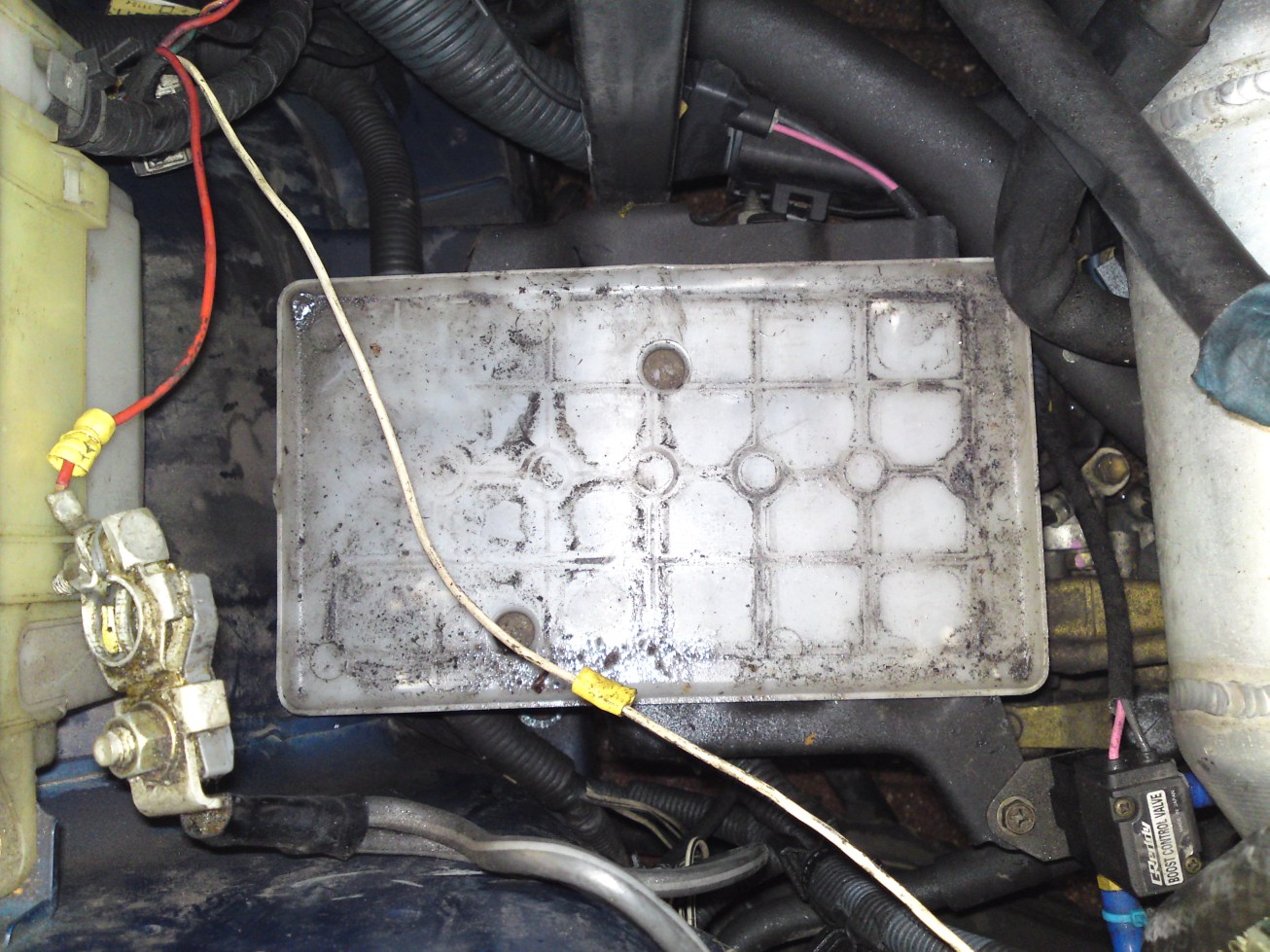

The Original battery installed in the car - note the black ( rather than green ) sightglass showing the battery isn't 100% OK
And out of the car - it looks like the spec for CCA is only 175 (!?) Not surprising the car was struggling when the sight window says the battery wasn't 100% OK.

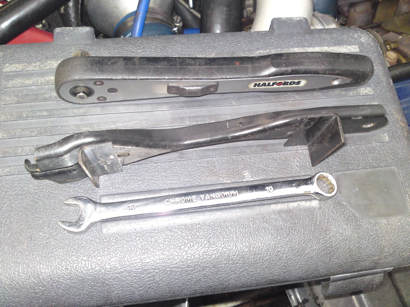

The Battery clamp that grabs either side of the 13mm battery - replacement was a direct fit replacement.
The Optima battery
And connected in the car.

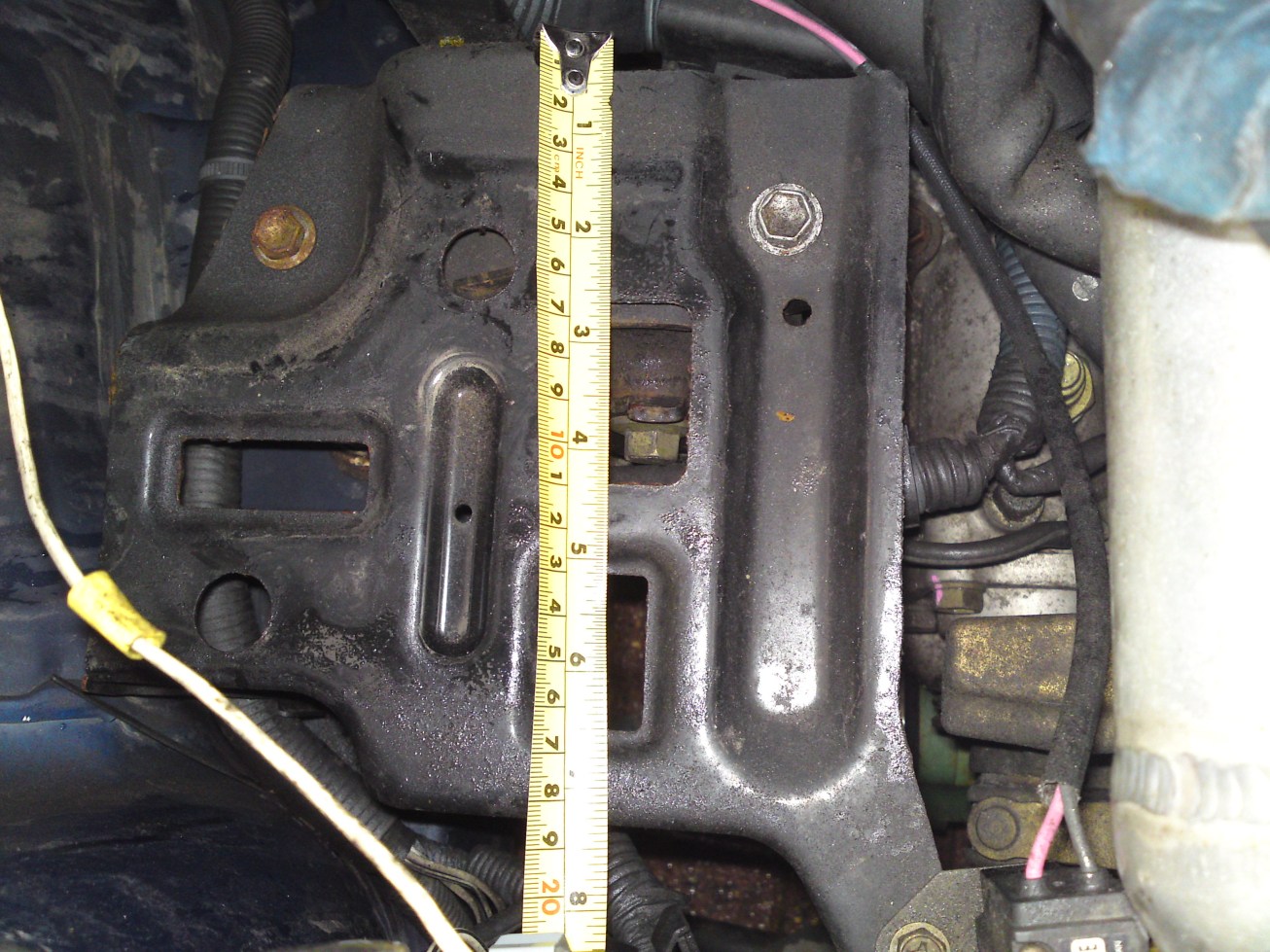

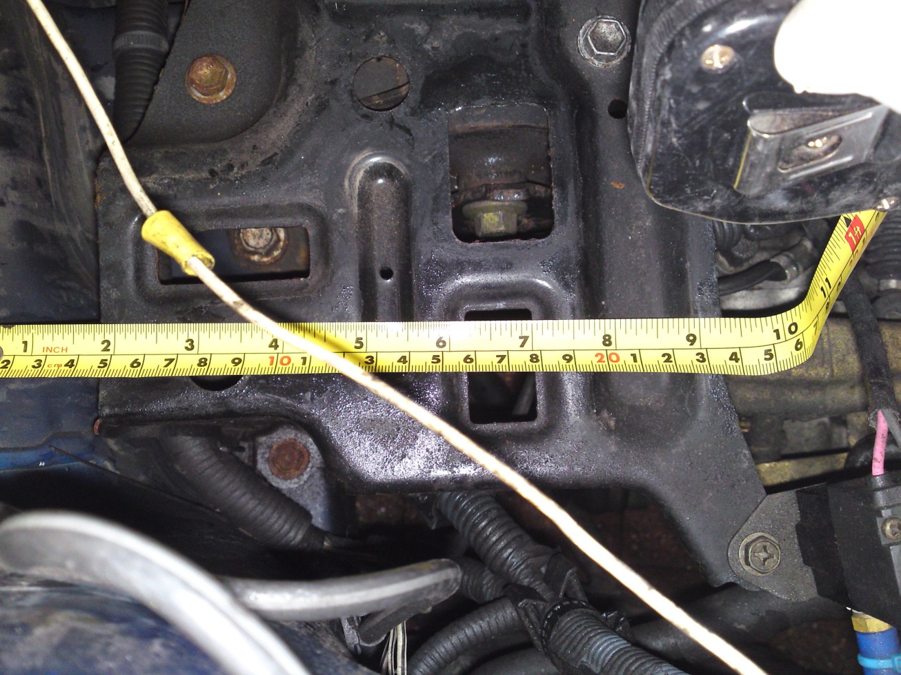

I also took some time to measure the space available, and I think you could get a 17cm wide by ~ 23-24 cm long battery into the space there.
the Battery tray : Image
Length :
Width : ( Note slightly diagonal, but 170 mm seems possible
