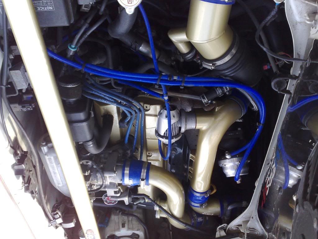

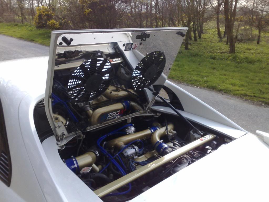

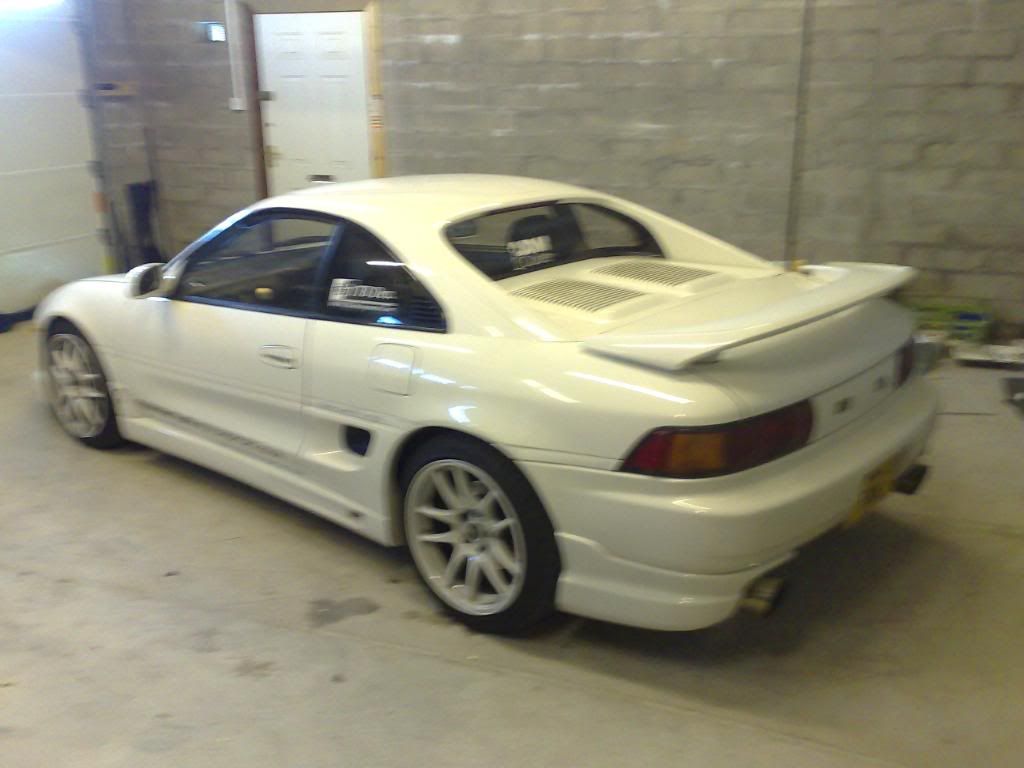

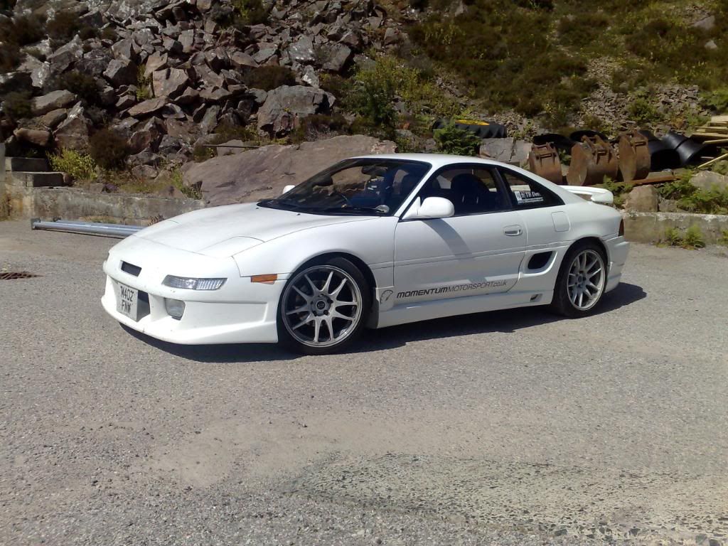

After 3 red Mr2 turbos i not just fancied a colour change but was looking for a car with a lot of my desired mods already done, i just couldn't comprehend the huge money loss of getting my current car up to my desired spec :cry:
so here's my new baby, needs a clean :oldtongue:
more pics here>>>
http://www.imoc.co.uk/forums/viewtopic. ... 08de49b77b
plan on getting the cylinder head redone and possibly a good chargecooler and then a remap, should be good for over 500 bhp, the colour is definately growing on me =P~

Verrrrrrrry nice :mrgreen: :thumleft:
Loving the looks of this car :wink: :thumleft:
What wheels and size are they?They do look good i must say :thumleft:

rota torque 17x8 front and 17x9 rear, i think :-k

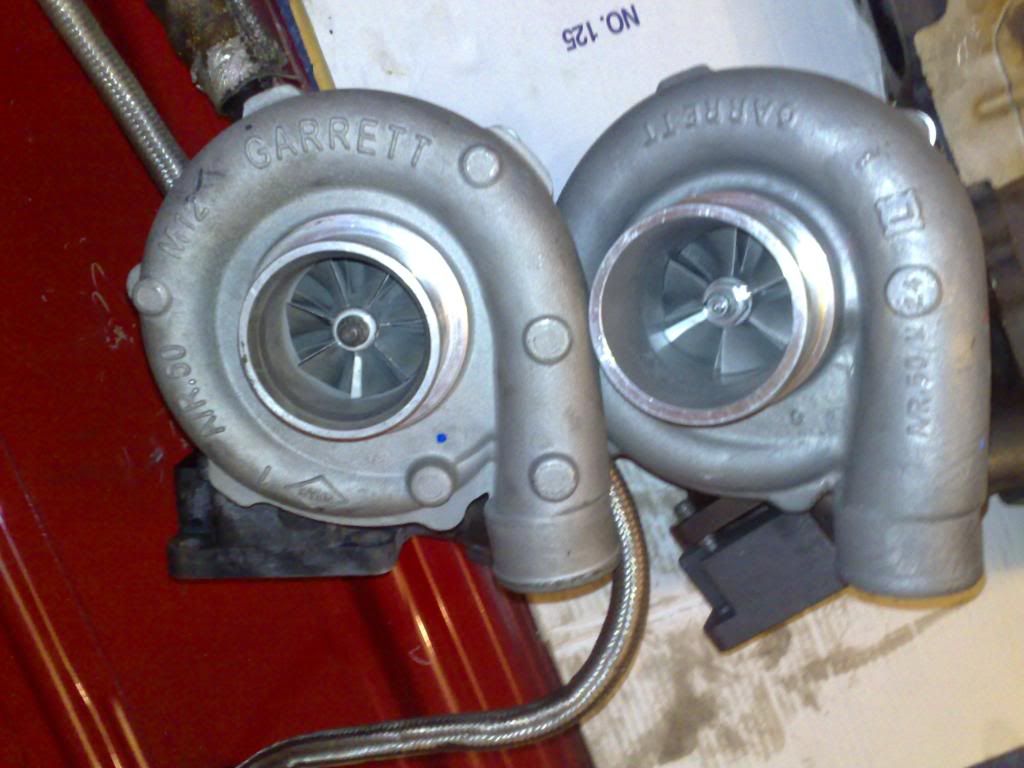

cheers, slight change of plans so i will be putting the chargecooler on hold, i was sold the car under false pretences about its power and the turbo it was running,
it has a t28 footprint which makes it a very unsuitable turbo for my requirements and i am now needing to spend 2k on the right turbo, bit peed off :twisted:

it is but it is the -wg version which has a t28 footprint (whatever that means) , is only good for 350-370 bhp (max) and i am needing a turbo that is capable of at least 450 bhp...

They are the same alloys as mine. Beware the centre caps come off really easy. Lost one already :(

Thats weird, the 200sx boys have T28 footprint, and they run 350bhp on GT28RSs with internal wastegates, even more with GT30.
Is it causing boost creep with the internal WG then? What about getting it ported?
Let me know if you sell the T28 manifold etc, as I fancy a GT28RS.

it was mapped on 97 ron, my info about 370 ish bhp was from the supplier of the turbo kit, could be different, i don't know....
i will be selling the kit in a few weeks but i think i am going to sell it with the turbo rather than seperately,
sorry dude
it has an external wastegate and screamer, not internal :wink:

Ok cool. so whats stopping it being ok for 400bhp then? a Gt30 should do that fine.

it has something to do with the turbos footprint, i have tried to find out exactly why and was told i needed a t3 footprint,
i listened to the advice i was given and paid the pricely sum of £2000 last week for a turbo that will be suitable for between 450 bhp and 520 bhp depending on which A/R i fit...
it is still a nice turbo i have but the A/R makes for a turbo that is more suited to high revs i.e. 4500 revs plus
i have gone for a gt3076 .63 so should have higher boost at lower revs but still get around my desired 450ish bhp
