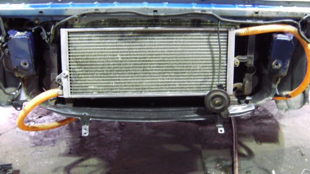

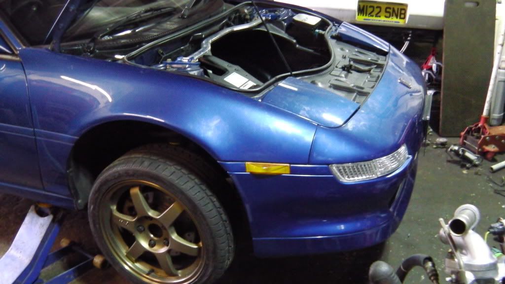

Day 2 kicked off with running the hoses to the pre rad
Th current state at the bum end of the car

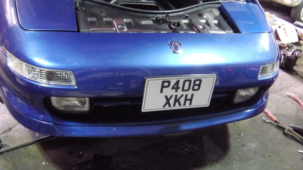

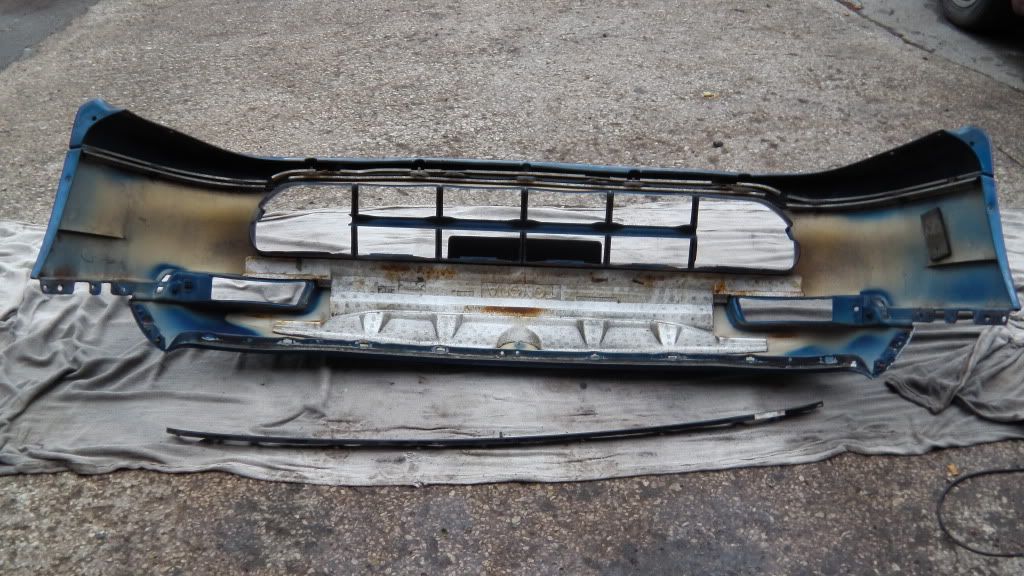

Bumper bar back on, after a bit of a tidy up

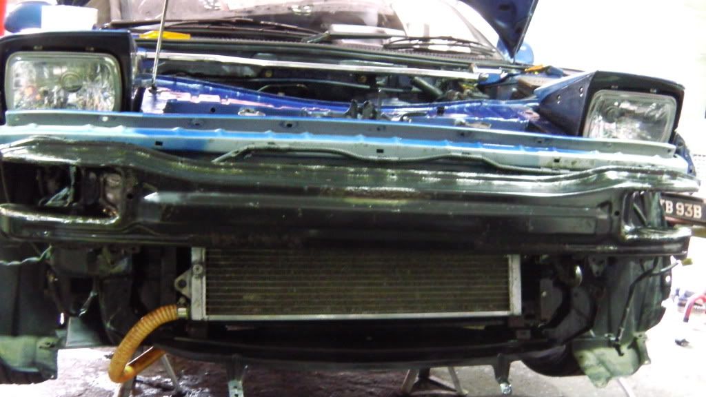

Half the bolts broke when removing the bumper, so they had to be dealt with
Bumper back on

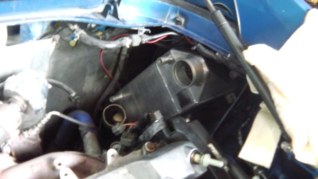

The chargecooler core could now be mounted. Much easier than fitting an IC, but still a fighter :shock:

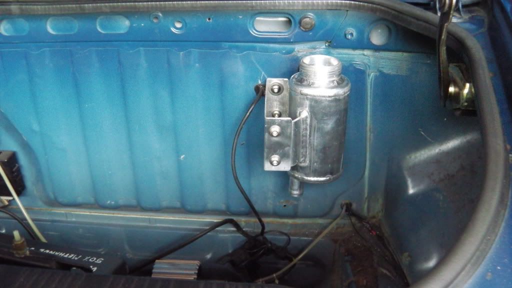

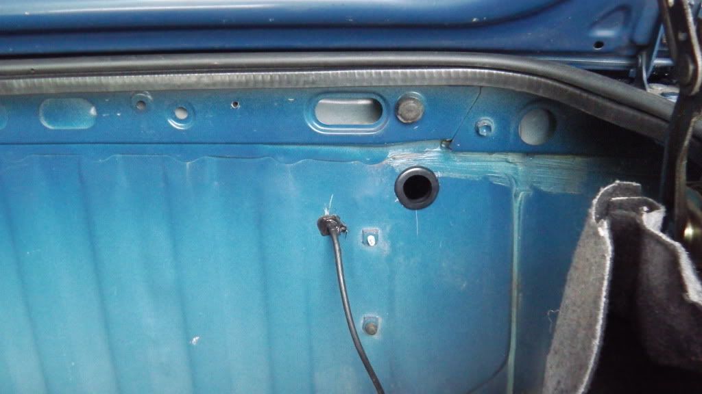

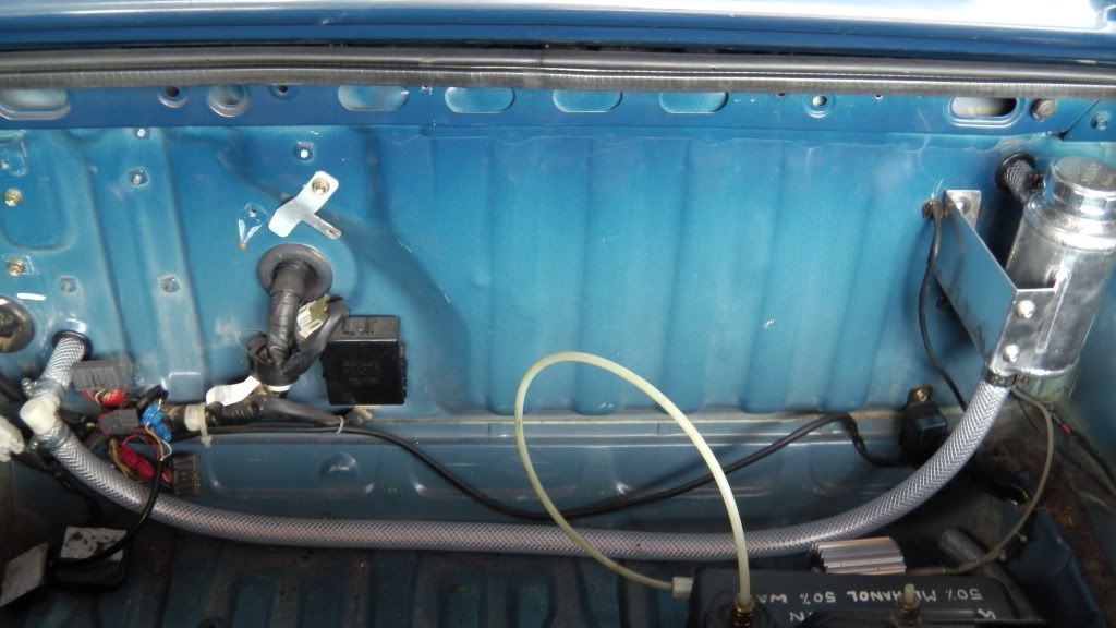

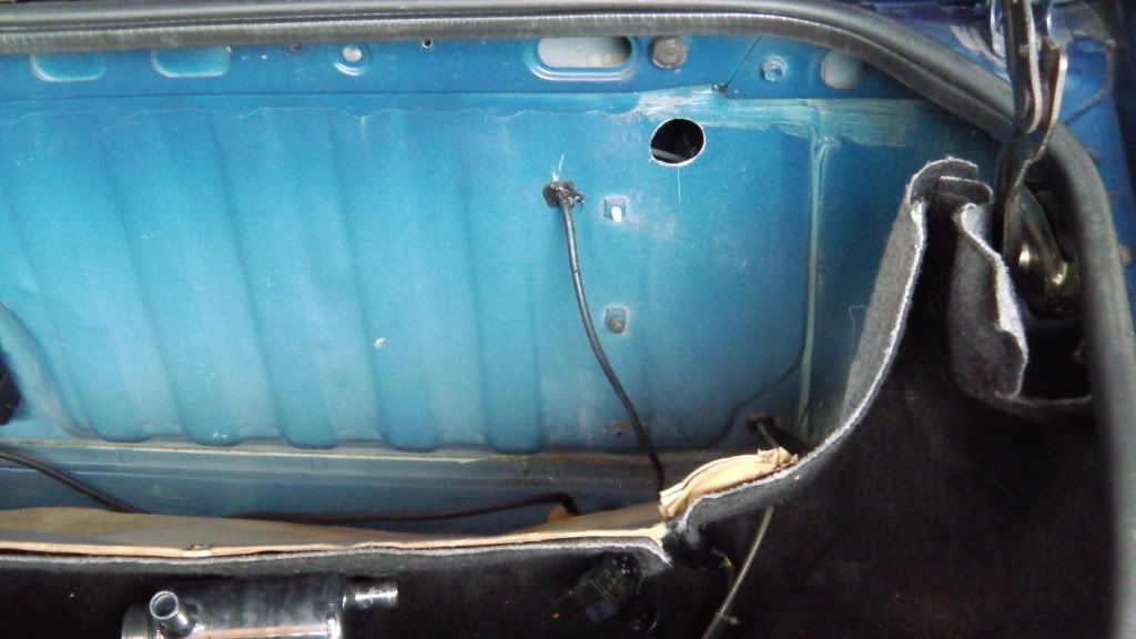

The swirl pot was being mounted in the boot, so holes for the hoses had to be cut and grommets fitted

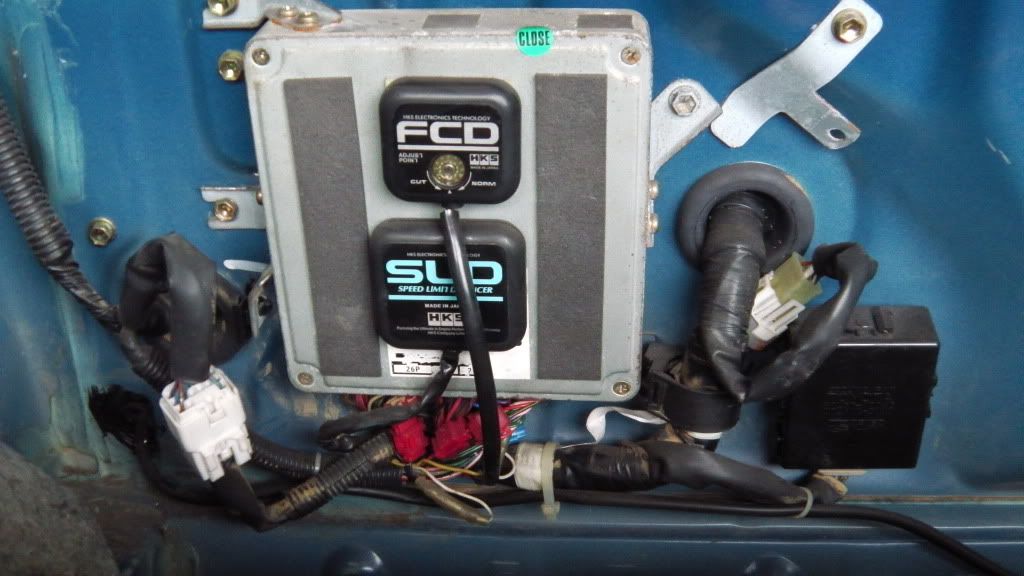

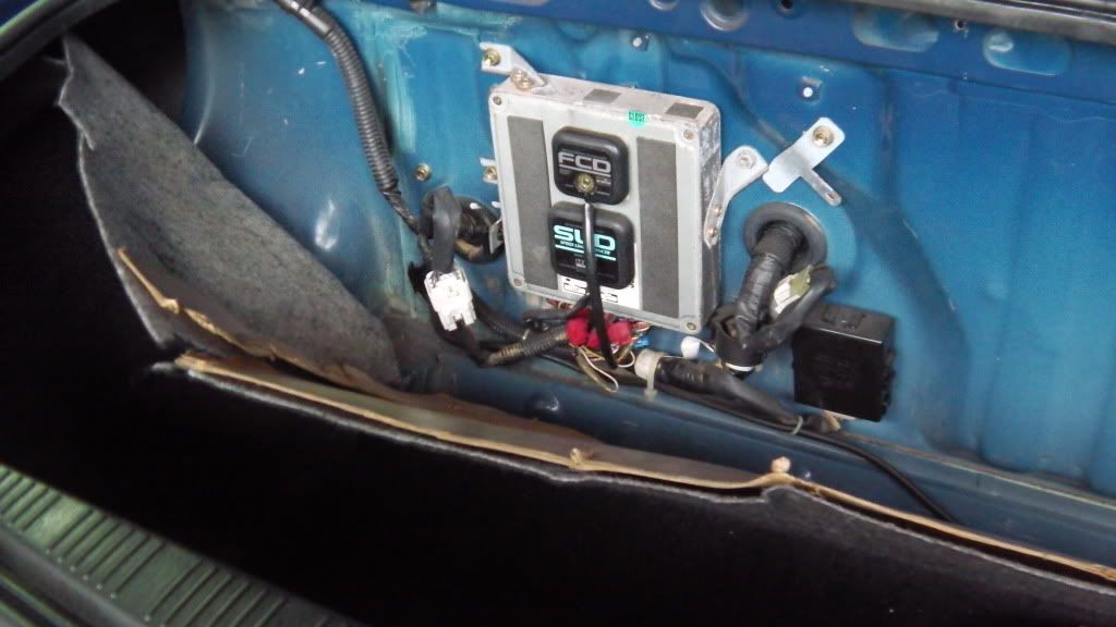

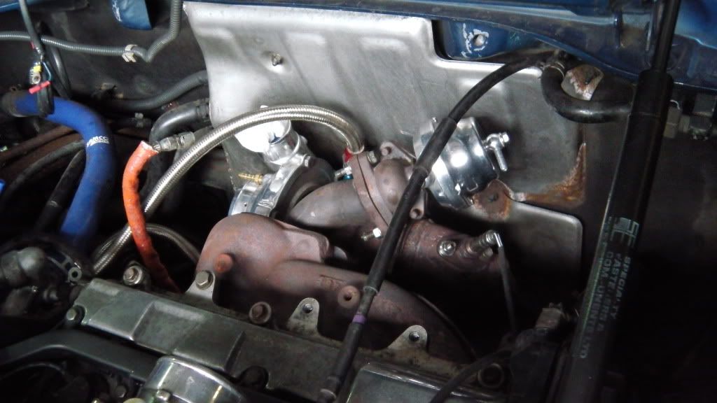

Standard ECU, with a couple of HKS bolt-ons (SLD and FCD)
Starting to plumb in the CC core

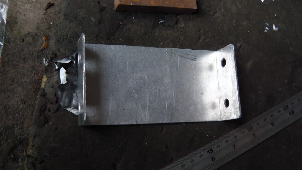

The bracket we fabbed for mounting the swirl pot

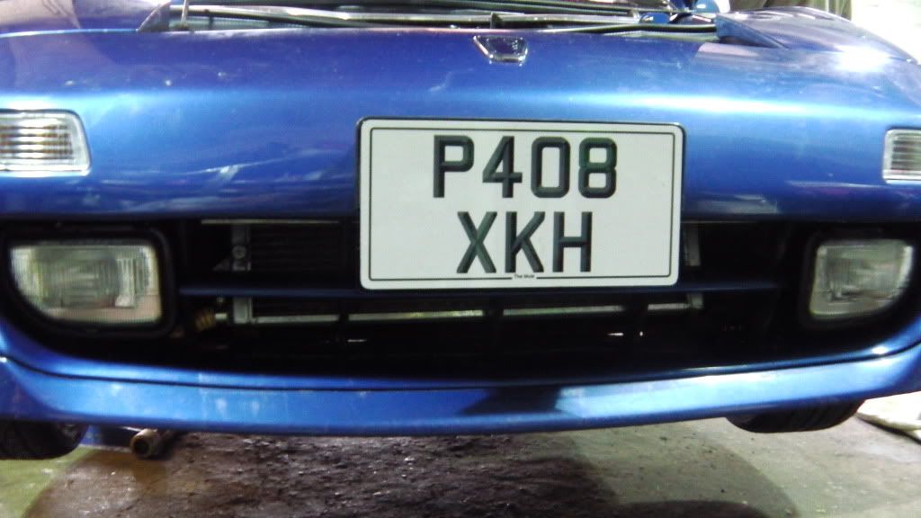

Front end fully assembled

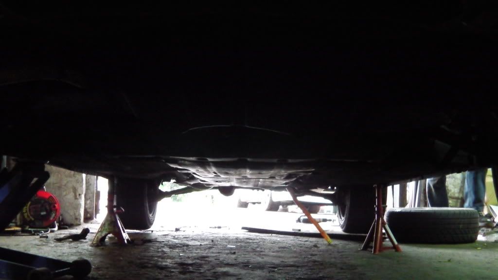

Under trays back on. Not a job I'd rush to do again :shock:
Front end back on the ground \:D/

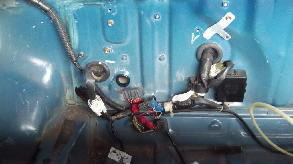

Hole and grommet on the other side

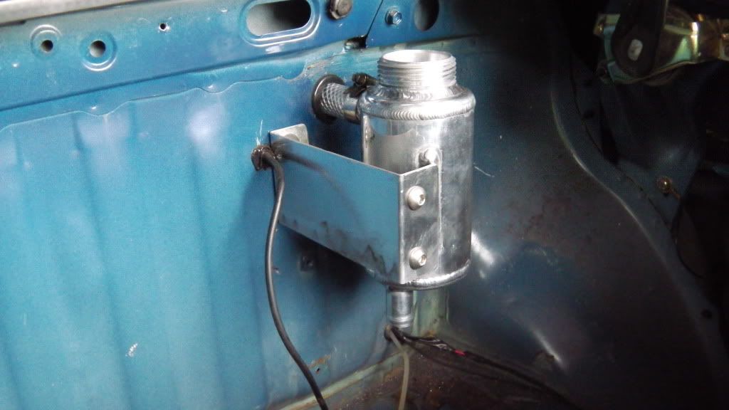

Swirl pot mounted. Needs a polish again :whistle:

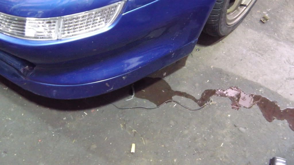

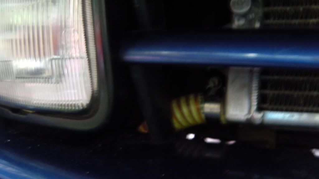

Bleeding was going fairly well, until Peter spotted the car had had an accident at the front end #-o

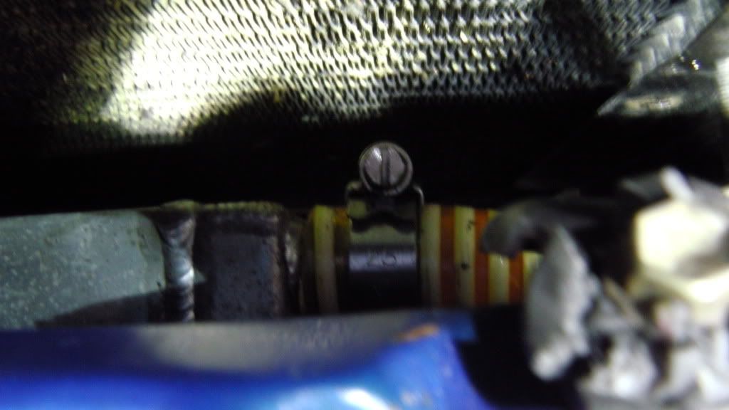

Both joints were leaking. My fault for not checking them properly #-o
The left side was an easy fix, as it was accessible from the front
The right was was more tricky, however luckily I managed to access the clamp front the top of the frunk (over the rad) and rotate the clamp before adjusting it

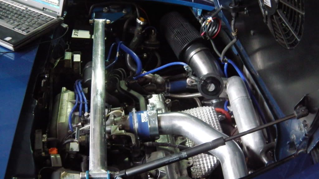

CC was bled, everything installed, wired in etc etc, time for the first fire up :D
It lives!
The idle was high, due to the existing map from Rob's car
All done. Well, for now.. :wink:

I notice you conveniently left out the picture of the boot carpet where you'd attempted to cut the holes for the swirl pot fixings and hoses :wink: :lol:
You and Peter are like a couple of housewives, with all your gossiping :lol:
It got to the time of day when my hands didn't listen to the brain, which ends in carpet with non-round holes in :lol: Even worse was that fact I was doing fully aware I wanted to take the carpet out altogether :-k #-o
