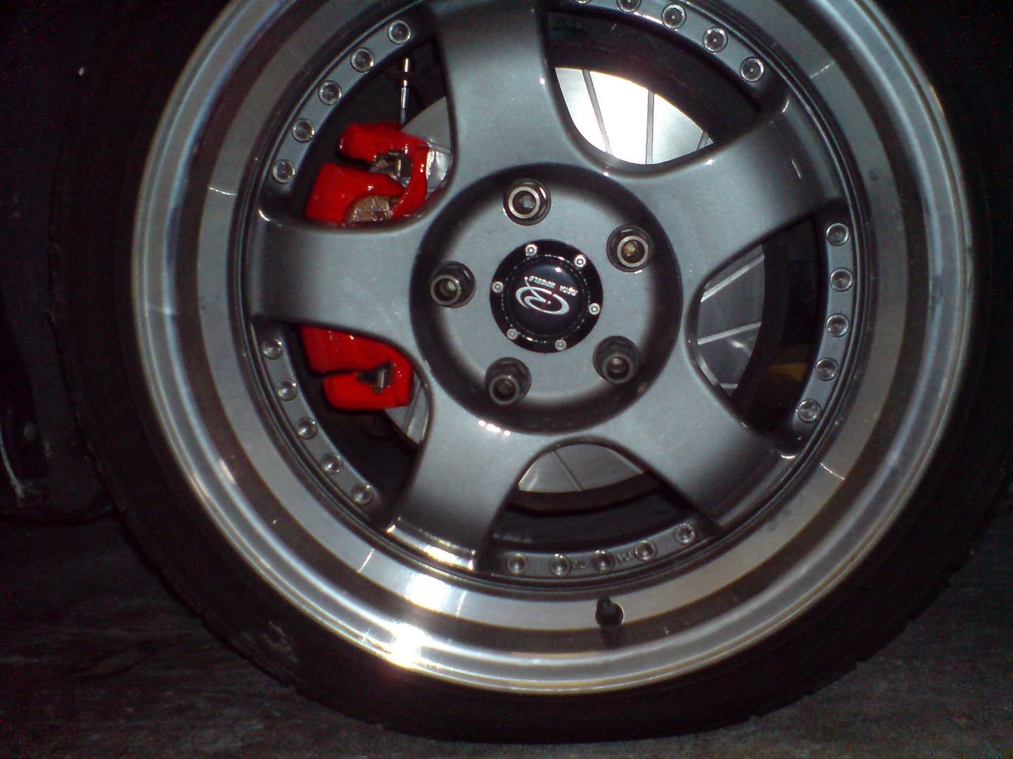

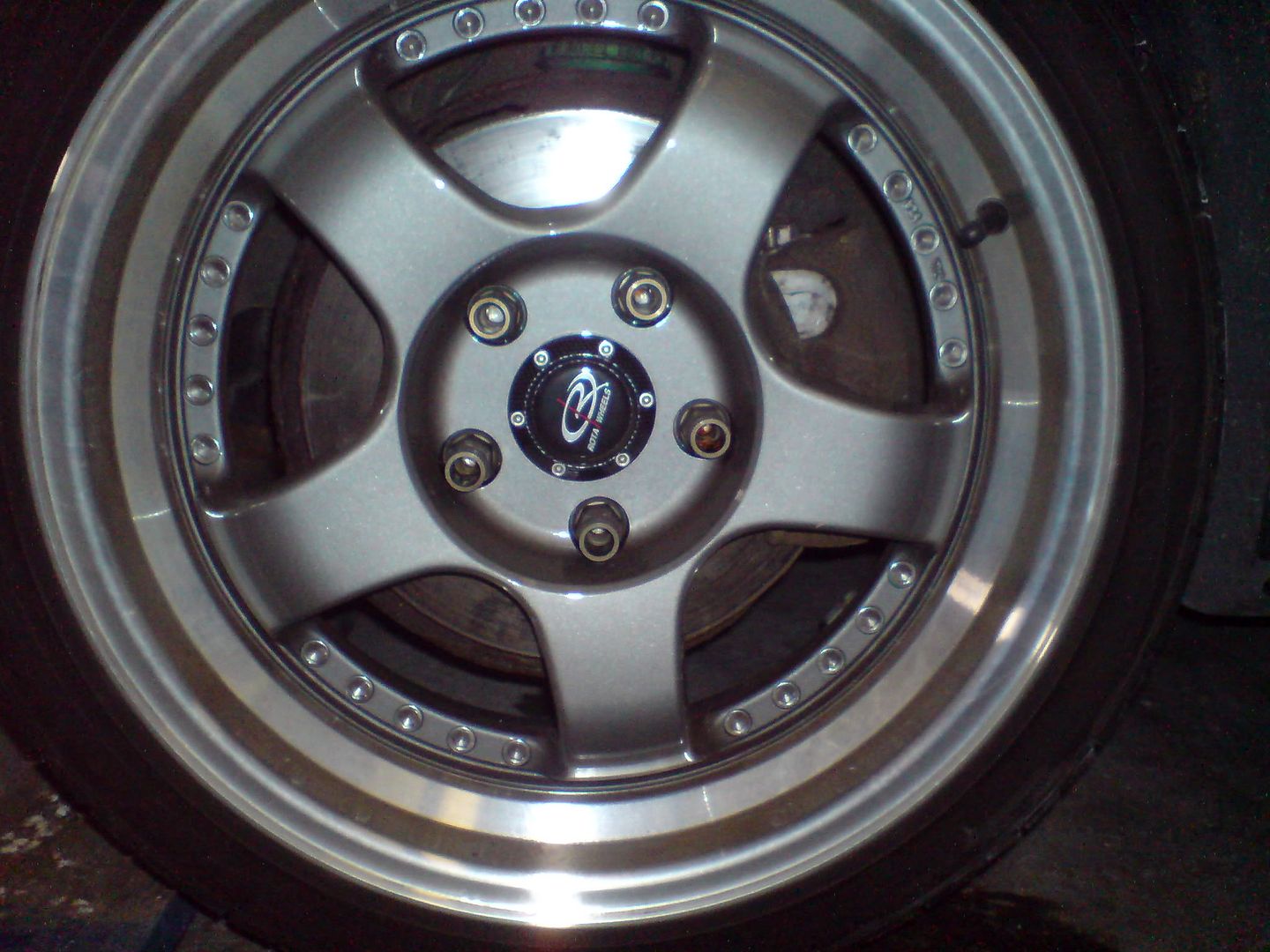

been uprating my brakes for the next trackday on april 12th :thumleft:
grooved discs .carbotech pads ,goodridge lines fresh dot5.1 fluid ,new rear calipers , and cleaned and checked fronts which were ok .
also painted the calipers whilst they were off
and i raised the tein coilovers by 10mm all round as the rears were scuffing out over bumps :evil:
before
afterImage

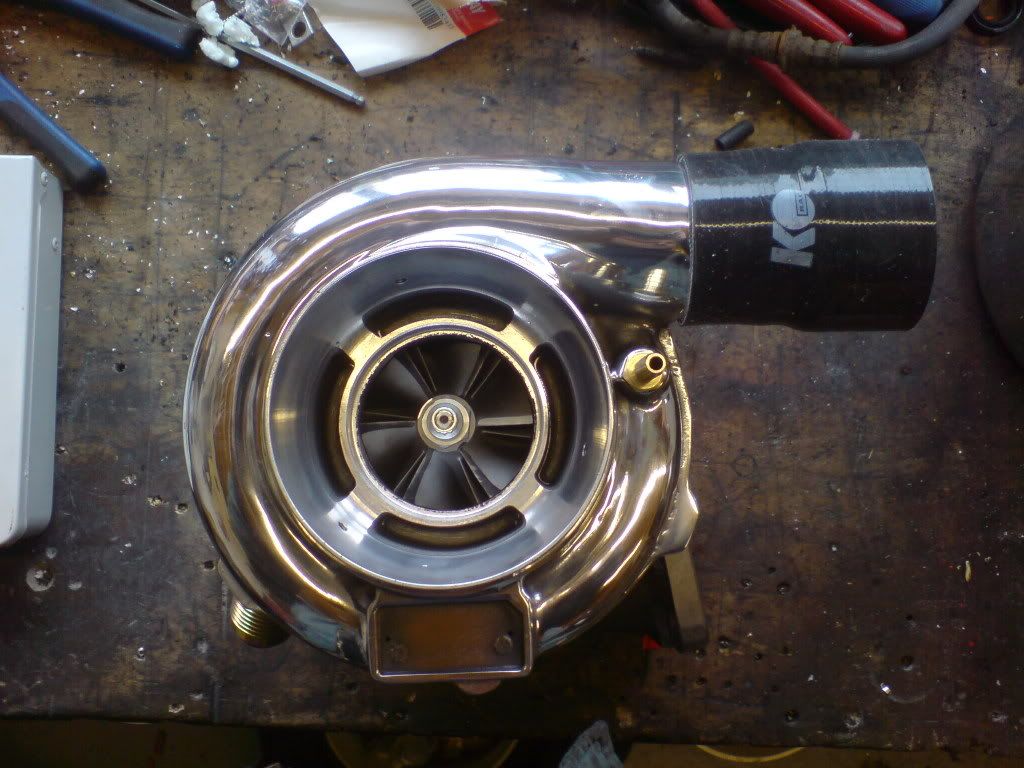

New turbo arrived today \:D/ gt3076 woo hoo
heres a quick piccy :thumleft:
and a pic of my current/old t3/t4 for comparison

Finally !! \:D/ Im looking forward to this now
You're going to upset some a few owners at marham mate with this little beut 8) Although their are a few special ones that i have mapped pushing over 600bhp going :mrgreen:
My poor little 1.1 is not going to stand a chance though :(

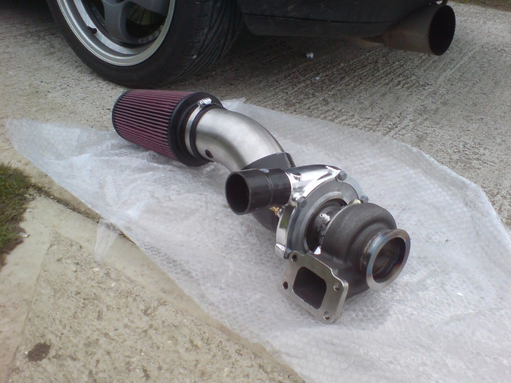

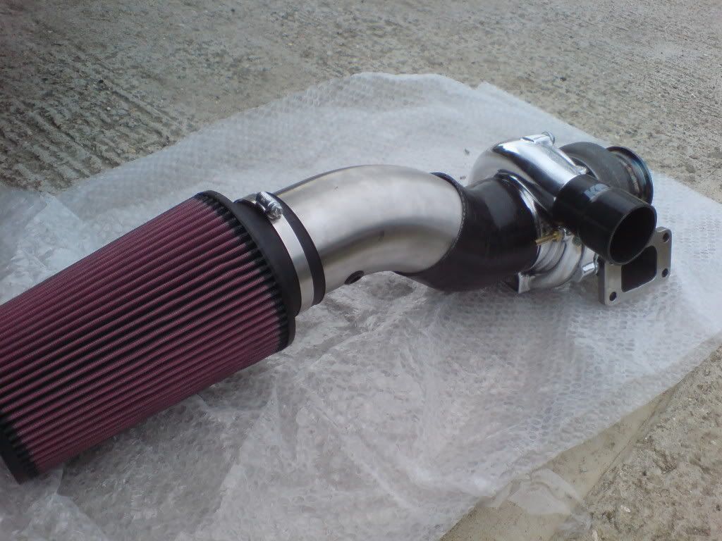

heres some pictures of my huge koracing 4" intake :twisted: \:D/
its not on the car yet though :( didn't get the time this weekend ](*,)

holy mother of Mary mate!!! :shock: :shock: :shock:
thats huuuuuuuuuge!!!
cant believe i cant make Marham this month, hope you get some decent runs in mate!
