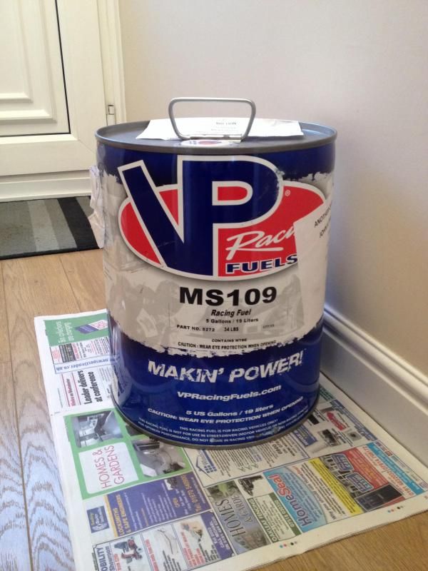

Bought some go go juice for the RR Day.
Craig

i wouldn't map it on race fuel unless you're gonna run it on race fuel mate :thumleft:

sheppy wrote:i wouldn't map it on race fuel unless you're gonna run it on race fuel mate :thumleft:
Hi Sheppy,
2 is being maped on V-Power mate.. I coulnt afford to run it on race fuel at £7.33 a litre lol!.
Race fuel is just going to be used as a little helping hand for the rr figures.
Craig
ashley
Posts: 7628
Re: REV 1 GT - @ Back Home
Post by ashley »
Let me understand what you're saying: you're going to map it on v power.
Then you're going to stick some race fuel in and run on the same map to try for a nice dyno graph?
I don't think you'll make more power on race fuel unless you map for it, but if you map for it you won't have a safe map for v-power :eye:

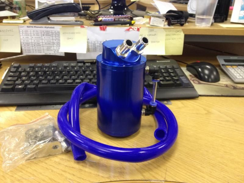

Just ordered an oil catch tank and Greddy RS BOV (Adjustable).
Cheers Craig

Post by CRAIGROBBO »
Catch tank arrived...
Craig

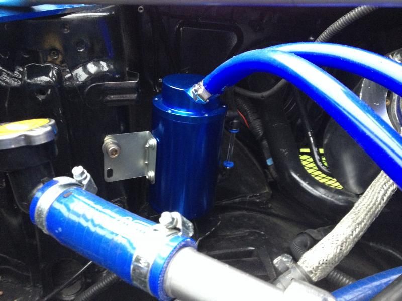

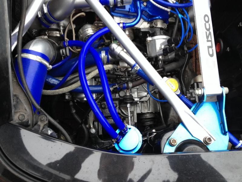

Well thats the catch tank fitted..
Craig

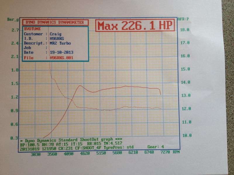

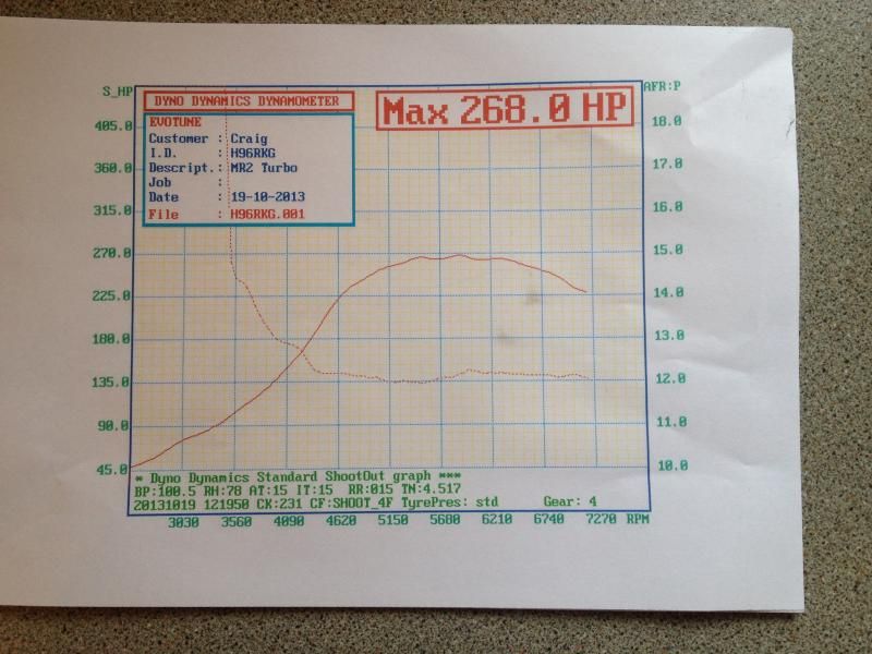

Hi All,
Just got back from the RR session, Pretty disappointed to say the least.
The guy seams to think we have a fueling issue with the map hence the very poor results below.
Low Boost
High Boost
As you can see we're making less HP than standard on low boost and maybes 28hp more than standard on high boost!
To make it worse there was a Celica GT4 running standard ECU with the same turbo and made 338HP.
Comments welcome!!
Craig

CRAIGROBBO wrote:
Is the C20B normally that laggy (genuine question, I don't know)? I thought you'd be making full boost much lower in the rev range, you're not hitting peak boost until ~4.5k.
I'm totally guessing, but maybe an actuator problem (not closing fully or something), and you're losing exhaust manifold pressure?
When would you expect your set up to make peak boost, and what sort of power were you expecting? Does seem low for that much boost...

Hi Ashley,
Well based on that boost pressure 300hp should be within grasps.
We did think an actuator issue but it seams to hold boost ok.
The car is running way too lean! Very lumpy tick over and lumpy until 2K rpm. Going to have the map tweaked again and see what happens.
If we get the same results or similar the forge actuator will be getting replaced!.
