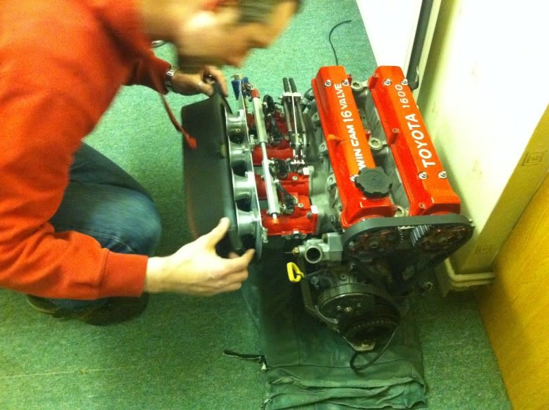

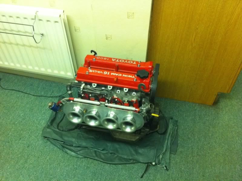

A tense week for me, worrying if we'd get gazumped on this engine, seeing as we forgot to leave a deposit on it and bigmouth (aw11rally, old buddy, old pal) told eeeeeeeeeveryone here all about the engine.
But now it's safely stashed away in my nice warm kitchen, just opposite the fridge. Quietly seeping oil & petrol onto the carpet. Ahhhh. Queue many long cold nights on a concrete garage floor, in Winter, fitting it into the car. Much coffee, beer, swearing, mirth and Chinese takeaways to follow.
MartG
Posts: 6029
Re: Rally Car
Post by MartG »
aw11rally
Posts: 763
Joined: Wed Dec 31, 2008 12:46 am
Re: Rally Car
Post by aw11rally »
Not much to say really, looks nice though. The engine that is, not the cogster.
MartG
Posts: 6029
Re: Rally Car
Post by MartG »
Looks good :thumleft:

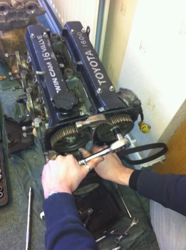

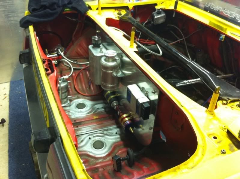

101 uses for a claw hammer: in the absence of the correct tool to lock the cams (in order to remove the back plate for the cambelt cover) a hammer makes a handy substitute.

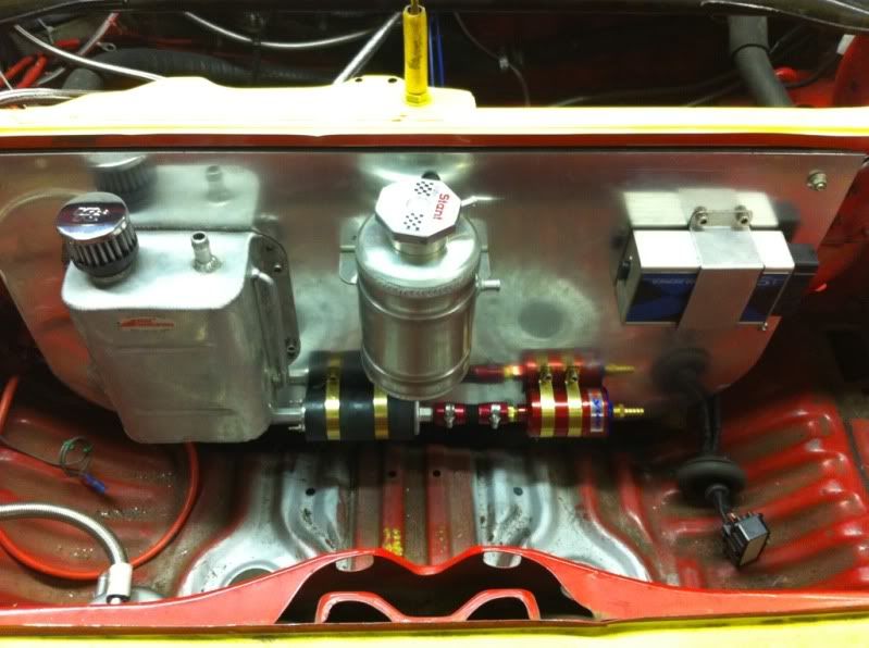

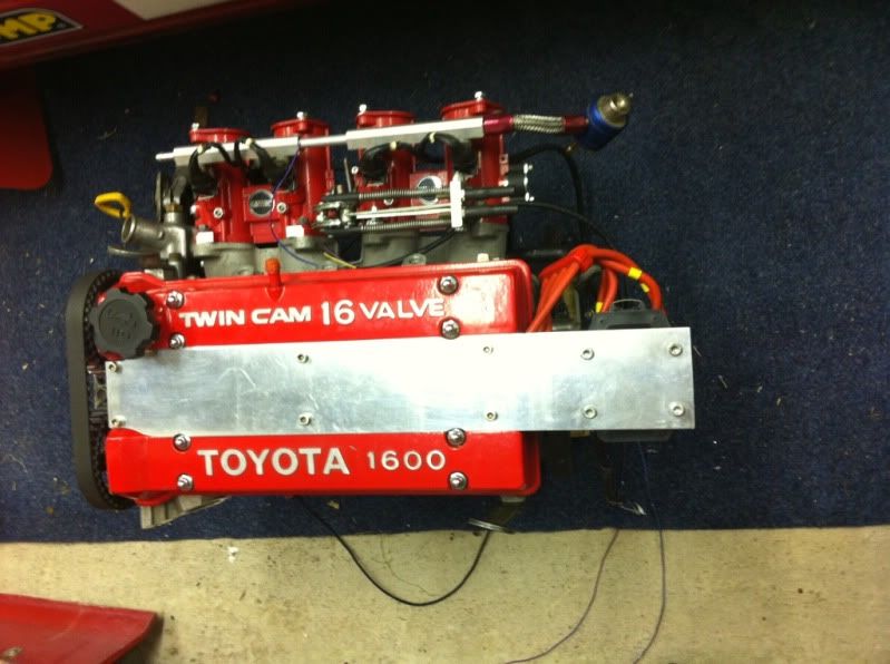

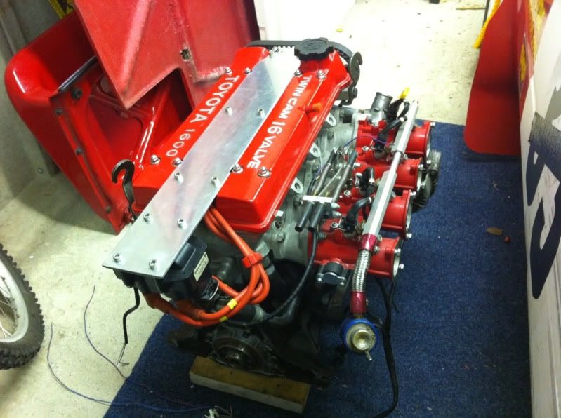

New plug valley cover. Made from 5mm aluminium with chamfered edges so we can RTV the edge between the plate and the cam covers, preventing water from getting into the plug valley. Also mounts the coil pack.
Mounting plate for the oil catch tank, coolant header tank, OMEX ecu, high pressure fuel pump & filter. Also 5mm ally. All holes tapped so that the hardware bolts directly to the plate without having to faff around behind it trying to fit nuts. Hiding in the left corner of the boot are the low pressure fuel pump (Facet Red Top) and the swirl pot.
MartG
Posts: 6029
Re: Rally Car
Post by MartG »
What, no dry sump tank ? :clown:
cogboy
Posts: 81
Joined: Thu Dec 24, 2009 11:08 am
Location: Cheshire
Re: Rally Car
Post by cogboy »
Oh God, don't encourage him (aw11rally). That's his next plan. It's taken me two days graft to make the templates and final ally plates for these bits. Would have been easier with a milling machine, but I had to make do with an angle grinder and some flap discs.
