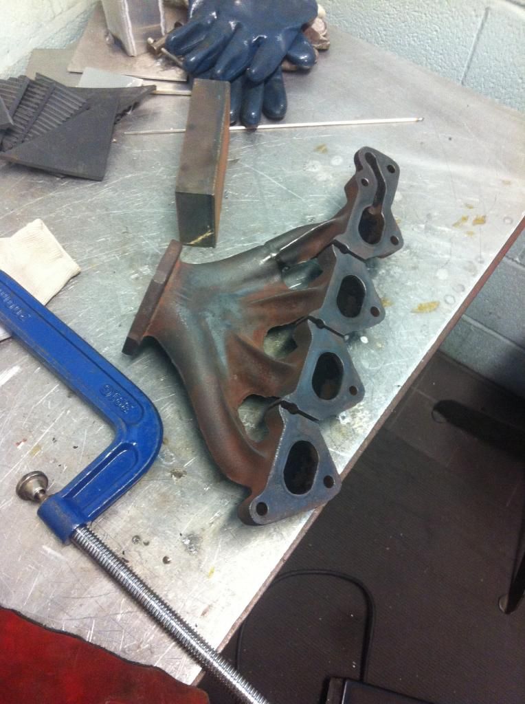

I'm a welder, I reckon a couple of 1 inch welds will hold for the duration, you can hang 1 tonne off a 1 inch weld

dylan5084 wrote:I'm a welder, I reckon a couple of 1 inch welds will hold for the duration, you can hang 1 tonne off a 1 inch weld
I didn't say they weren't strong. My concern was about cracking them through expansion and contraction. But, like I said, I'm not an expert on welding :thumleft:

Depends on how nicely it welds to be honest, I'd imagine it would be made from some sort of cast steel, should be ok with flux cored mig wire, and should be able to grind it back to original, if needed later to sell Or return to standard.

dylan5084 wrote:Depends on how nicely it welds to be honest, I'd imagine it would be made from some sort of cast steel, should be ok with flux cored mig wire, and should be able to grind it back to original, if needed later to sell Or return to standard.
That garage who did mine removed the flap entirely and welded solid the wastegate hole and the hole for the flap. It's never going back! #-o

shinny wrote:Pretty much agree, and you make some good points about EWG being better than IWG. However you lost me here:
Rob - East Coast Imports wrote:having the valve open, or anywhere other than shut will delay the boost building, cause your turbo to work harder to produce the same amount of boost (and therefore you'll have hotter charge temps)
Surely less exhaust gas going through the turbine means you get less boost? Not that the turbo somehow works harder to produce the same amount of boost off less exhaust gas. In fact slowly building boost must work the turbo less hard (it's doing less work at the end of the day) but it's sub-optimal for performance.
absolutely.. sorry I was talking b0ll0cks, can I blame being tired? for some reason I was thinking boost leak, but yes, you're right.
as for welding cast iron.. it's easy, as long as it's a good casting. make sure it's clean, heat it up in a rod oven, use a proper rod for cast and then allow it to cool slowly by putting it back in the oven overnight.
or, knock all the coating off the cast iron rod and use it as a filler rod to Tig it up, although there's little difference in the outcome
that manifold was cracked 360 degrees, vee'd out nice and deep and tigged up, was still going strong when the car was scrapped.

is it defo cast iron? It looks like cast steel to me, I'll be able to tell when I hit it with a grinder, unless someone actually knows for sure?

dylan5084 wrote:is it defo cast iron? It looks like cast steel to me, I'll be able to tell when I hit it with a grinder, unless someone actually knows for sure?
cast iron :thumleft:

dylan5084 wrote:So I had sneaking suspisions that My manifold had cracked, so I've took off the heat wrap, some of the heat wrap had turned into glass... Pretty hot! and yep it is cracked so I'll defo take your manifold mate
means I can cut off the flange of both and weld my one into the other without feeling like I've wasted money that could have been recouped from selling the old manifold
Just won A tial wastegate on eBay too so it seals the deal for me :thumleft:
I'll weld the old one just now so I can still use the car, as the crack is accessible from to top anyway
Heat wrapped manifold will give problems with cracking, it will also be the cause of your over boost problems.
No need to do anything with the stock waste gate, it can be run with the external one as long as you feed the same boost signal from the manifold to both.
Right, so I'd be better not wrapping the next one? Was thinking I could put a blanket over it.
So to send the same signal to both gates, would just require a T piece and some vac lines?

dylan5084 wrote:So to send the same signal to both gates, would just require a T piece and some vac lines?
I've only just gone twin gated but yes, a T-piece was all that was required. I tried to ensure the two had similar spring pressures (which was tricky given I don't know the exact spring pressure on either of my EWGs) but I can report that the combination is holding boost better than I'd expected. I've not yet turned on boost control to increase the boost but I'm sure that'll be fine :thumleft:
