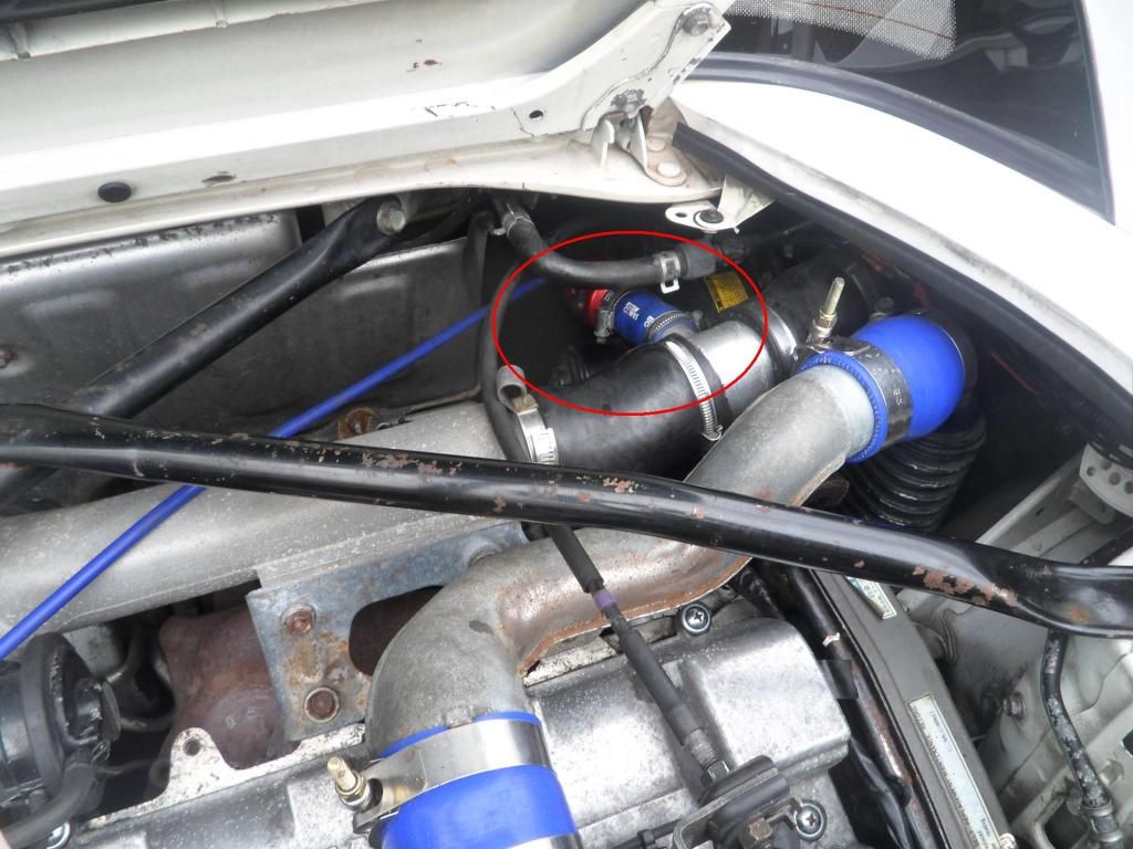

Bit of a update as been rooting under the car on my back on my drive snd later took it round to a mates and slung it on the 2 post lift.
Found a couple of things
1 was just a blowing exhaust from the cat/downpipe junction, someone had managed to shear of head of a bolt, managed to get a m10 nut on the broken thread and tighten up, also put some exhaust sealant paste on the gasket where it was leaking/ blowing from.
2. may well be my prob it seems the wastegate may be seized, how easily/freely do they move?
Noticed that the actuator arm at the wastegate end was showing at its base a section of rod which was shiny,(in other words looks like it was normally insode the wastegates case)
Managed to persuade it to go back into the waste gate but not sure if its working.
Car seems a bit better but still not 100% right.
Its like its got major turbo lag, its only when revs get to 5k that the turbo kicks in.
Here's a few pics.
I take it this vacuum actuator is the waste gate?
Does this look right?
heres another but i thought BOV usually went over near where ive put the circle in pic above, but in pic below you see its over nr intercooler.

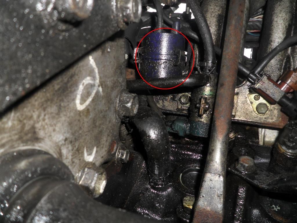

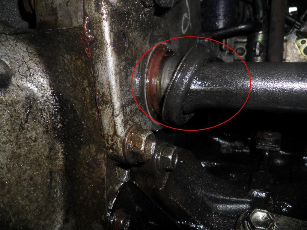

On another note whilst on the lift i found this cover loose on the drivers side drive shaft, what normally hold it in place?
and whats this blue thing?

Sounds like you have diagnosed the wastegate sticking on the downpipe .. never had this happen to me , guess you need to do some grinding on the downpipe so the wastegate can move freely ..

Blue thing im guessing is on the gearbox if so it's possibly the speedo drive, this a rev1 by any chance?
The metal cover thing is the driveshaft seal cover it's normally an interference fit with the driveshaft where it flares out just push it upto the seal and if it won't stay there hold it up and put a cable tie around the driveshaft behind it.

When you say waste gate rod/conector sticking on down pipe, your on about the rod from the actuator on the outside of the downpipe??? goes to a ball jointy hinge/ jointy thing.
Or are you saying there is something inside the downpipe thats sticking?
The rod from the actuator isnt touching anything i can see :?: :-s

The standard bov looks bypassed it need boost/vacuum to seal properly on boost .. its probably leaking too mate .
