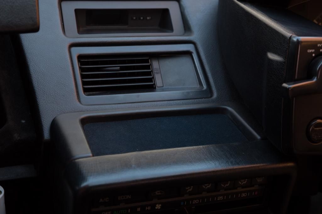

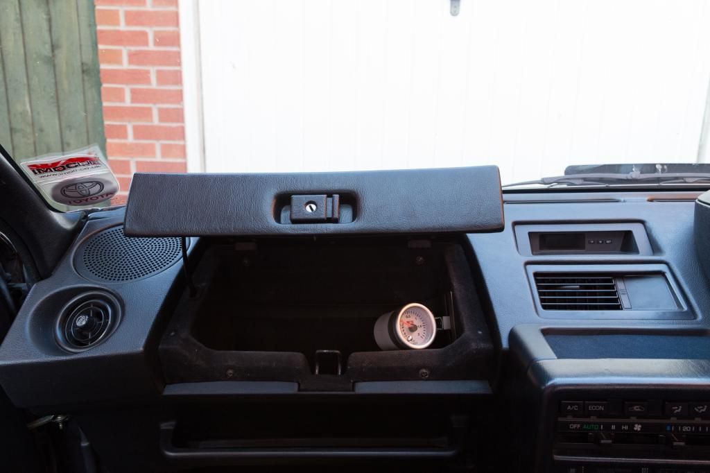

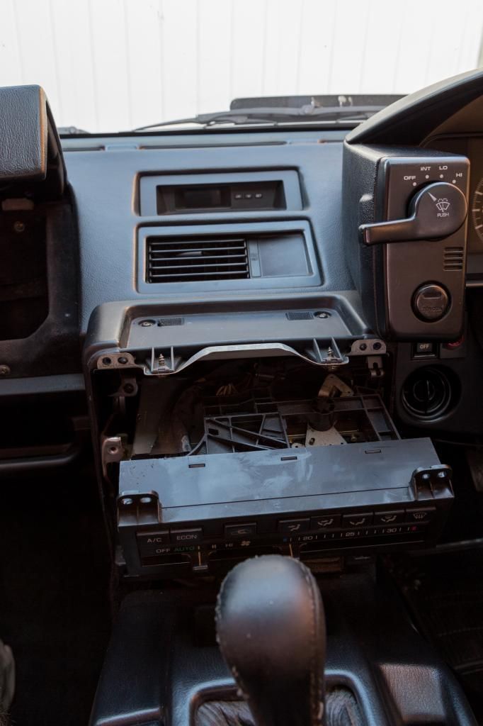

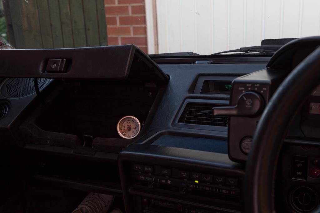

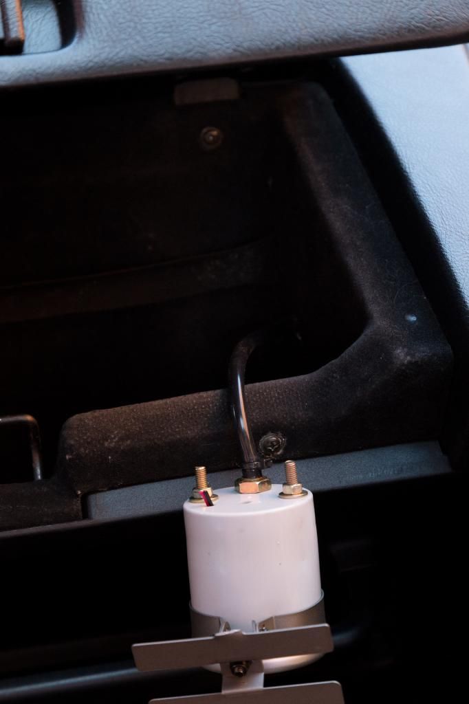

And so the inevitable happened, I started meddling... :whistle:

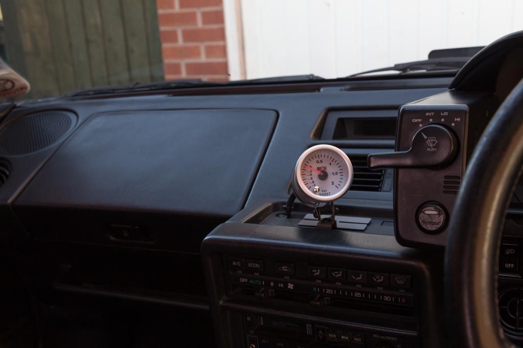

While I appreciate the importance of a boost gauge on a boosted car, I didn't feel the gauge's location was in keeping with our approach going forward. So I set about moving it...
It was sat on top of the dash, in the void where normal folk place and accumulate random stuff. Random stuff rattling around in cars is one of my pet hates so something had to give.

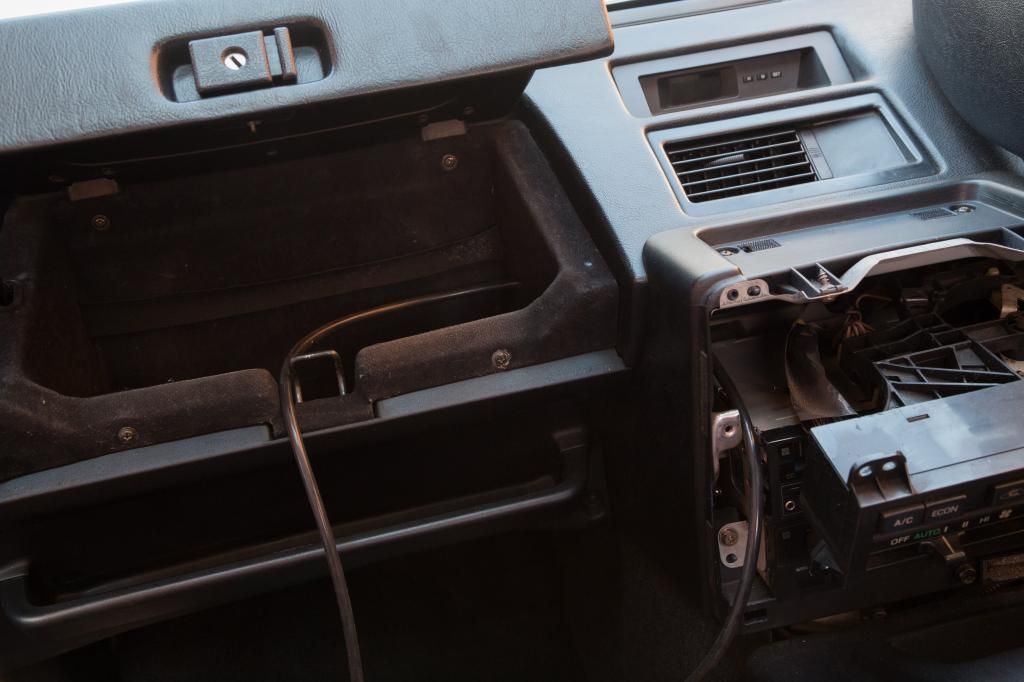

Off with the mount and time to seek out the hose.
Found, gauge removed and hose extended.
Hose cut to length, mount modded and ready for a test fit.
Test fit.
Original cover piece cleaned and popped back into it's true home.

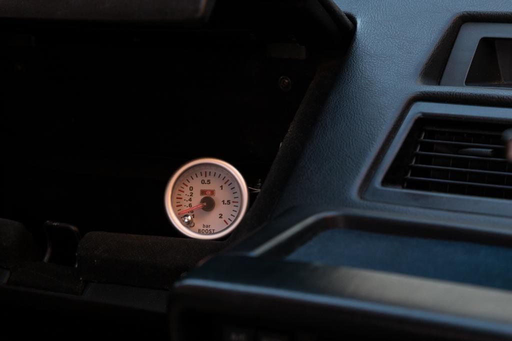

The results.
And it works! :wink:
I chose that location as the gauge is still clearly in eyesight and if needed the car can be driven with the glovebox open, allowing for whatever monitoring is needed. When not needed it can be closed and stealth mode resumed.
That's all, for now... :wink:

Poetic timing.. See above :wink:
That would do my head in, having to opening the glove box to view the boost gauge on the other side of the car.
Surely it would be better placed, with minimal distraction to the driver or taking eyes from the road? i.e. where it was..
Sounds to me like you got bored Phil. :lol:
Magic Beans
Posts: 4793
Post by Magic Beans »
RedMR² wrote:Sounds to me like you got bored Phil. :lol:
Far from it. In the real world who needs to sit and monitor their boost all the way through each journey, unless you've either made a change or suspect something isn't running as it should?

yep gotta agree with what you are saying.. it never "needs" to be there, but at least if you ever have a problem it is possible to monitor, good work
defo inkeeping with originality of the car

Nah, it was only a temporary placement there. I just got used to it! Plus, you don't get overboost problems with an SC like you would with a turbo.

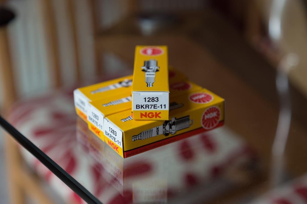

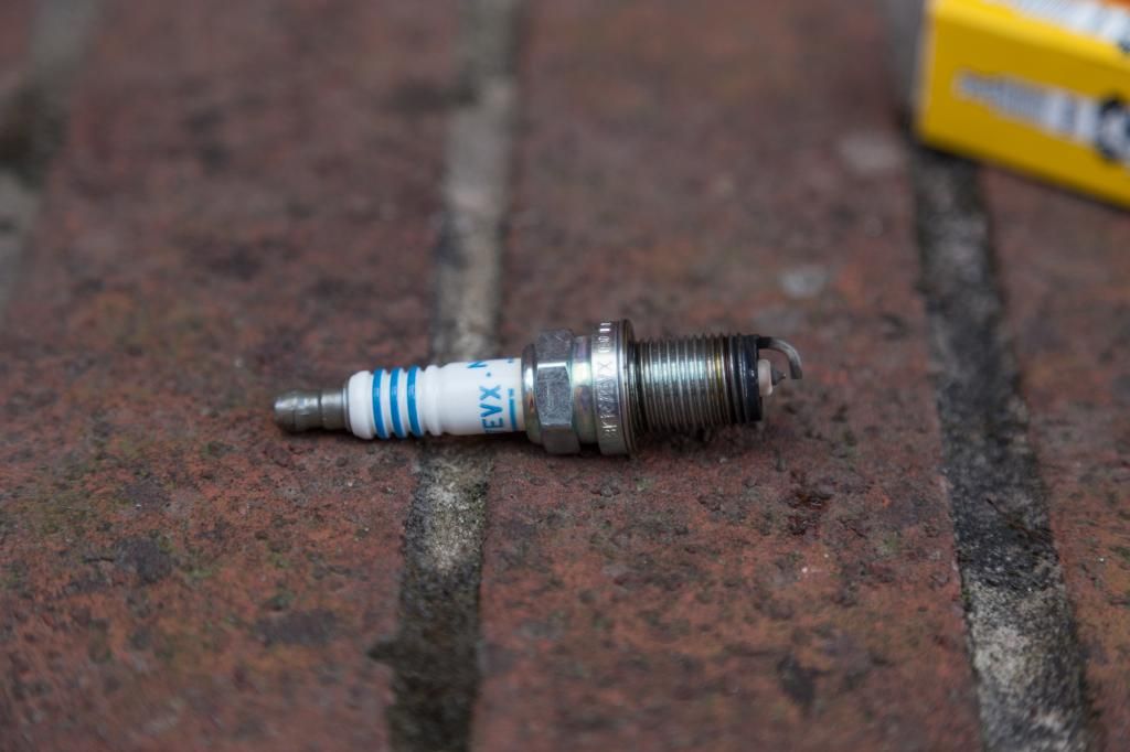

Since the top-end rebuild the SC had been suffering from low rev hesitation, which was suspected to be due to having the wrong spark fitted by the garage. At the time I didn't have a spark removal socket (somehow I'd never bought one) so ordered the tool, along with what I'd read to be the correct sparks for an SC.
The new sparks arrived and were ready to fit.

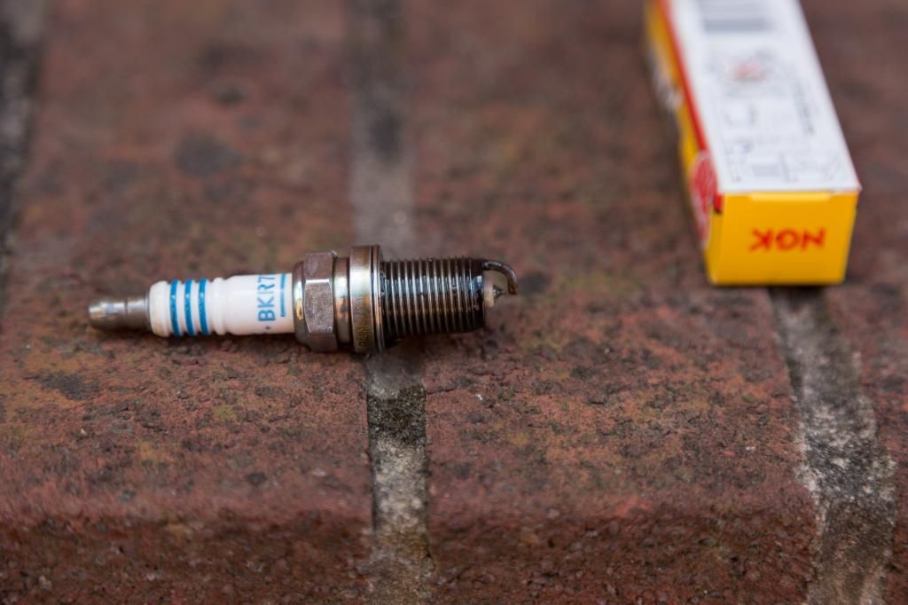

I started to take out the old ones and noticed plug 1 was covered in oil :shock:
The rest were fine.
With the new plugs fitted I took it out for a test drive and the difference was immediately apparent, the hesitation was gone :D Then after speaking to Pete and Ben we decided that the oil was likely left over from the head build and after later removing them to check there was no subsequent oil on any plug *phew*.
