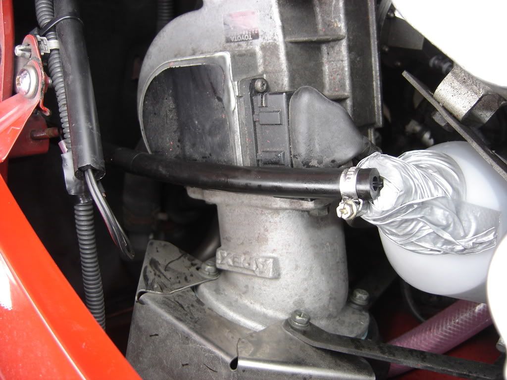

okies my test went superb :mrgreen: here was my technical measuring device (also know as a bottle with some water in)
and my assumptions were correct, the wire coming from the chargecooler is some how the main problem.....
now how 2 stop it from cutting out :-k any ideas on how 2 insulate the wire in the engine bay? so it doesnt get interfeared with from the other cables?? or could it be caused from engine vibration? :-k

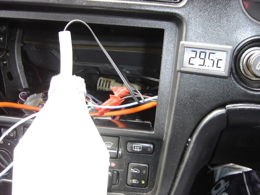

ok dont actually know how many ppl on IMOC are interested about this investigation im doing.... :lol: but here is what i did just.
Re-wired new stat up from other LCD display and used heat-shrink connectors 2 connect the wire coming from the cockpit 2 the stat wire, tested resistance was perfect 0.00 :D
Next i tested the Display using the same bottle as eariler and placed it near the induction kit/greddy catch tank. The Display worked perfect, even on full boost / high RPMs. piccy below.

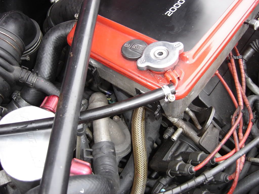

I then thinking it was just the connection was duff before, fitted the stat into the charge cooler and guess what? it cut out on full boost / high RPM :!: piccy below of how it is installed
So my question 2 you IMOC is how do i get this 2 work :!: :!:

sounds like it is the interference from the HT leads but how you fix it I have no idea :( Can you move the sensor further away from the core?
Drifter
Posts: 644
Joined: Sat Jun 02, 2007 4:21 pm
Location: Cannock, Staffordshire
Re: [Mk2] [Turbo] ST205 Charge Cooler. some questions and help please.
Post by Drifter »
thats what im thinking ATM...... but means drilling a hole into the chargecooler at the back above the turbo area :pale: and i dont wana do that...... there must be someway 2 get round it, maybe some uber insulation between leads and stat wires....

depends what you want to measure. Ideally it wuld be the water temperature in the core so... how about drilling a hole into the level sensor mount - thats the black rubber covered cap next to the filler cap. That should be far enough from the HT leads? Even if you tape the sensor on and go for a test run to see if it works ok?

Looking at your pictures, since you aren't using the water level sensor on your core (under the rubber cover next to the core filler cap), could you not fit a temp sensor in there instead? It's a little further away from the HT leads and distributor, so won't pick up as much interference. That, and the original toyota sensor worked okay in that location otherwise they wouldn't of fitted it there.
