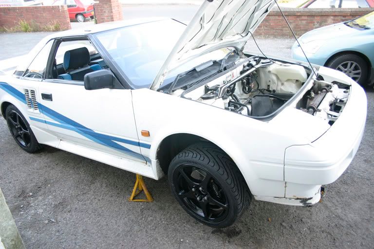

I've got a set of 5 rear Mk3 16's for my Mk1 - took a bit of searching!
It's note quite as chuckable as it was on 15's, but it feels a lot more "planted" - on 215/40/16's. Here's how the tyre options worked out:
Specification - - Sidewall - - Radius - - - Diameter - Circumference - Revs/Mile - Difference
185/60-14 - - - - 4.4in - - - - 11.4in - - - - 22.7in - - - - 71.4in - - - - - - 887 - - - - 0.0% (AW11 14" - as far as I can remember!)
215/40-16 - - - - 3.4in - - - - 11.4in - - - - 22.8in - - - - 71.5in - - - - - - 886 - - - - 0.1%
195/45-16 - - - - 3.5in - - - - 11.5in - - - - 22.9in - - - - 72.0in - - - - - - 880 - - - - 0.7%
205/45-16 - - - - 3.6in - - - - 11.6in - - - - 23.3in - - - - 73.1in - - - - - - 867 - - - - 2.3%
215/45-16 - - - - 3.8in - - - - 11.8in - - - - 23.6in - - - - 74.2in - - - - - - 854 - - - - 3.9%
205/50-16 - - - - 4.0in - - - - 12.0in - - - - 24.1in - - - - 75.6in - - - - - - 838 - - - - 5.9%
OEM Roadster 16" rear = 215/45-16
Here they are, in black:
(...yeah I know - tyre's on the wrong side in this shot!)

That's well over-tyred though Keri, not much fun to be had in regards with handling with such wide tyres on.
Keri-WMS
Posts: 498
Joined: Fri Feb 04, 2005 11:17 am
Location: WMS Brakes - Bexhill, S.E. UK
Re: Mk3 Wheels
Post by Keri-WMS »
Lauren wrote:That's well over-tyred though Keri, not much fun to be had in regards with handling with such wide tyres on.
Seems fine to me, loads more grip when it's dry than either the OEM 14's, or the 195s I got on the previous 15's. Static friction goes up with area so that makes sense.
In the wet of course it's more twitchy, but still nice and predicable.
It's about the same in terms of balance and how the back steps out, it just does it a lot later in the dry.
The only downside I can see is on track as they are too wide to get heat into easily, but this isn't a track car, it's a road car.
User avatar
Lauren
Posts: 38632
Location: Greater Manchester
Re: Mk3 Wheels
Post by Lauren »
It will be 'fine', though having such wide tyres will not help the handling balance. On an NA the best setup I have found is the OEM sizes because that way you can exploit the handling of the car as there isn't too much grip and it makes steering the car on the throttle somewhat easier. On an SC 195/50/15s are absolutely fine because you have that much more power.
As a general rule of thumb unless you have a car that is very much wide of the mark of the OEM specification (ie V8s etc) then OEM is generally best as these are the tyre sizes that the car was designed to handle on and it's hard to better that.
I'll bet your car tramlines like an absolute bu88er though. Tried 205s on a MK1 and that was terrible for it under braking.
