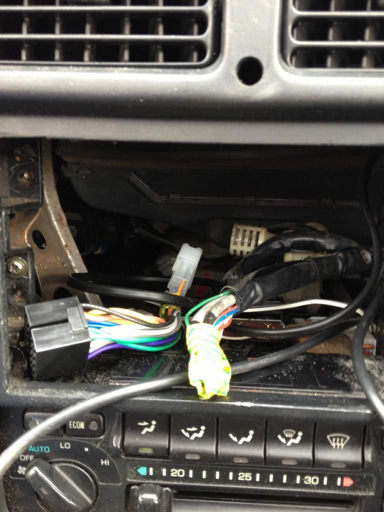

just had a look at the missing radio slot and the wiring etc .... its been butchered to hell and back!!! :mad: :mad:

Is that green wire an aftermarket fog light feed for the rear lights at some point? As imports did not have fog lights as standard.
Radio wiring shouldn't take too much effort to sort, I wouldn't have thought :-k

RedMR² wrote:Is that green wire an aftermarket fog light feed for the rear lights at some point? As imports did not have fog lights as standard.
your dead right there Red :thumleft: it goes straight to the rear clusters
