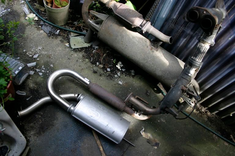

Titanium+steel single exit exhaust 14kg saving.
