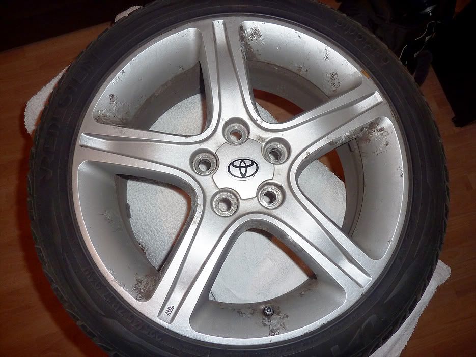

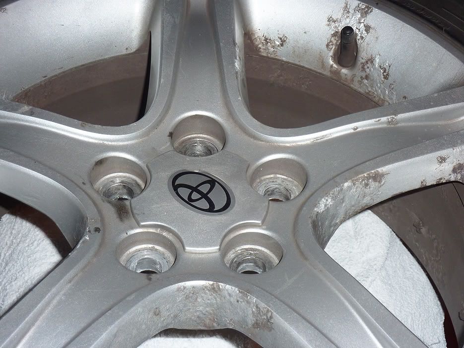

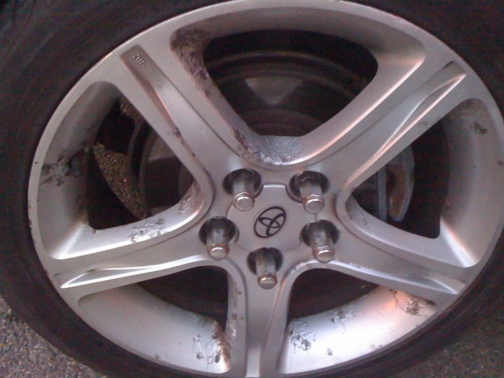

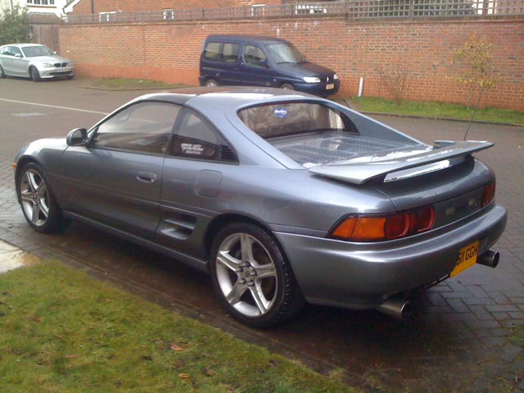

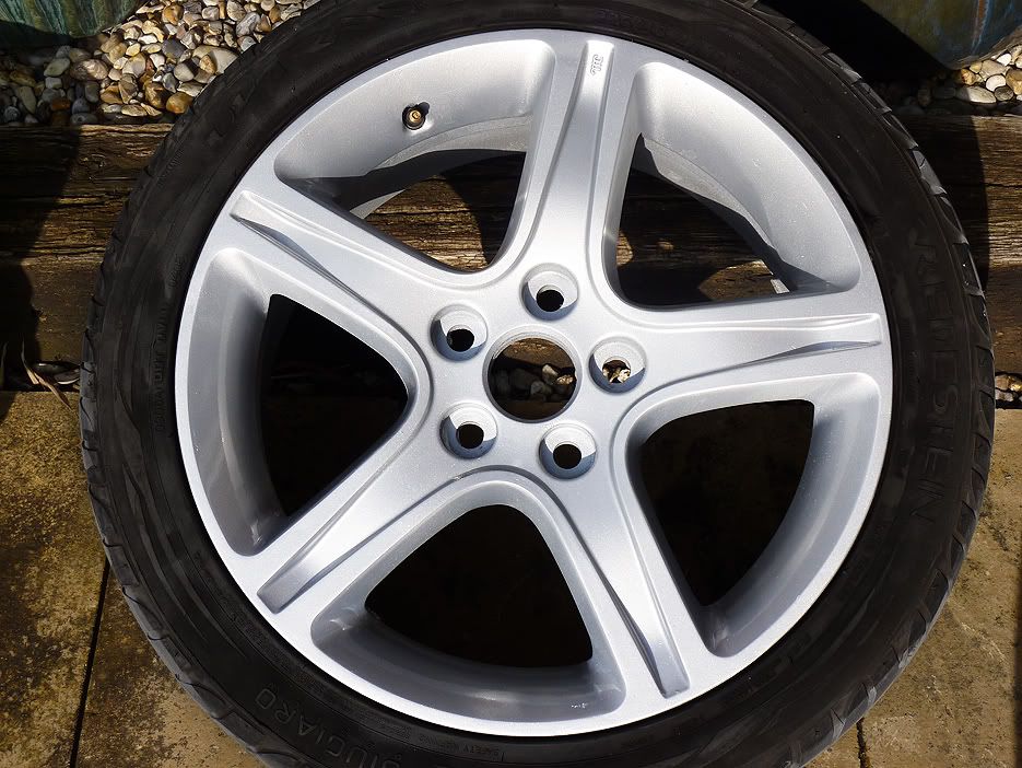

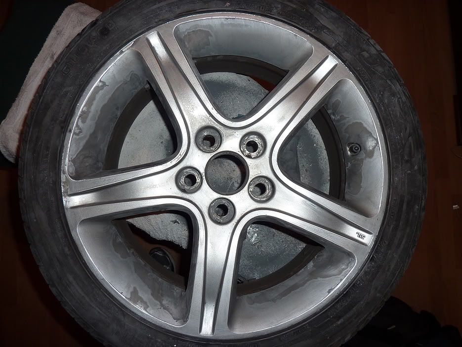

Smithmyster wrote:rhamps wrote:Re- is200 wheels i have them you know you need spacers on front and rears dont you? and also you should put 235s on back and 205 or 215 on front.
Just got home after the best part of 8 hours on the road(in a poxy Van) to get them.
They have 225/40 at the back and 205/40 at the front with 3mm spacers all round.Will find out in the morning if they fit ok.
I bought them of another MR2 own so should be cool
(I hope)
Yeh that will work fine mate its just that if you dont have the 3mm spacers the wheels rub the brake caliper just make sure you get the spacers central to the hub so you dont un-ballance the wheels.
