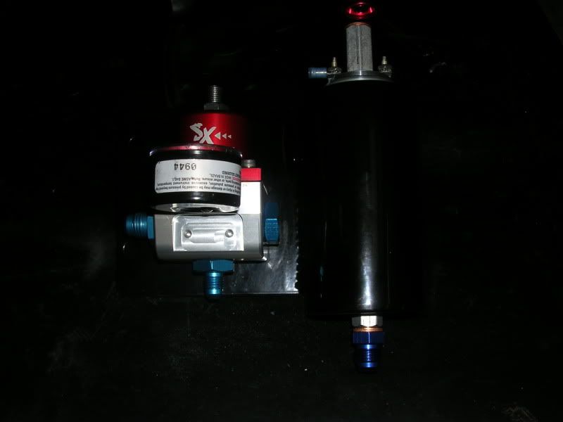

FPR and welbro 255 pump

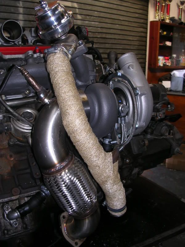

Over the weekend i fitted an "other" intercooler to the mr2, This time a Pheonix Power Intercooler. This IC is know to be the best sidemount intercooler (SMIC) for the MR2.
Here it is compared to the now old IC which is a 4inch core.

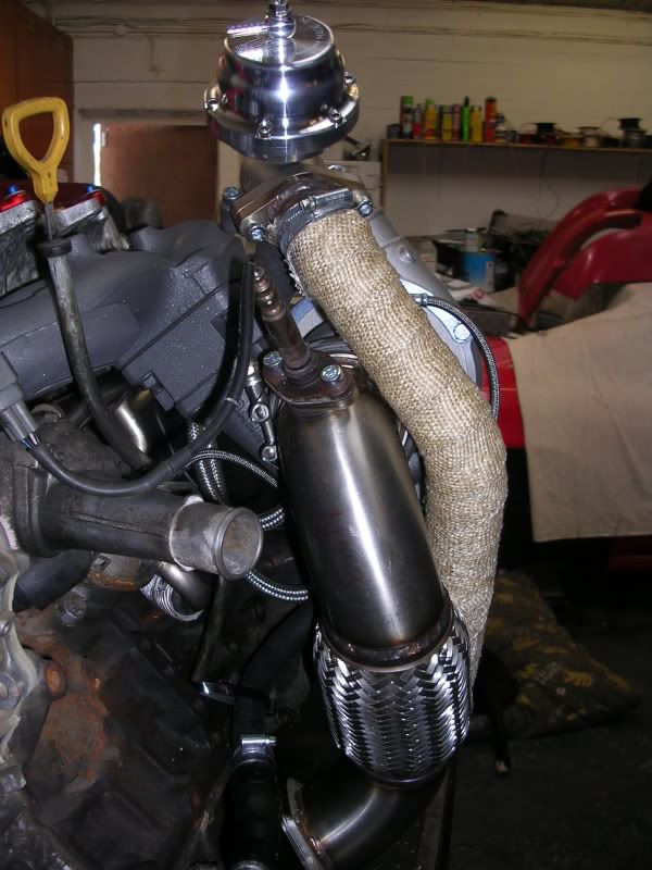

I was missing the turbo hot pipe with the kit so i asked the guys at Garage D in watford to put their expertiese into the build and got them to make me a 1 off hot pipe. With in no time at all Walton got cracking into making the mock up:
Then julien took over and finished the welding and also added a vacuum pipe connection and a port connection for the BOV to be put in place together with he added samco joiner hose. Walton also made up a bracket for the BOV without no mark up just perfect eye detailing and made the bracket first time without no mistakes
And end product
To say the least the guys from Garage D have done an excellant job at doing this and their fabrication skills is fantastic.

Exhaust Heat wrap from Driftworks

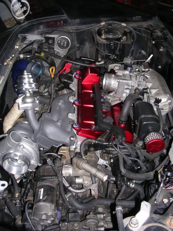

I had to change the rocker cover as the one i had on there had a crack and p1$$ing oil over the engine bay.
Once again sach sorted me out with painting a new one for me in Candy Red

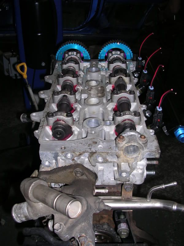

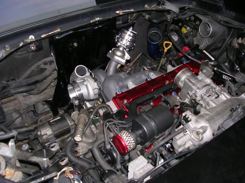

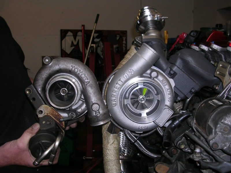

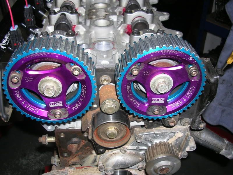

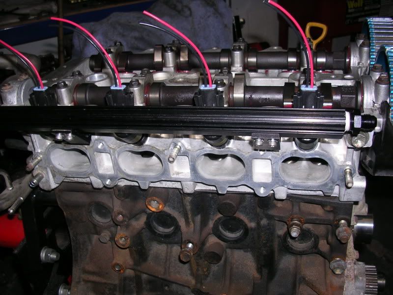

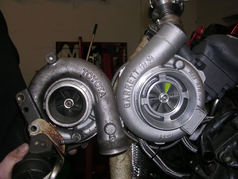

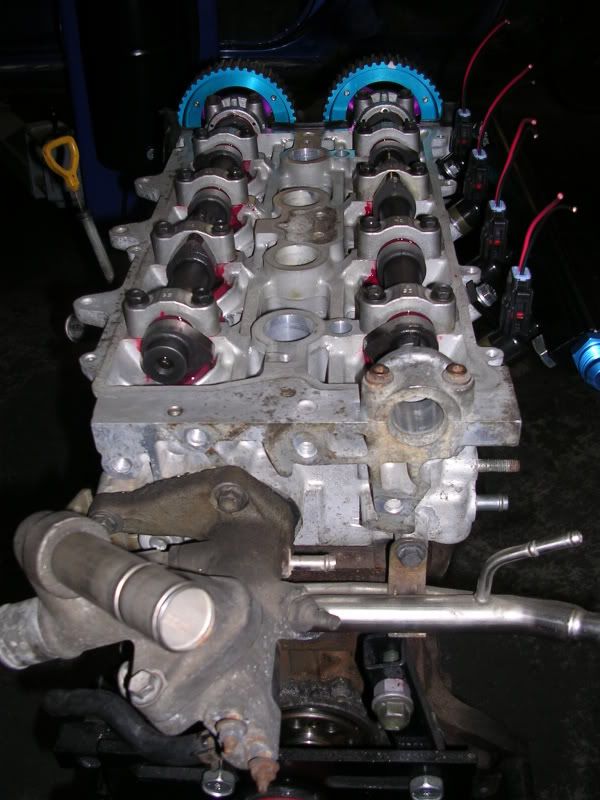

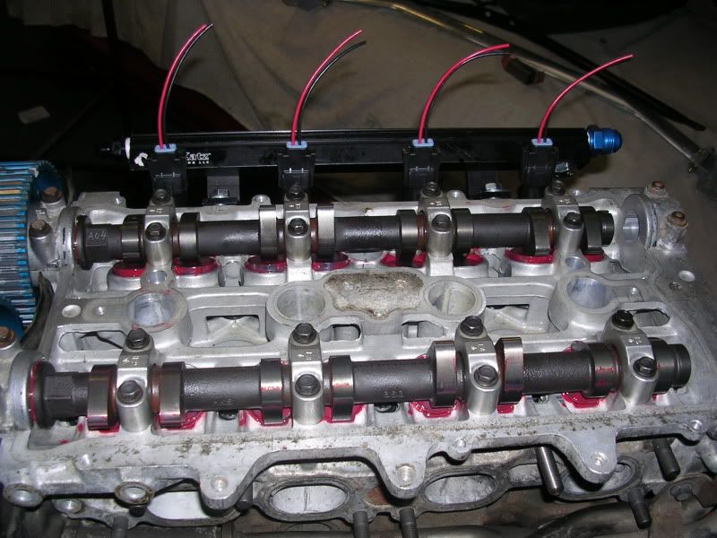

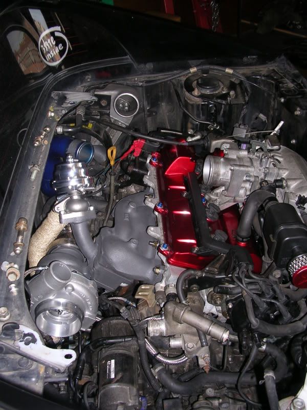

New Built forged engine with:
wiseco pistons 86.5mm
Eagle Rods
Cometic Head Gasket

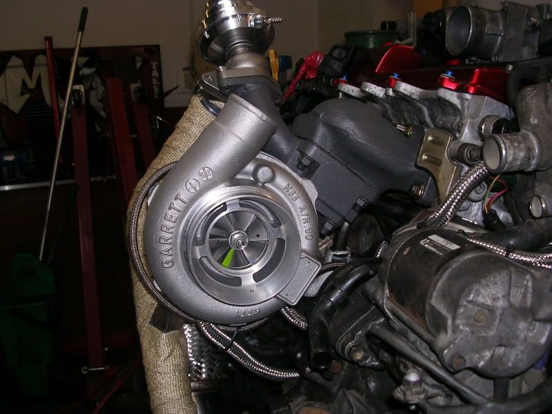

GT3076r turbo
Ferria Racing Valves - Exhaust
HKS 264 cams with Cam Gears
Fidenza Lightweight flywheel
New OEM Water Pump
New OEM Oil Pump
New Toyota Timing Belt and idle bearings
RPS Carbon Clutch 525 ftlb
GT3076r with screamer pipe
38mm Tial wastegate
Aeromotive pressure Reg
Wolfkatz 1000cc injectors and fuel rail
Custom 4inch intake pipe with garret filter
Welbro 255 fuel pump intank
Welbro External pump
HKS plugs
I'll get some more as the bits come in and back from powdercoating
