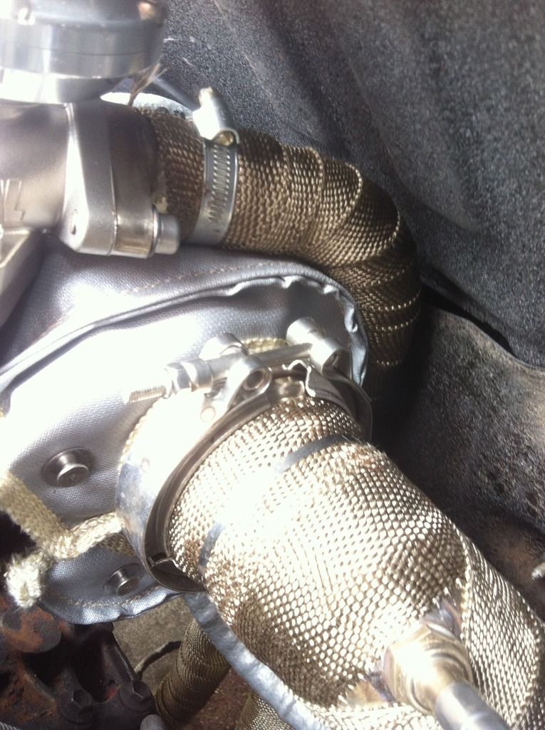

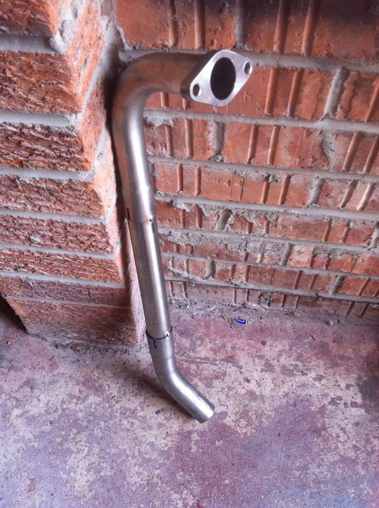

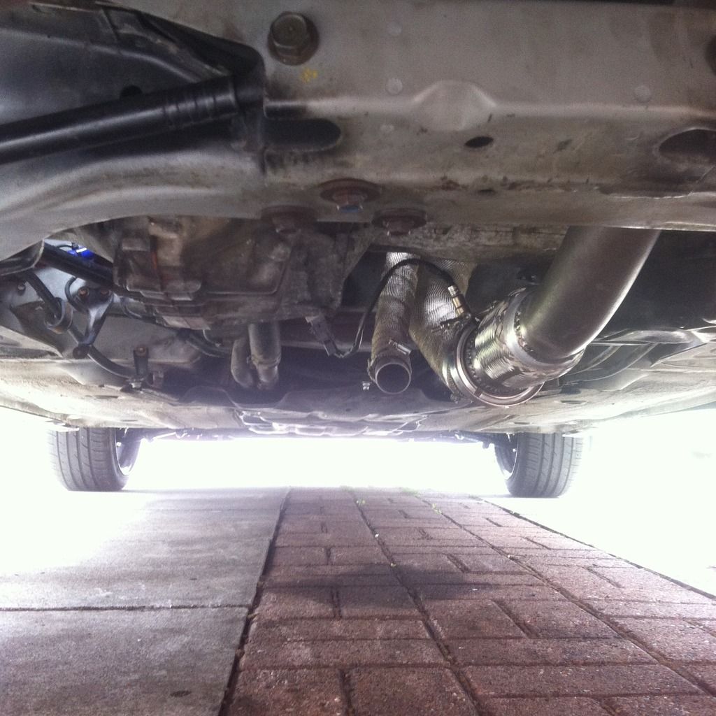

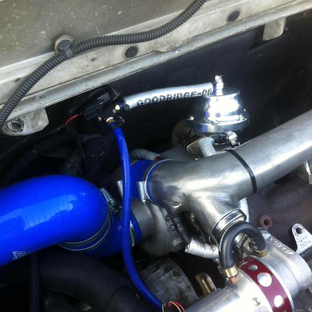

managed to get a couple of hours in this afternoon so made and fitted a wastegate dump pipe or 'screamer pipe' if you prefer.
nothing too exciting here, just a 38mm wastegate flange, a 90 degree bend, some straight tube and a little 45 degree bend.
which was then fully welded and heat wrapped
and then fitted to the car
job done.
I then secured the new PTP turbo blanket with the supplied lock wire (not pictured) and refitted the turbo to intercooler crossover pipe and did a couple of other little bits that aren't really worth going into.

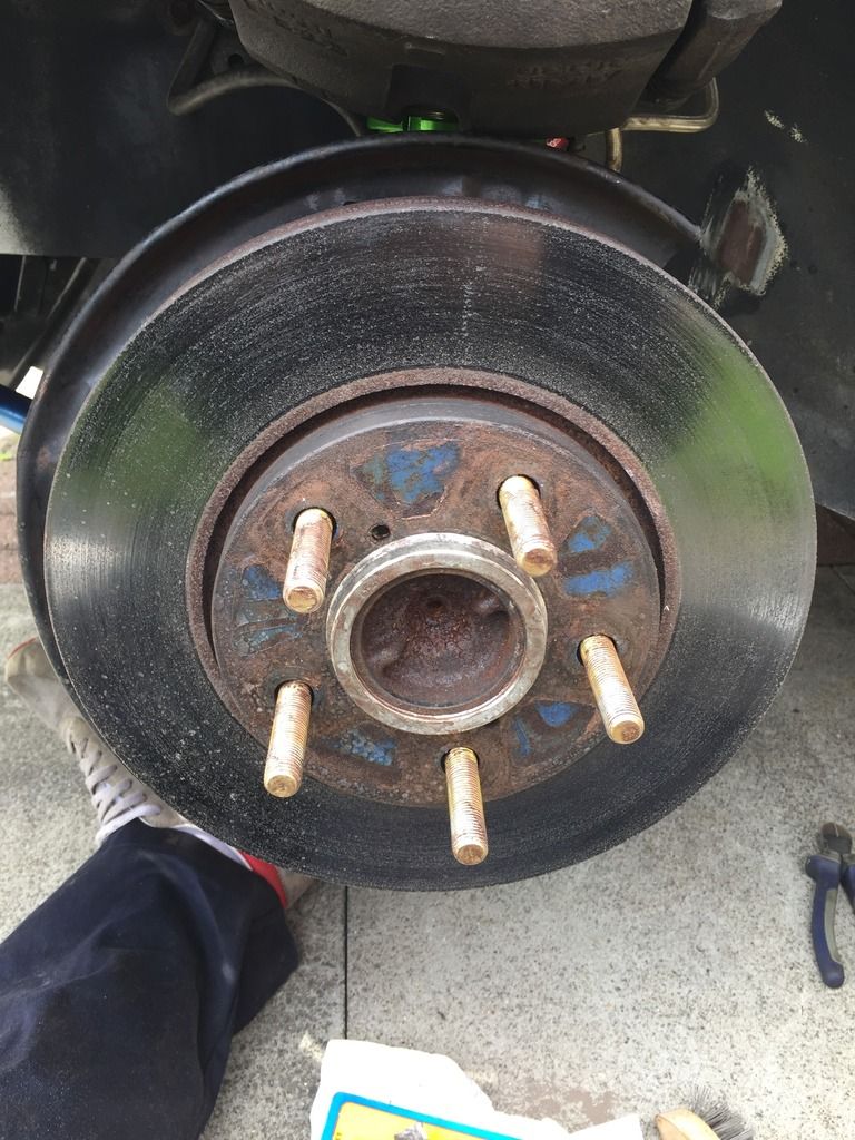

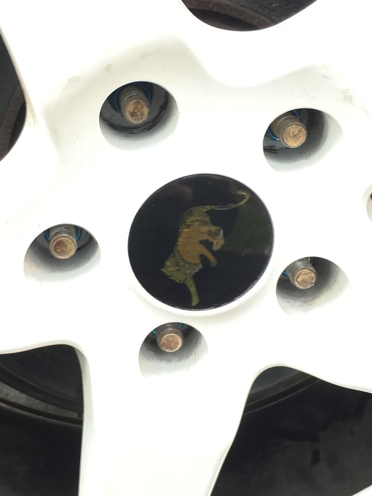

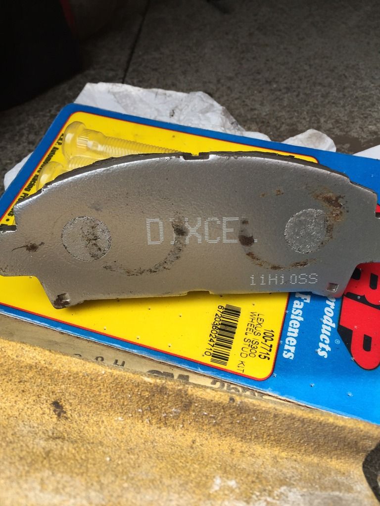

front ARP studs have been fitted to the hubs, pulled in no bother with my snap on gun and theres definitely no issues with thread engagement now!

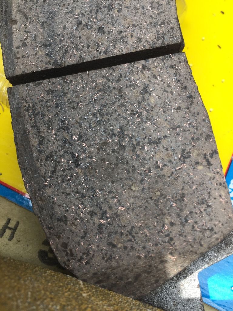

also gave the brakes a bit of a clean off too cause they looked a bit glazed over - it seems like they're DIXCEL M type pads on ENDLESS plain discs
the pads look to be a copper mix material, but going from the Dixcel JP website they're rated to 500 deg ( http://www.rhdjapan.com/dixcel-brake-pads-m-type.html ) so just a fast road pad, however brakes is something I have plans for in the future so this doesn't concern me at the min.

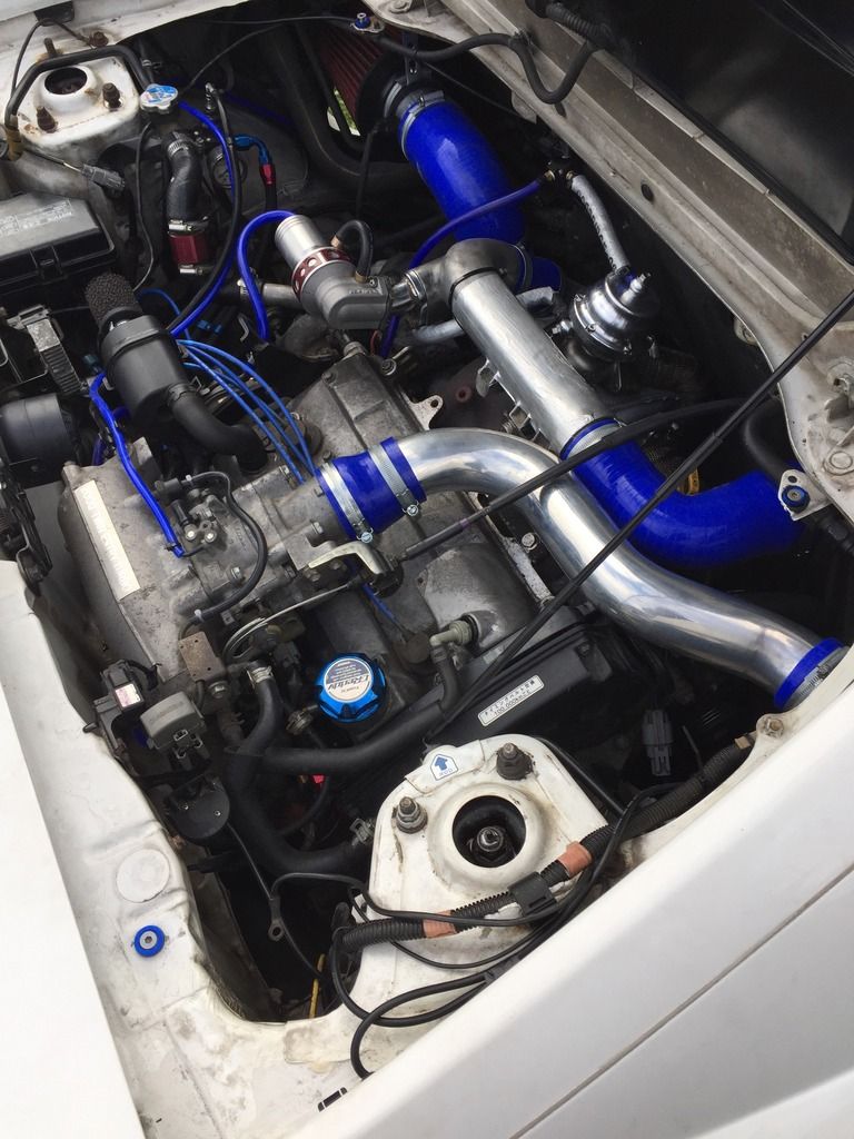

the engine bay is just about there too.. tbh this picture depresses me, it looks really dirty and unpresentable, but I suppose it's functional and I can do the whole paint/powdercoat/tart up thing once the car is back on the road, you'll be able to see the Zircoflex stuff on the hot pipe above the exhaust manifold, which will hopefully stop a little bit of heat soak until I get chance to make a proper heat shield, i've got the stainless sheet but haven't had time yet

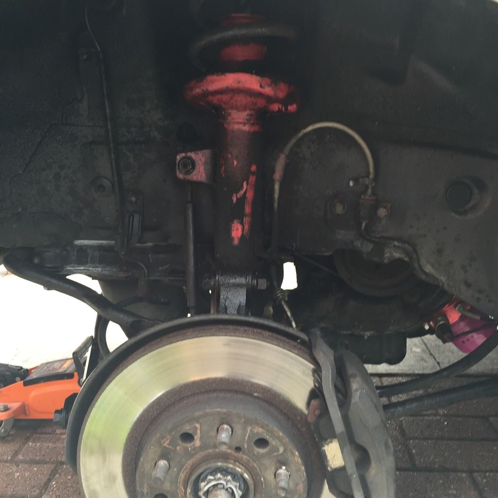

this weekend I got all of the rear suspension done, after a set back with the hubs I had blasted, painted up and new bearings in - basically I bought some MA70 supra tie rod bearings as we all know the MR2 ones aren't available seperately - the supra ones fit but just require a M14 bolt and the holes in the tie rod to be opened up, I then proceeded to damage one of the bearings when pressing it it which was totally my own fault, trying to hold the hub square, keep the mandrel on the bearing and operate the hydraulic press at the same time, I then noticed, something I probably should have noticed before that one of the bottom ball joint threads was chewed ](*,)
so, as the only issue with the hubs I actually have on the car was a little bit of play in the passenger side wheel bearing I just bought one more wheel bearing, and presses that into that hub - so no pretty freshly painted hubs, but they're not rusty and are perfectly serviceable, so these got extended studs pulled in them too and they can stay on the car.
so that's now coilovers, powdercoated lower arms and strut bars with superpro bushes, new rear wheel bearing and sonicboom RCA's all fitted, and I made some rose jointed ARB drop links too (no pics of this as I was just wanting to crack on and get the work done)
this is the old GAB/KYB gymkhana stuff that came off.. it's fair to say that this one was clearly leaking :lol:

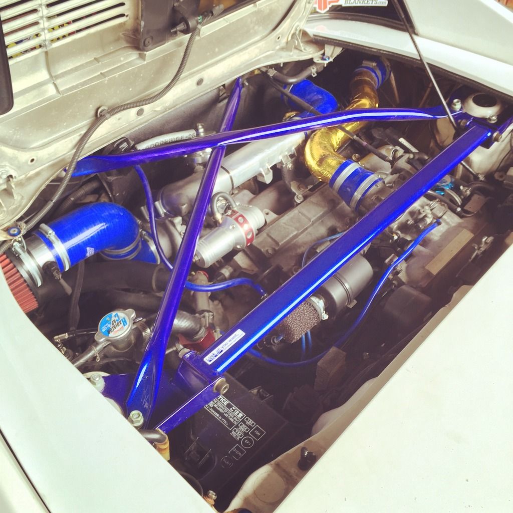

Seems like I've had an amazing stroke of luck, due to a planning issue at work the module of the course I was supposed to start on Thursday has been delayed so I've managed to bag a little bit of time at home!
The DEI reflect-a-gold I ordered the other day arrived at lunchtime today, and after running a few errands I got half an hour on the car, so silly expensive gold sellotape was stuck to the intercooler pipe and I got the strut brace and X brace back on followed by the inspection panels - I feel loads better about the engine bay now, a splash of colour takes the eye away from the less aesthetically pleasing bits

Looking good Rob. That strut brace, is it just an eBay jobbie?
C35Rob
Posts: 2108
Joined: Wed Dec 04, 2013 1:14 am
Location: Gateshead
Re: TOM'S 96 Rev 3 GTS - BREAK ME UP, BEFORE YOU GO GO
Post by C35Rob »
androo007 wrote:Looking good Rob. That strut brace, is it just an eBay jobbie?
Thanks mate!, no, it's a genuine TOM'S strut brace I imported from Japan, and had powder coated - I've got the matching front strut brace and lower suspension arm brace too

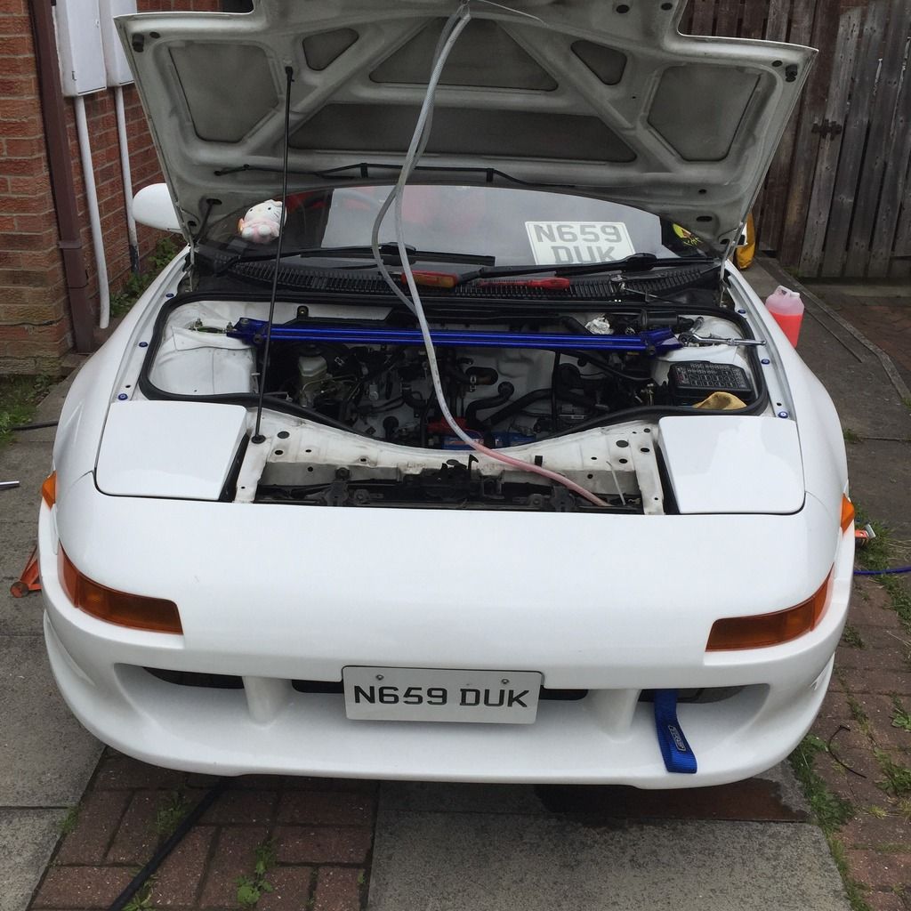

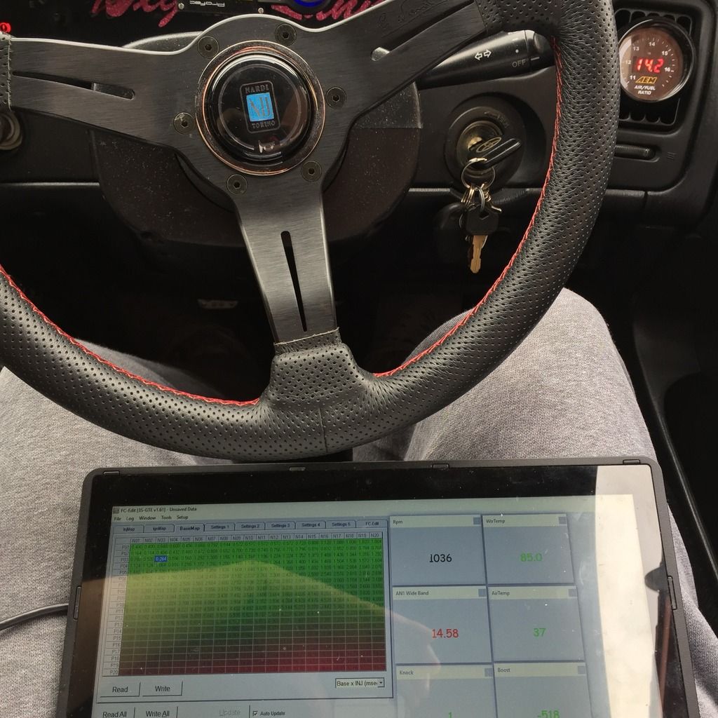

got another few hours on the car today,
dropped the front suspension down an inch, it's still a little higher than the back, not sure whether i'm going to raise the back or drop the front more, but I'll leave it till after the mot cause the place I'm taking it has got quite an old ramp with a steep incline.
cooling system was bled up, no problems here
had my little helper come and see what was going on
and tweaked my idle AFR's
and that's it.. just needs alignment, a thorough wash and an MOT
