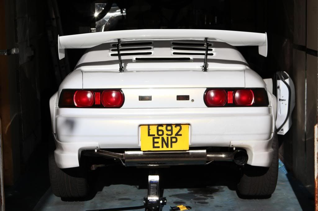

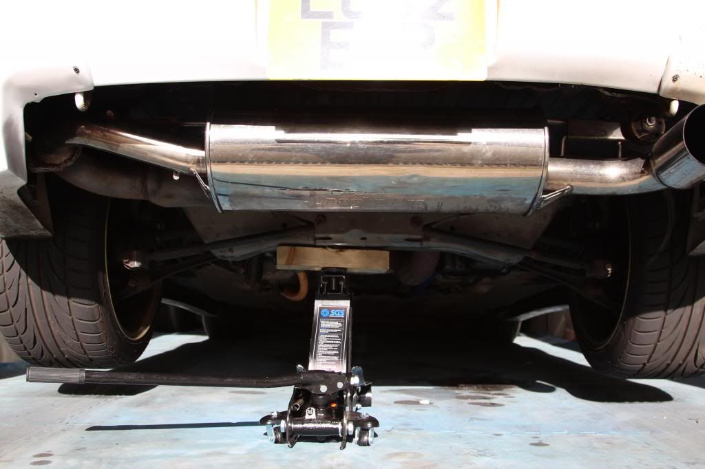

New jack arrived today, to replace the POS which failed on me :evil: This seems far better made so hopefully won't lower a Mule onto my torso while I'm under there. 8-[
Up you go fat a$$ :lol:
So it's a Mule with a Sheepdog for an exhaust and a chimp driving. It's like a twisted 80's sitcom :mrgreen: I do see the need for some polishing under here though :-k

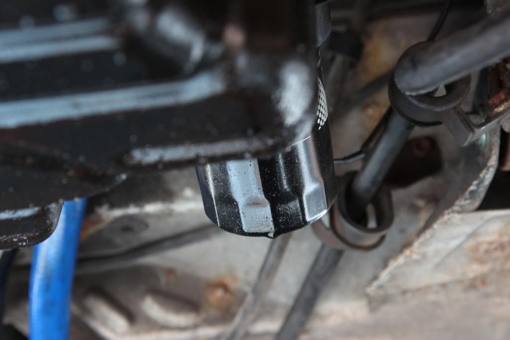

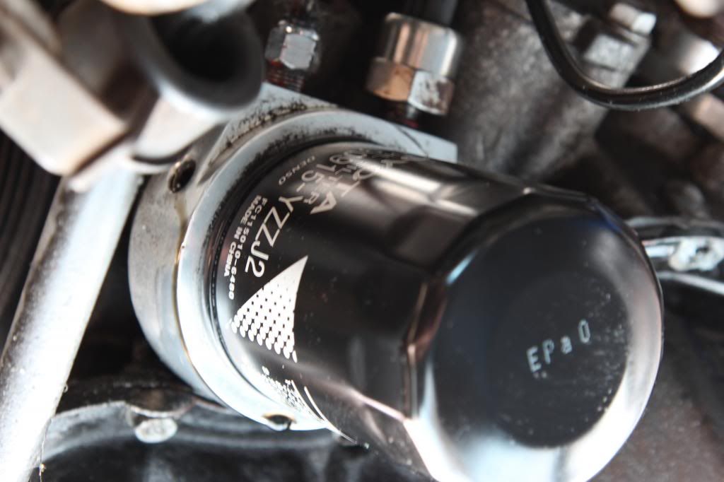

So, time to find the sources of the oil leaks. Exhibit 1:
Exhibit 2:
It looks like the sandwich plate and filter aren't to blame, it's actually a port with a grub screw in. Not sure what it's for though :-k After cleaning everything down and running the engine for a while I spotted it leaking from here. See the left side of the sandwich plate below.

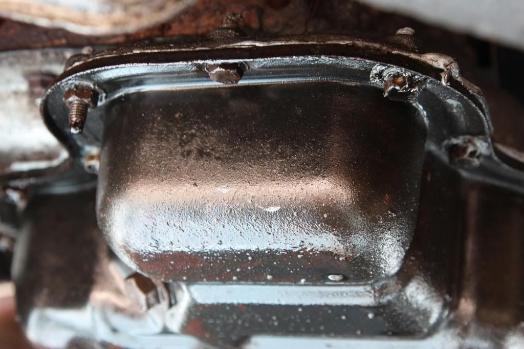

Tightened it up and tried again with no leaks. Not sure if that's solved it though, so will need to monitor it. The main issue appears to be the sump itself, as all the bolts connecting it to the upper sump area (don't know what it's called :oops: ) is wet with oil. Any suggestions on how to remedy it all?

please tell me you used axel stand :pray:

I don't like being under these things at all, it feels all wrong to me. So when I do I always have a fail safe in place. Thanks for worrying about me though :thumleft:

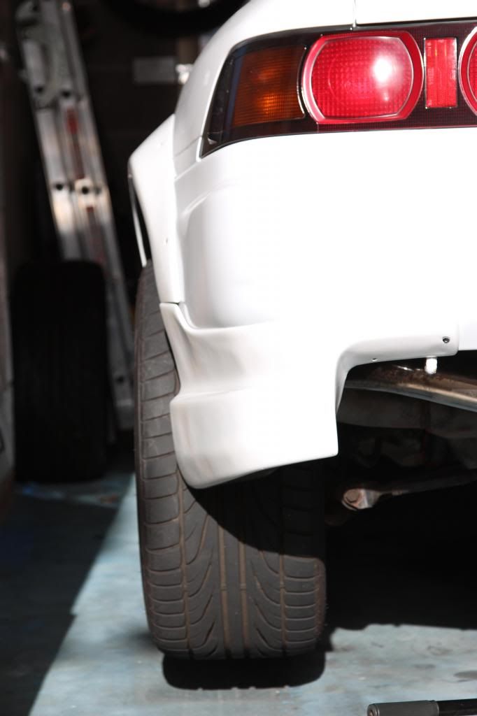

I hear ya. It's the one thing I REALLY don't like about the car :(
I need to get some paintwork done on it this year, so plan to get everything like this done at the same time. The main issue is the fact it's not a standard colour, so the painter needs to mix the pearl to match the rest of the car 8-[

What would this hole (mid left hand side of the sandwich plate) be for? :-k

Magic Beans wrote:What would this hole (mid left hand side of the sandwich plate) be for? :-k
pistol pete
Posts: 7068
Post by pistol pete »
A bleed screw in case needed?
Or maybe oil temp sensor?
ashley
Posts: 7628
Post by ashley »
I'm geussing it's a blanking screw, the original port may well be for a pressure or temperature sensor as Pete suggests :thumleft:

Makes sense I guess. I'll see if anything has come out since it's been tightened and will look to seal it properly, as it obviously wasn't before ](*,)
Looks like the sump bowl will need to come off again as the seal appears to have failed. Although it was only done back at the time the power mods went into Mule v1 last year :-k Above the join is dry.
There isn't such a thing as a non-liquid gasket for rev 3s?

nope just good old RTV.
make sure that all the old is cleaned off and that the bead sits 'inside' the bolt holes. if the sealant has been put round the outside of the holes itll leak through the bolts.
theres a diagram in the BGB i think for sealant placement.
the bung on the oil cooler is for a sensor attachment i think, hard to tell what size it is from the picture.

dawesy wrote:nope just good old RTV.
Understood, thanks :thumleft:
There's a couple of bolts which sheared off when it was being removed last year, which could be playing a role in the leak around the join.
The bung in the plate is around 8mm across, maybe 6mm. It was mounted to the old engine when I bought the car and was migrated to this engine during the transplant. I always assumed the leak was the O ring on the plate, but it's dry.

haha, yeah i have a little drip from somewhere but finding the source is proving hard ](*,)
bung sounds like it is the right size for a temp sensor.
snapped bolts will cause a leak, lloks like its out with the easyouts when you get time then :(

I had my sump sealed 4+ times before it actually worked. Surfaces need to be totally clean, needs to be reassembled within 5 minutes of the RTV going on, and ideally should be left to cure for 24hrs before you put the oil in.

toxo wrote:I had my sump sealed 4+ times before it actually worked. Surfaces need to be totally clean, needs to be reassembled within 5 minutes of the RTV going on, and ideally should be left to cure for 24hrs before you put the oil in.
Noted, thanks. :)
It would be so much easier if they used a solid gasket :(
