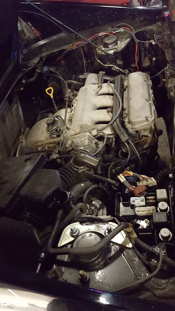

It has begun, 3s-ge being removed.

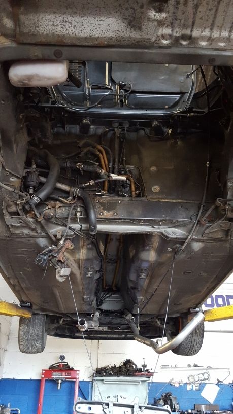

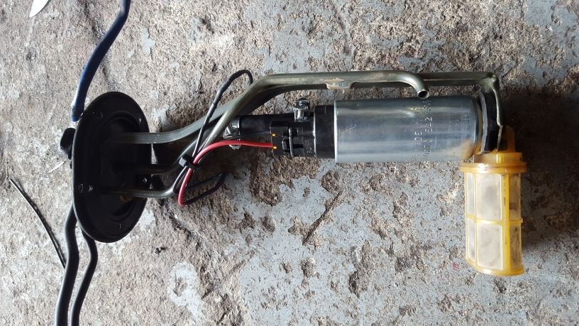

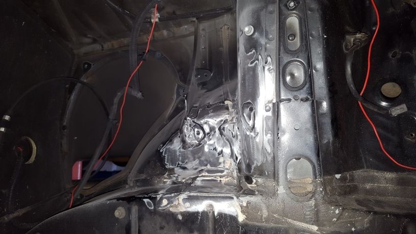

I dropped the tank out for Walbro fitting....
Then removed the chassis mount on the drivers side.... no going back now.... this is only needed with Evora hardware, sane people normally use Goukys mount, but that won't work in my case because i am using the Evora idler and bracketry.
Anyway, off with the mount....
There is more cleaning and grinding to do here, but you get the idea.

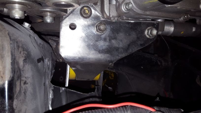

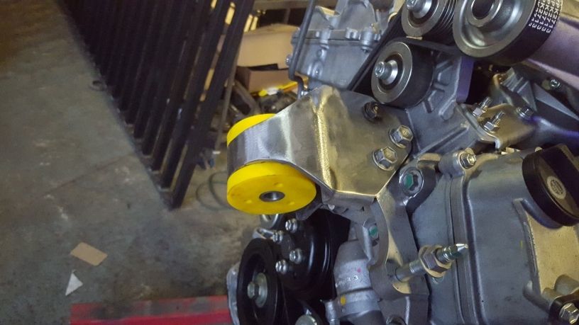

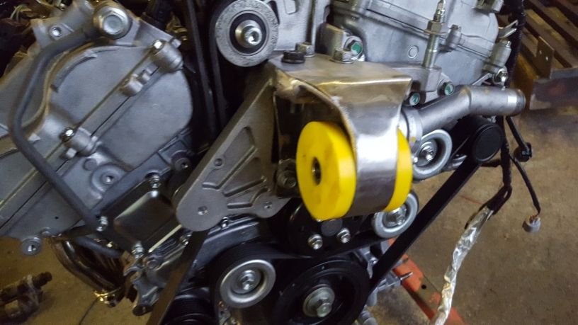

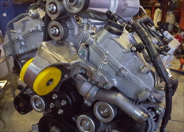

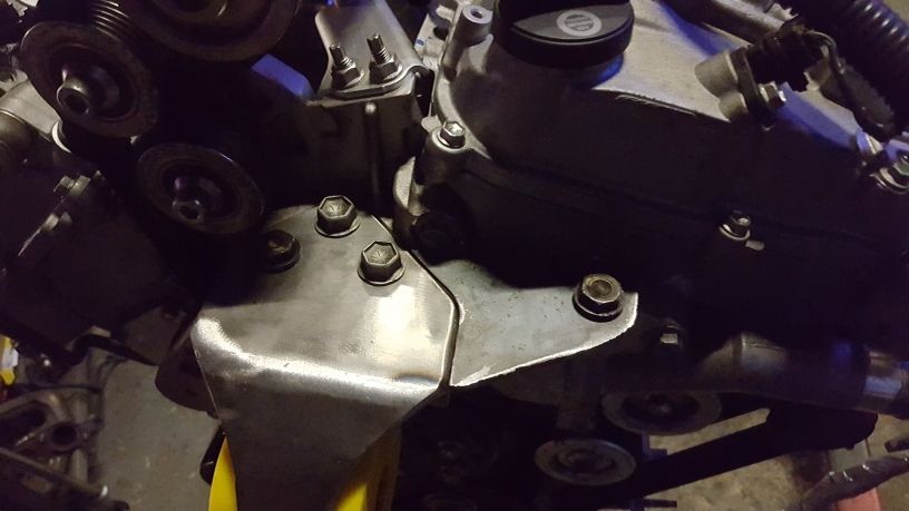

So the first step is to make a mount on the drivers side of the engine, at the moment i have nothing, so i made this from scratch....
That turned out pretty well, i am going to add this side plate and tie it into another bolt hole...
Now that the engine has a mount, i will dummy fit the engine with a S54 gearbox, hang it on all three of its gearbox mounts and then make a chassis hanger bracket that catches my new engine mount. At that stage the engine will come back out, seam weld and seal the chassis back up, paint it and rehang the engine with the 6 speed gearbox attached, that will allow me to make the three new gearbox mounts.

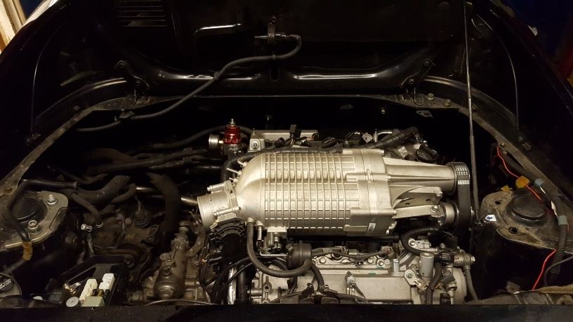

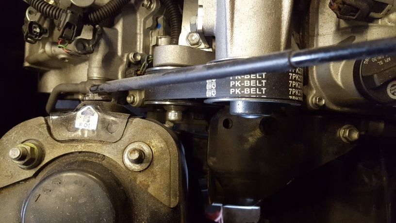

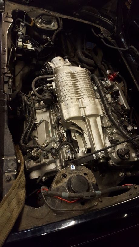

Ok, the first dummy fit has taken place, i bolted an empty S54 gearbox casing onto the 2gr purely for alignment purposes and hung it in the bay. Things were so tight on the drivers side chassis rail that i have had to go in to this mount from the inner wing, so i'm fabricating and tack welding through a letterbox!
The mount sides will be tacked this way and later when the engine comes back out i will fully seam weld and seal the mount properly, along with a reinforced double skin plate on the inner wing, in theory it should be stronger than before. There was just no room to tack weld from above or inside the engine bay so this was the only way forward.
The new chassis hangers in place....
My access from the inner wing and cardboard mount templates...
With everything tacked in situ and aligned to the nearest mm it the engine was hanging under its own weight....

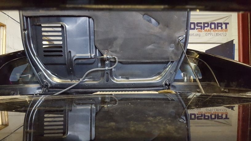

I will even get away with a turbo engine lid here...
Decent clearance on the belt side....
So this will come back out now, weld the chassis back up and the next time it goes in it will have its new 6 speed attached.

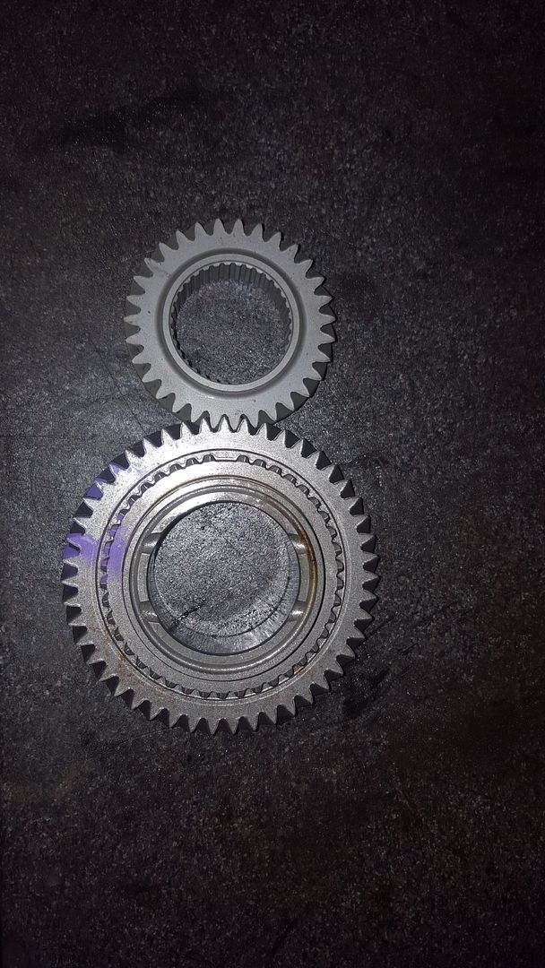

So my extended 6th gear set arrived for the EB60, 0.659:1 , that should give me a nice low cruise RPM.

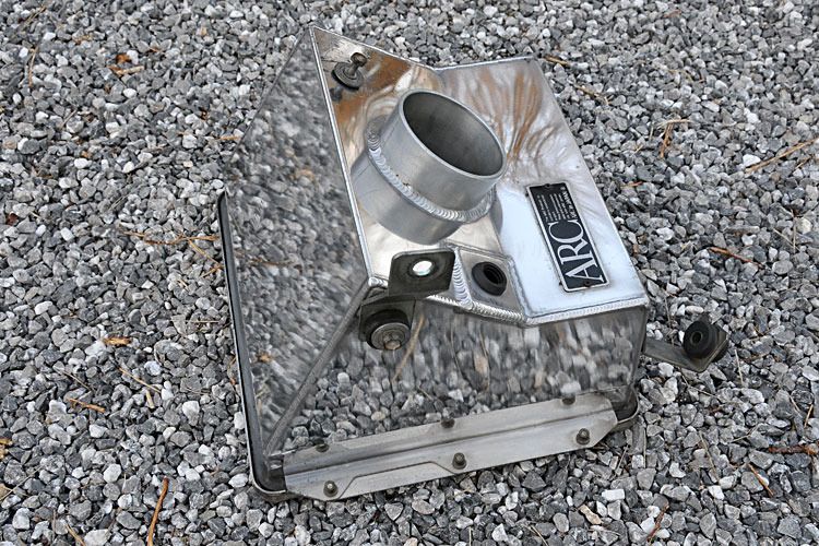

ARC intake bought.
