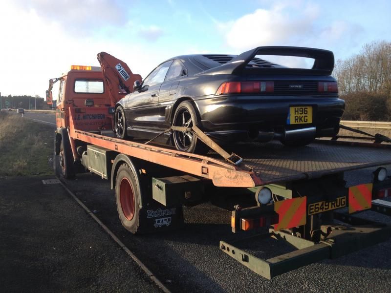

So today has been great!! Not!
Just popped down the road when I joined the dual carriageway and when I changed up to 5th there was a loud bang/pop and engine died!!
Just got the car back home and started checking everything I could, no leaks or pipes off or anything out of the ordinary?? Checked the timing belt etc..
So decided to try and start her up, it chewed on a little but then fired with a spine chilling bottom end knock! Sounded like two hammers hitting each other!
So sounds like the bottom end has failed in some way!
What to do now???
Cheers Craig

terrible news mate but for the sake of having the car back on the road (this is just what i'd personally do) i'd just find another motor and pop it in, obviously a good one, before any of that though, i'd try and determine what caused such a massive boost spike. could be a split actuator hose or something.

Re: REV 1 GT - @ Back Home
Trailer it mate, Pete has a trailering guy you can sort out between yourselves? :thumleft:
