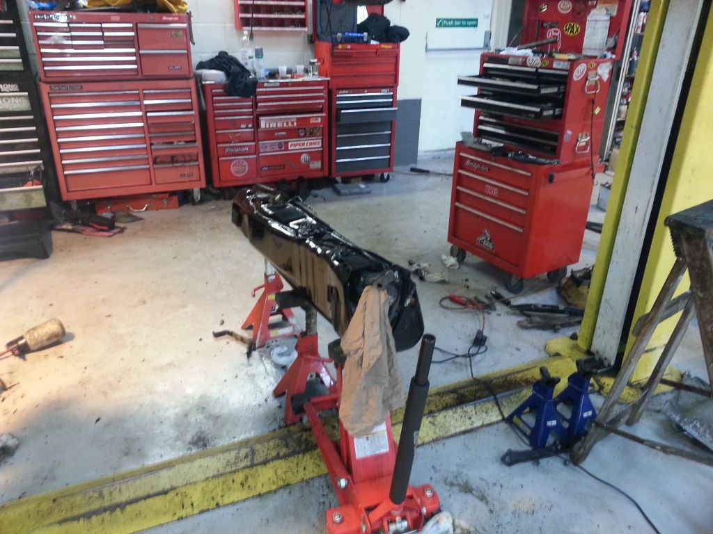

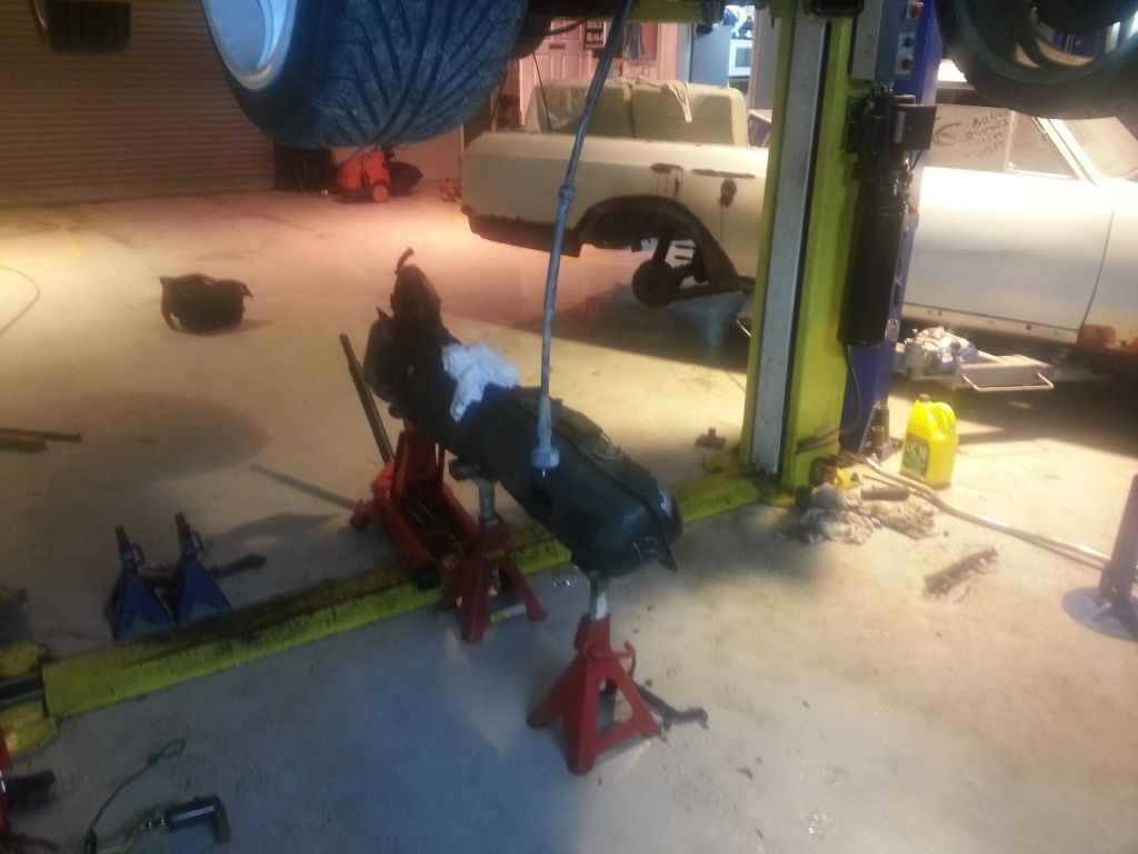

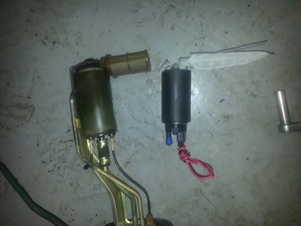

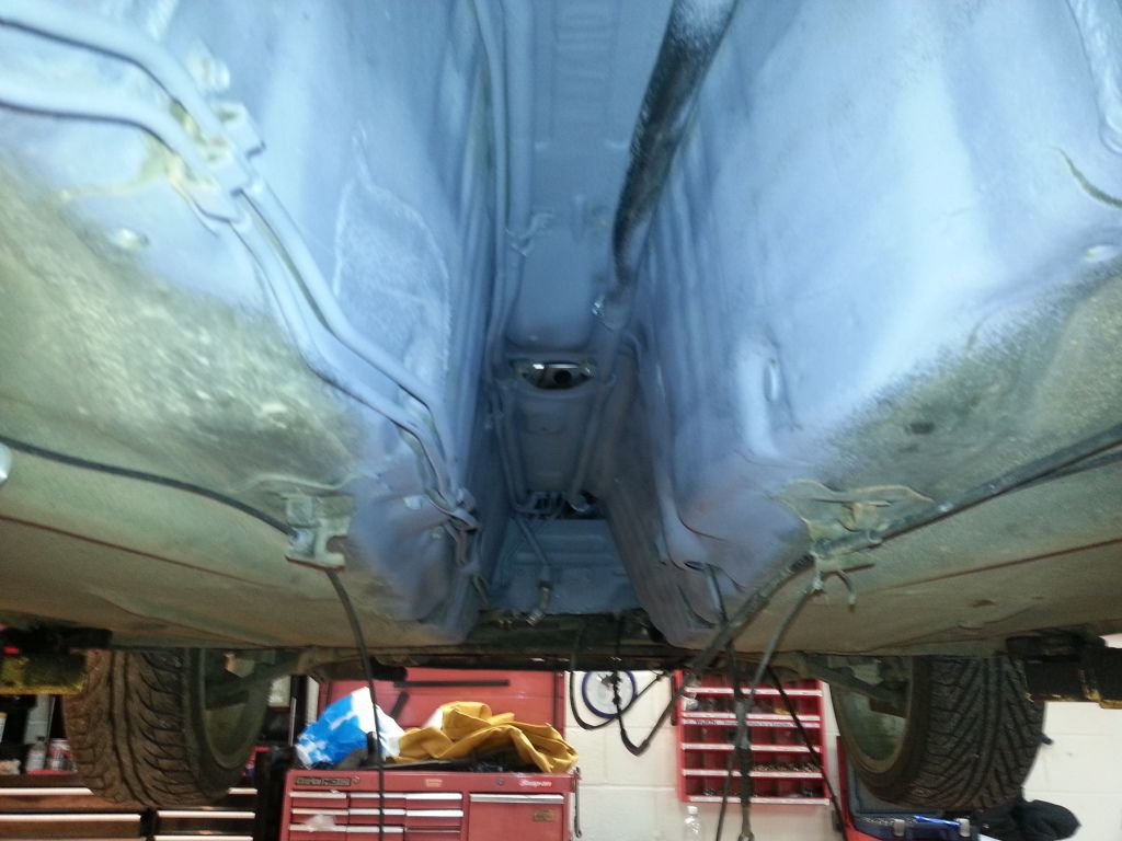

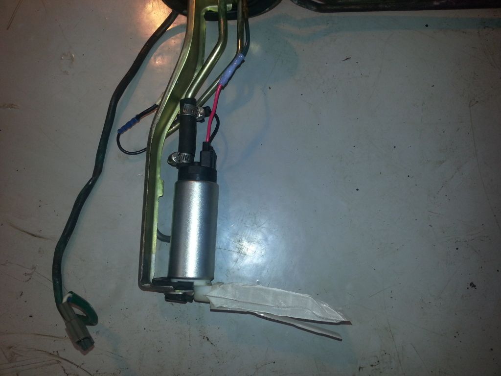

back again, i have decided to do some work again, dropped the fuel tank today, to replace the pump with a 255 pump, underseal the whole car, and replace the water pipes.

i tell you its a good job i work in a garage.

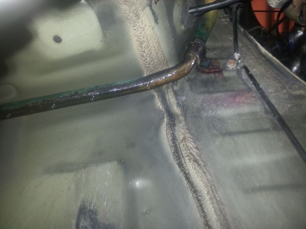

The pump didnt come with a new rubber hose so i didnt feel compfortable using the old pipe so searched out a new pipe. Also the earth wire had been rubbing on the fuel lines so i attached an old bit of vac pipe around the new wire to stop it happening again.
Whilst the tank was out i took the oppertunity to treat the car. I treat the area where the tank is. I also re painted the tank. and all the brake pipes and fuel lines.
I also fixed my water leak by replacing the pipes from hell.
Now we have the bad news I spent AGGGGGGES trying to blled the car but cant. I gave up after a while as its just steaming up, problem being i drained the whole system dry

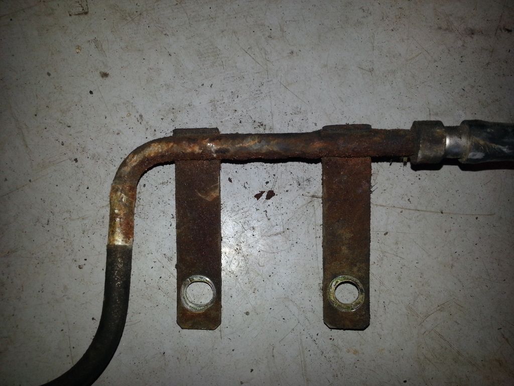

So i figured im staying to do my front brakes so ill have a look. So the fuel smell waa a fuel pipe from the tank to the bottom of the fuel filter (ME thinks) the padded area behind is all damp and seemed to get better when turned off. The pipe has all rusted out so i got one tonight from henry.

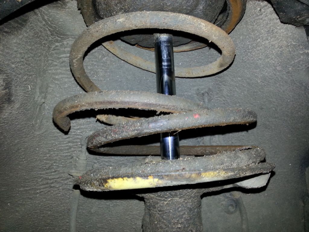

So im doing my brakes and i thought hmm thats not right, AND my o.s.f spring is broken falling out. GRRRRR i cant drive it now as its about to fall out and because there lowered i need a whole set.

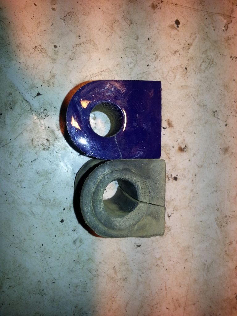

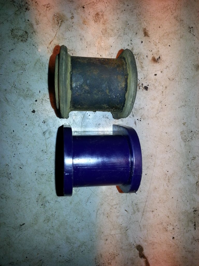

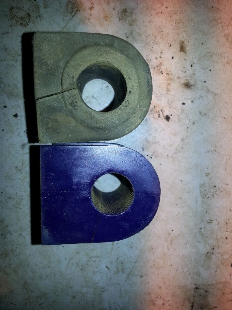

and i brought some superfles antiroll bar bushes which i think are wrong :thumleft:

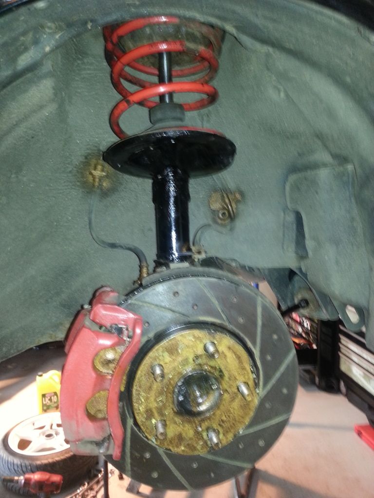

Eell had a almost constructive day
New struts all round painted
New frobt strut bar bushes and bars painted
Tvis refitted
Fuel leak fixed
New rack boots
Front wheel alignment

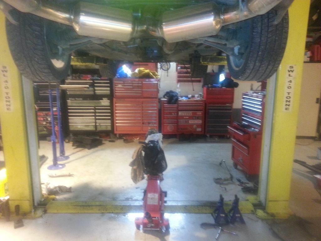

well what i freaking day i had yesterday

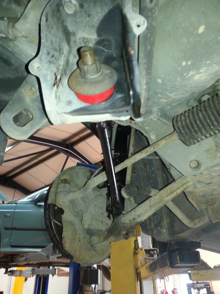

Finished at half 5 and brought the car in, due to no ramps had to struggle on the 4 poster. Changed
N.s.r top mount
n.s inner c.v boot
Both rear hubs
wired in the abs sensors which had been chopped
new rear bottom ball joints
new rear pads and discs
Thanks to tcb for sorting all the bits i needed to do it all yesterday, finished at 10 o clock my misses was NOT impressed lol but means the list to do is shrinking rapidly
