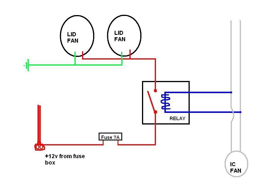

So did you get a chance to make up some wiring kits?
How would you wire these in? Im thinking the best way would be to switch a relay off the oem IC fan wires, so the oem engine bay thermostat can be used (or disconnected to run continuously) then take the main High amp live from the Fat power cable in the fuse box, and earth to chassis??
Heres a lil wire diagram i knocked up to explain.

basically similar to the wiring diag that I am supplying you, with the option of a switch in the cabin and them being kicked in with the IC fan.
I am supplying the Relay, in fact its a Relay and Fuse in one unit, keeps things far neater.
I will start emailing over the wiring/fitting instructions tonight.

If anyone wants to get the wiring diag now, it can be downloaded from:
http://www.22817448.net/Images/GTech%20Fan%20Kit.pdf

Soo. with the wiring.. If i use the IC fan wires instead of the cabin switch, will i get the Faulty fan warning light up on my dash?
I dont use the IC fan as i have a BMIC, and disconnecting that fan brings up the warning light. to get rid of it i had to disconnect the fan relay in the boot. I believe it activates the dash warning light when the fan is disconnected or is pulling too much current??
Obv to run the engine lid fans off the IC fan circuit, i will have to re-connect the IC control box..But will it extinguish the warning light!! ???
any ideas?

Once you connect the IC fan and sensor back up, all be it they are the lid fans, that should extinguish your warning light......well thats the theory
