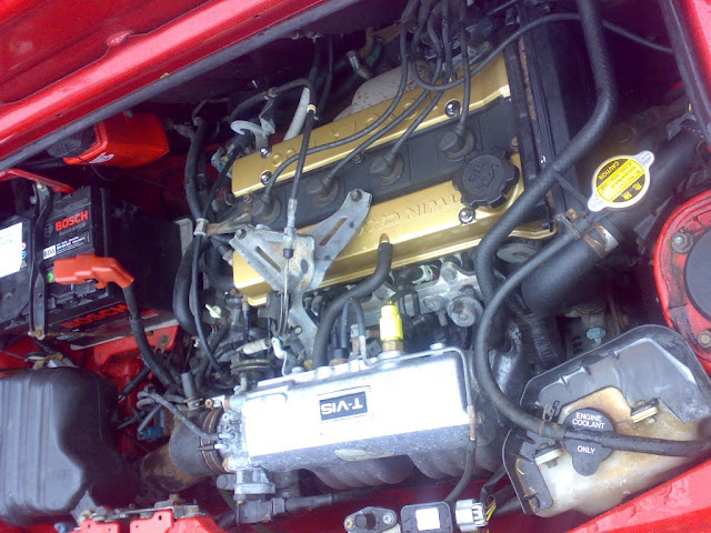

Re: Rocker Cover Colour variations
had mine powder coated in gold
