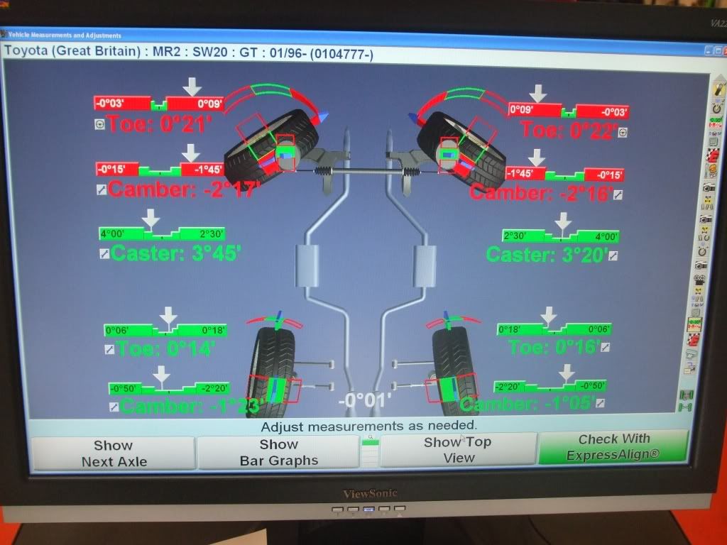

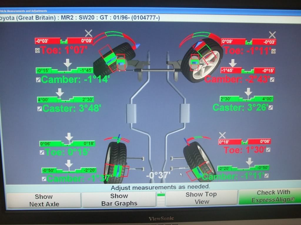

As some of you may know, I have now sold the Formula 27 track car I had and brought a Rev3 Turbo MR2 to track. Over the last month I have been ripping the thing to bits to save as much weight as possible and now pretty much everything that I don’t need is gone. :D
The car has been equipped with a Solaris S6 Ecu and since starting to map the car I have noticed that it has not handled as well as my every day Mr2. Checked over all the suspension parts and serviced everything that needed doing but was still not 100%.
As I decided everything was tip top on the chassis side of things I decided it was best to get the Geo fully setup. I wanted to find someone who has worked with the MR2 Chassis lots before like CW has on the Supra’s.
After a quick browse of the owners clubs, the company Wheels In Motion became apparent lots. Decided to give them a ring for a chat and see what they had to offer. The chat went well and today I went over to get the geo setup to how I would like it.
Now this is the first time I have ever had the geo setup on any car I own but I must truly say I’m amazed at the difference. The MR2 has a real tendency to under steer lots and as I have removed lots of weight from the front I was wondered it was going to be even worse but after the setup that Tony set it seems to have solved the issue. Now I really need to get back on the track to test and confirm but the difference on the road is well worth the £85+vat I paid to have it set. :thumbs:

Cool, but why 18 minutes difference between camber left to right on the rear after adjustments? :?
Tony.
Posts: 27
Joined: Tue Mar 14, 2006 9:40 pm
Location: Hemel Hempstead
Re: New track toy plus pics from Geo Setup
Post by Tony. »
Turbo-G wrote:Cool, but why 18 minutes difference between camber left to right on the rear after adjustments? :?
The cross camber is a result of the toe correction and the fact this car has limited adjustments... 18' is well within the 30' allowed.
