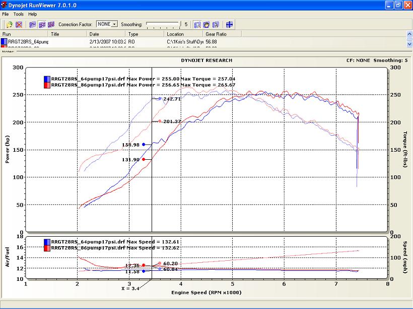

GT3071R is good for over 400fwbhp - looking back at that thread Ryan posted with various power curves, this turbo spools up nearly as quickly as a CT20. There wasn't a curve for a GT28, but if you're more interested in engine response apparantly these spool up very quickly.
http://www.koracing.net/productimages/D ... siPump.jpg
Basically your going to be risking the standard internals if you push toward 350, but many people have no problems.

350 - 370 fwbhp then a gt 2871r would probably be your best option, the gt30 will be slower to spool but will be more future friendly if you ever wan't to take the next step in modifications :-k

saying that i would love to see the two turbo's compared to each other with your mods only ...would be so much easier to decide if you could see there power curves on top of each other :-k
