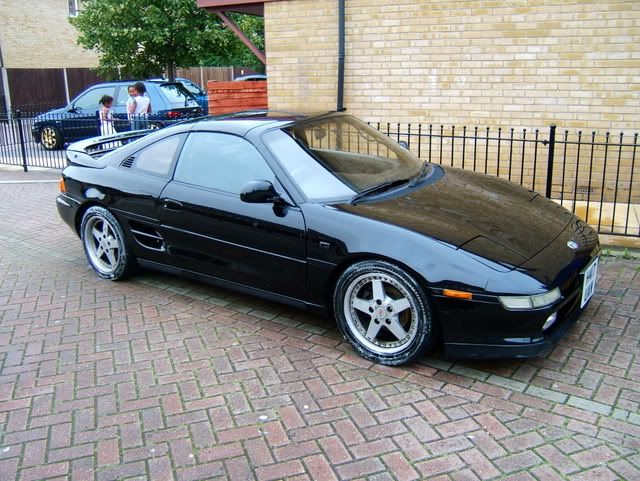

some pics of my recently purchased mr2 n/a.
it's lowered 40mm, aftermarket alloys, aftermarket exhaust, decat, hks induction kit... and apparantly gt4 head/cams.
anyway... pics -
a few questions-
does anybody know what the standard rev limit should be on the 3s-ge lumps?
and i have this 5.5k revs kick where the engine sound/power increases, it seems like vvti, any info?

7k is the rev limit give or take a few. No the 3sge does not have vvti unless you have a very rare BEAMS engine.. it will have BEAMS written on the top of it.. :thumleft:

Looks nice mate, like the red panel at the back :thumleft: Maybe try some polish on the light clusters though to bring them up a bit...?
bass_direct wrote:aftermarket exhaust
Looks very standard to me :-k
bass_direct wrote:and apparantly gt4 head/cams.
Which would explain your kick after 5.5k revs possibly?

I was told by one of the mechanics at Rogue that the intake plenum on the stock 3SGE has a baffle inside which opens up to increase the volume when you put your foot down. This might explain some of the deep "bark" noise you get from the N/A engine at higher revs? As far as I can remember, my old 3SGE power band kicked in about 3,500rpm so sounds like the different cams have increased this.
It's definately not VVT-i as that should kick-in at about 4k unless it's been adjusted. I can't see what the pictures are but Leyroy said it looked standard. You'll know immediately if it has got the VVT-i engine http://www.imoc.co.uk/forums/garage.php ... e&CID=1977.

Don't worry about the 5.5 krpm thing its perfectly normal although mine comes in at about 5, u get a little push and the engine / exhaust note changes. 8)

bass_direct wrote:the exhaust is quite loud (will a decat on standard exhaust do this?)
Yes, although without hearing it its hard to say how loud "quite loud" is :lol:
bass_direct wrote:the previous owner said it's custom but unsure!
It looks exactly like a stock exhaust - pipe size and tappering and twin exit. Nothing wrong with the stock exhaust mate 8)

bass_direct wrote:oh my rev limit is around 7.4k, does this mean aftermarket ecu/chip
More likely due to the cams you have in there...

Your kick at 5300rpm O:) is standard. At the AW11 it is called t-vis i believe and in the SW20 it's ACIS. It's some kind of valve that opens and increases your airflow and gives you an extra kick.
