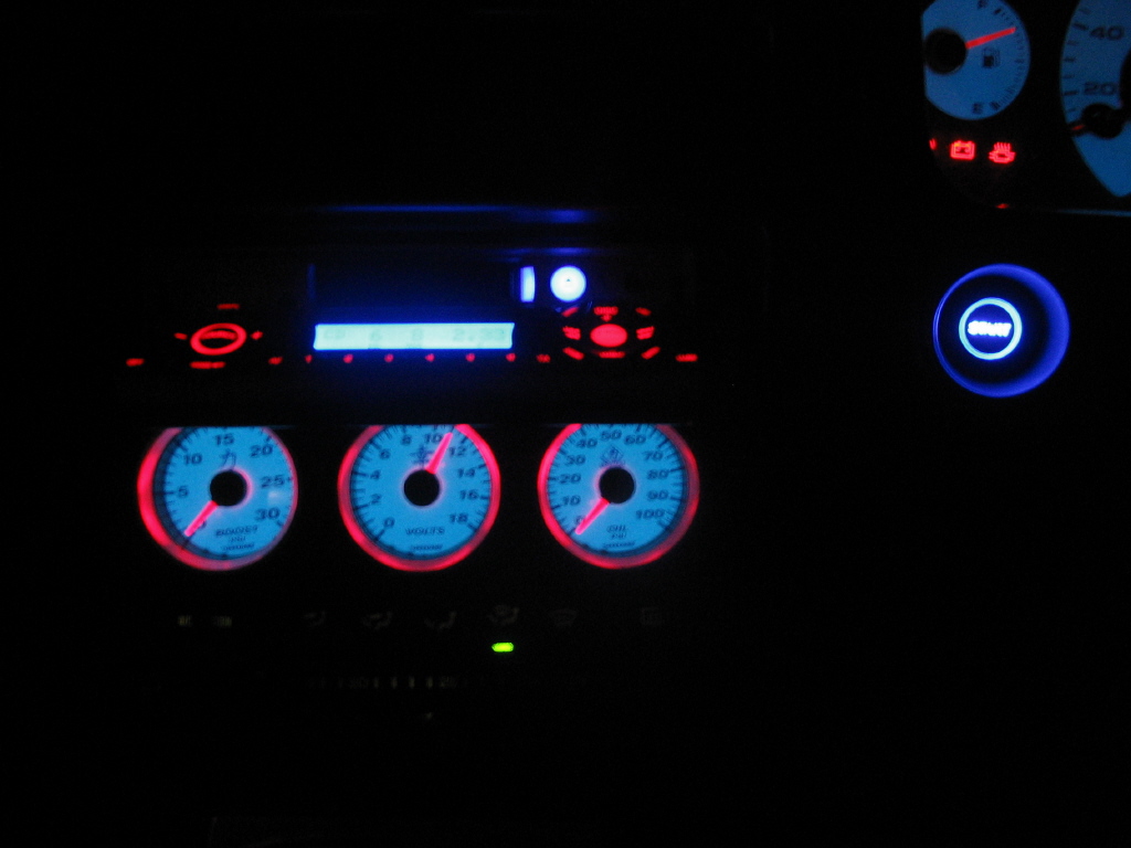

Post by nutter »
I mounted my gauges in the din slot, I initially used a greddy sandwich plate but i couldn't get it to stop leaking, so i removed the old oil pressure switch and stuck my new sender in there. I'm looking for a t piece at the mo so i can re-connect the standard sender (but i keep an eye on my gauge so can moniter any problems from there :

Nutter, that looks really cool.
